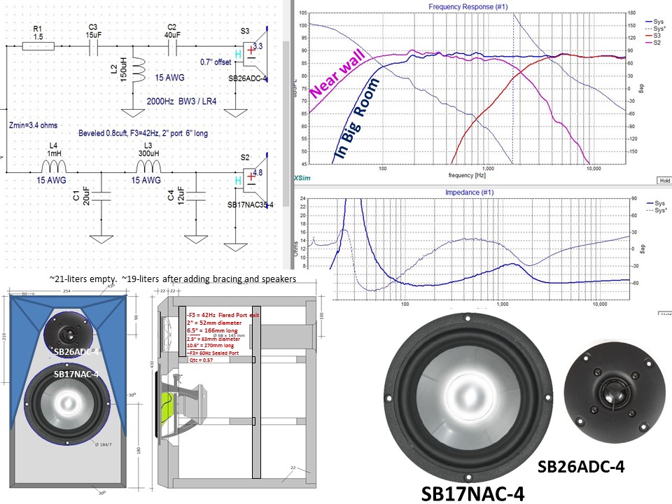

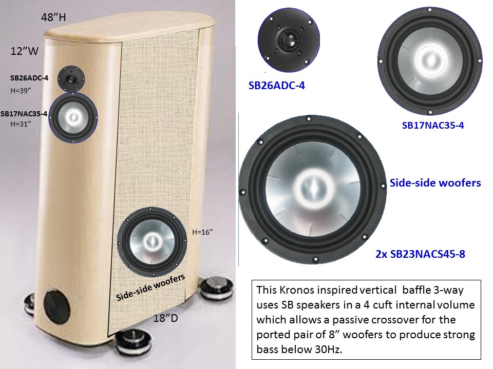

SB_Acoustics has a newer family of medium cost aluminum cone drivers which get positive reviews. Worth the effort to study the published driver data, and read a few diy build threads. The 6.5" midbass has a ribbed aluminum cone which pushes break-up to about 4kHz, and this allows a dynamic and wide vocal range 6.5" midbass with a 1800-2000Hz crossover.
Popular "SPL balanced" combination = 1" dome + sealed 6.5" midbass + two ported 8" woofers in parallel on the front baffle or side-side mounted.
SB_Acoustics Aluminum cones
1" dome SB26ADC-C000-4
5" midrange SB15NAC30-4
6.5" midbass SB17NAC35-4
8" woofer SB23NACS45-8

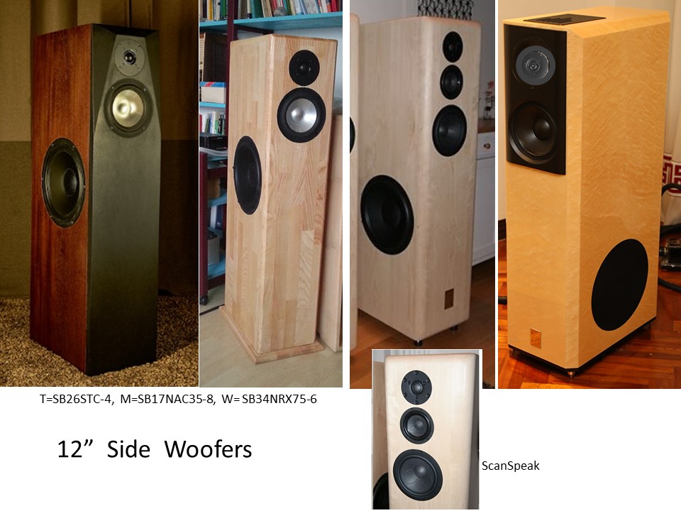

Popular "SPL balanced" combination = 1" dome + sealed 6.5" midbass + sealed 12" woofer
SB34NRX75-6 paper cone 12" woofer with T/S ideal for sealed alignment
3.5cuft sealed produces -F3 ~37Hz with exceptional transients
Side panel mounting allows a narrow front baffle.

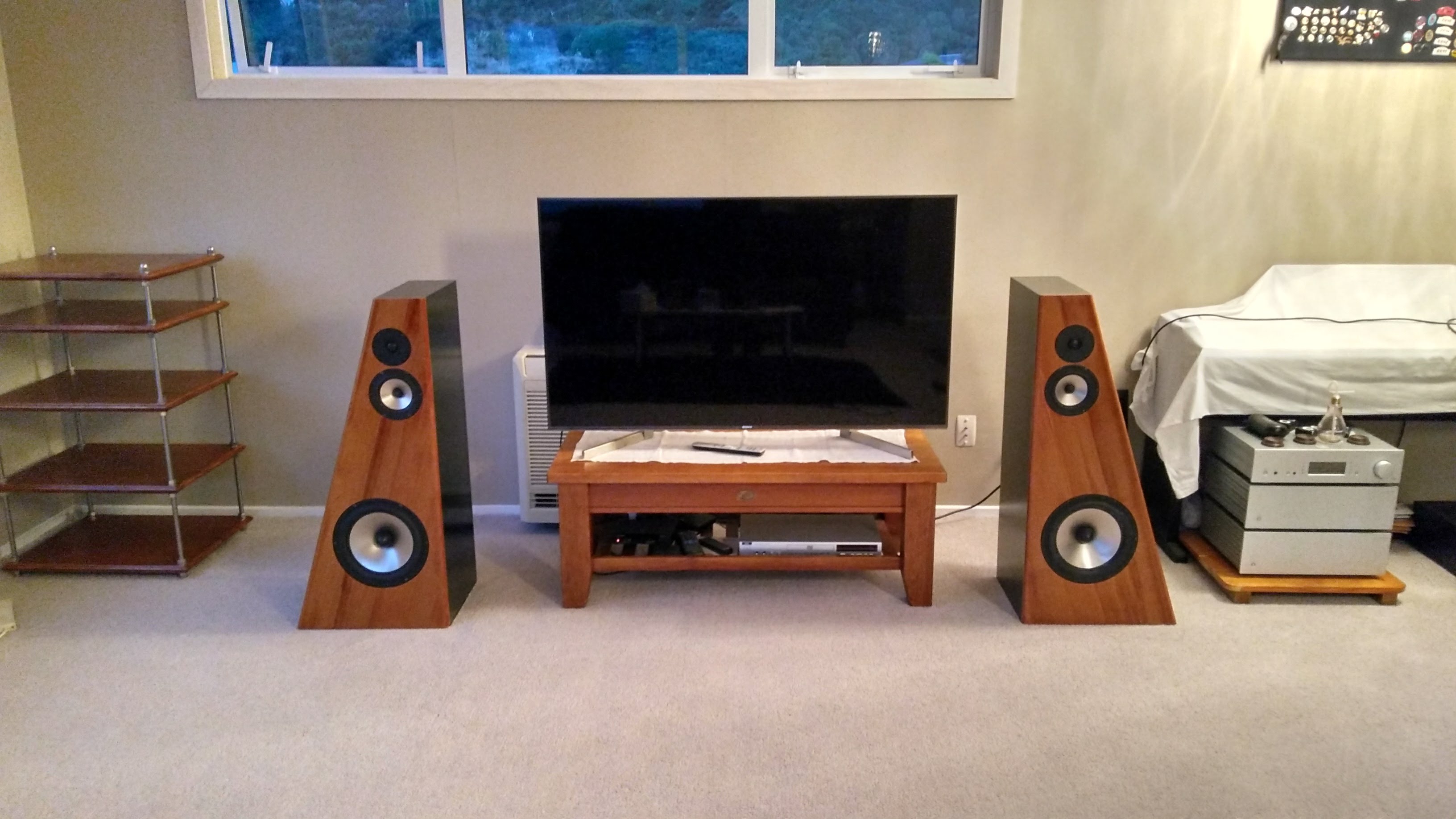

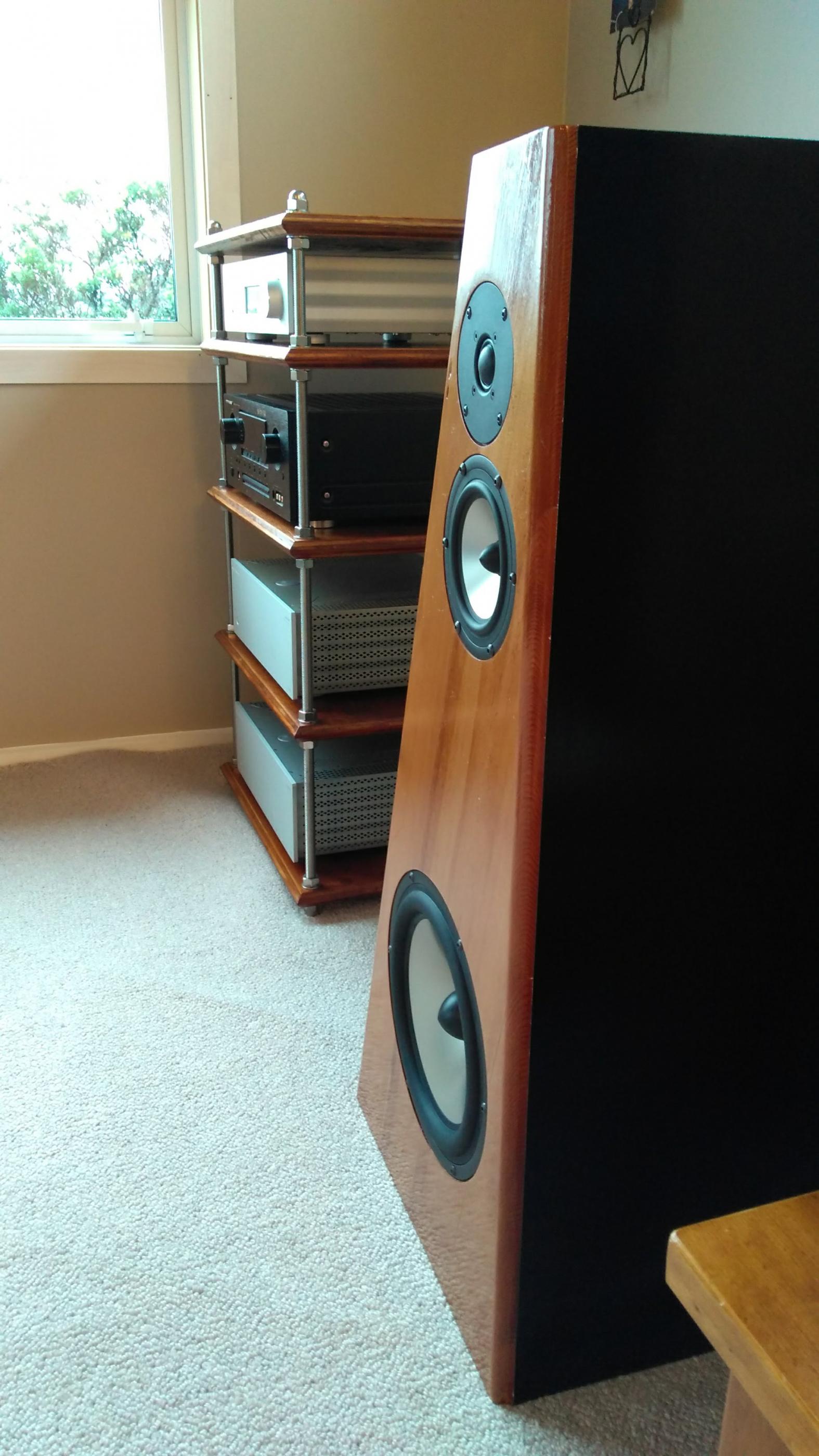

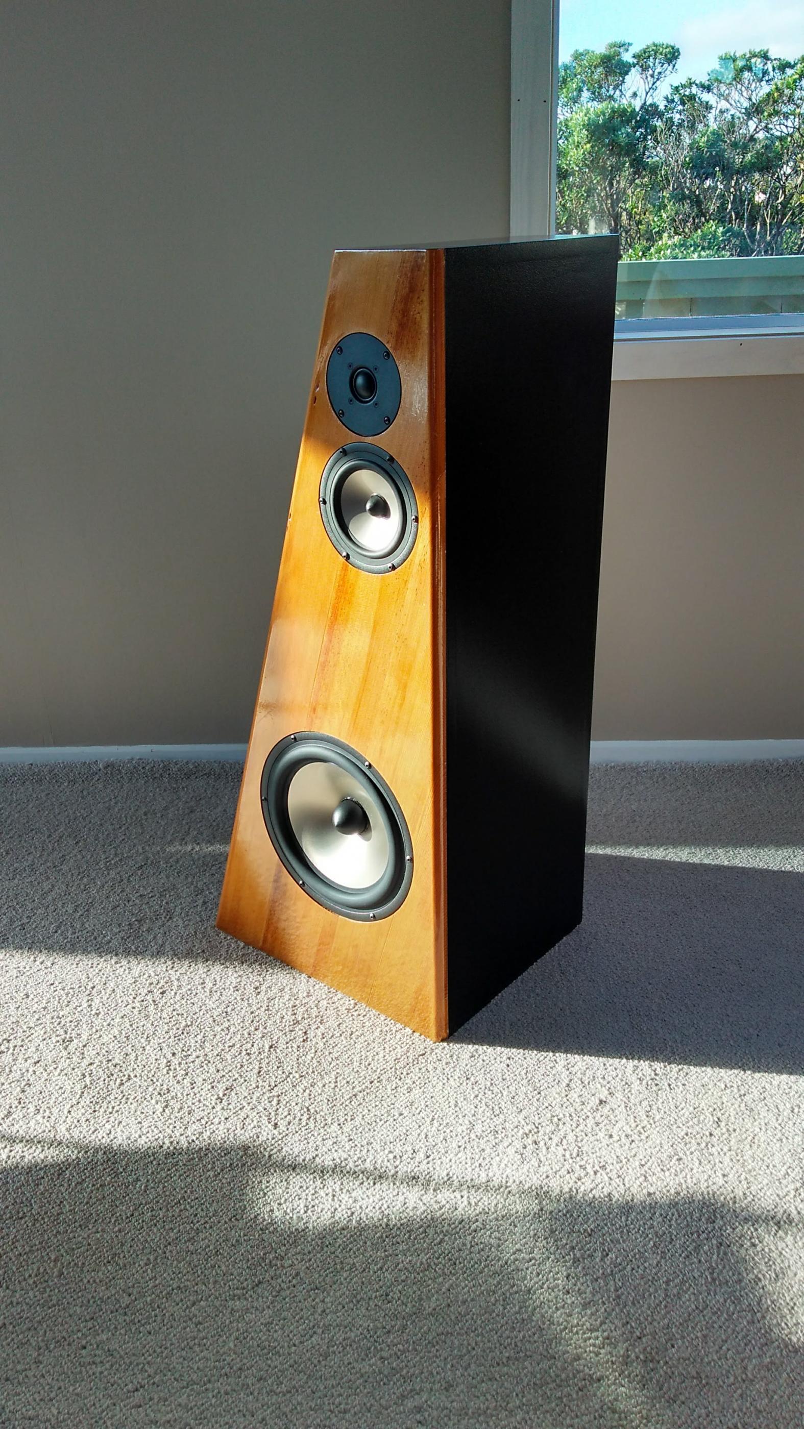

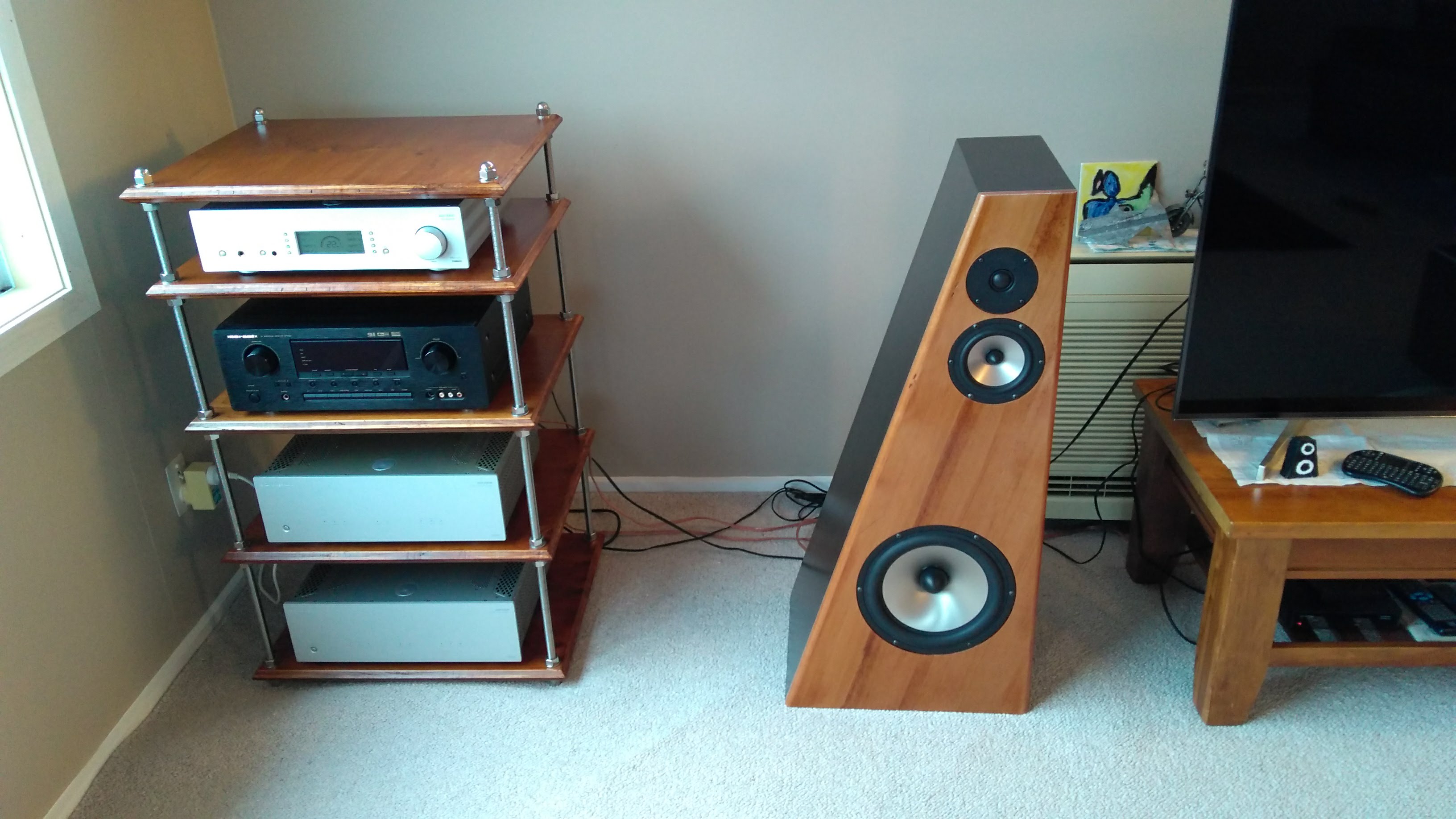

I designed and built a L26/L15/27TBFCG combo. I love the detail of hard / metal drivers. The L15 H3 breakup though hits around 2700Hz and now is inferior to the SB drivers LineSource listed above.
Infact I am in the middle of evaluating an SB34/SB17NBAC/SB26ADC combo exactly as per LineSource above.
I'm happy to share the L26 design with you though.... I didn'tlike the sound of the 27tbfcg pushed below 2300hz and didn't like the L15 playing that high (ideally it would be best 1700Hz), so I compromised with a deliberate "BBC dip". Even with the dip these speakers outshine other paper driver speakers I've listened to for clarity.
PS: I swapped out the 27tbfc/g for the 27tdfc.

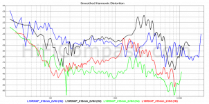

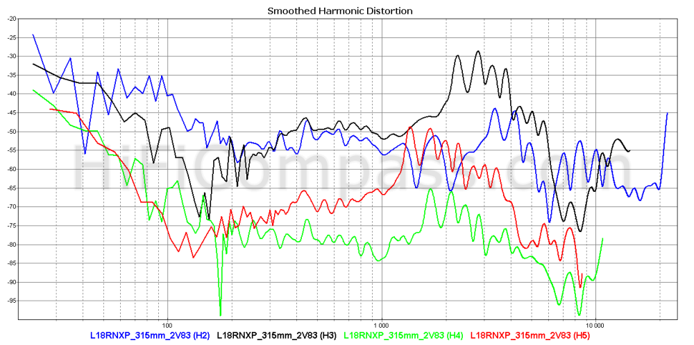

The problem with Zaph's L18 design is he crossed the L18 too high. As you can see in the attached HD sweep - 3rd order is crazy high above 2KHz (7KHz primary breakup / 3). Even Zaph admitted after the design was published he should have crossed lower - maybe as low as 1500Hz (or even lower) to a waveguided tweeter IMHO. Or make this the woofer in a smaller 3 way design.

Thank Dave, I was not aware of it at all. I did the speakers somewhere in 2009 and it put me off totaly from metal speakers. They had fantastic air btw. +15dB is a lot. MAybe that was the reason, I do not know now.
I have the L15 which has the same distortion profile but higher in frequency. Crossing the L15 over at 2300 is what I am doing now, but only tolerable. The problem is I don't like the seas tweeter crossed over any lower. Maybe the tweeter just needed more padding, but the tweeter always seemed shouty and sounded strained at volume (the L26 and L15 can take a lot). In anycase the L15 and 27txFC range dont' seem to work for me either. On brilliant recordings - they are sublime. But I need my speakers to work well on everything I can throw at them ideally.
That's why the SB line - especially SB17BNAC or SB15NBAC are so appealing. The ribbed cone profile seems to lower and spread the typical breakup peak so the resulting odd order HD is much lower in amplitude. I personally think with the right XO as LineSource has posted (4th order electrical works better here since the HD is broad rather than a spike which would be best treated by bottomless notch filters as per L15/L18), then the NBAC line offers excellent price / performance. I reckon potentially better than the Satori line! I wish I had both to compare.
IMHO, the problem with the Seas metal midwoofers is not only the 3rd HD (although this is the worst) but all the other orders are excited in correlation to the main resonance peak. 5th order is bad too, although it's lower in level compared to 3rd, but it's a higher order one and that's the reason it's maybe audible in between 1-2 kHz. All the orders of harmonic distortions can be a sign of very bad intermodulation distortion too.
