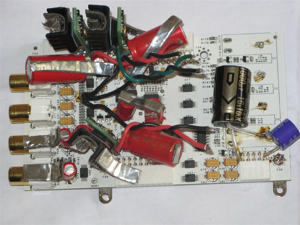

pump and VREG capacitor
Just replaced with BlackGate N on my audio-widget for PUMP and VREG capacitor first, then +/- supply bypass, sounds pretty good, less harsh and quieter background (using USB power now). ES9023 3.3V is regulated by ADP-151.
Any recommendation over sync/async clock is appreciated.
Just replaced with BlackGate N on my audio-widget for PUMP and VREG capacitor first, then +/- supply bypass <SNIP>
What values for which locations?
TIA!

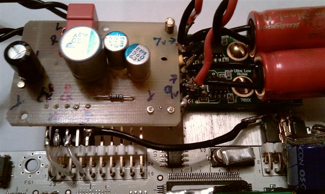

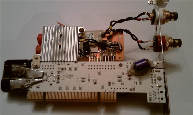

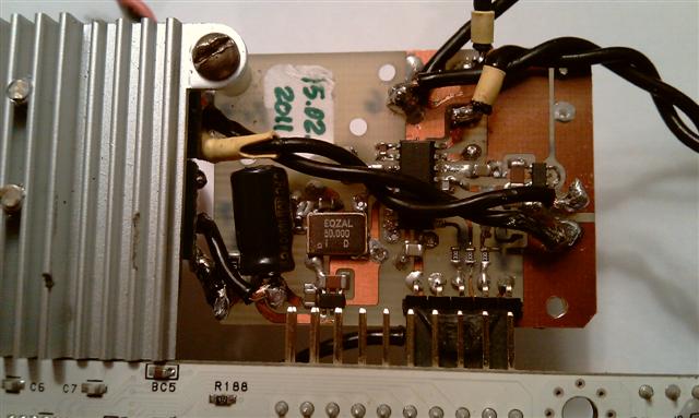

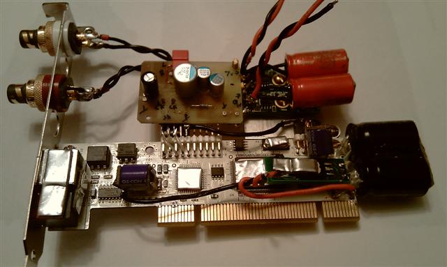

I spent some time over the last week or so getting installing one of Patrick's ES9022 cards into my digital source, with final installation this morning. I'm using a computer playback system based on the cMP formula, but with extensive power supply upgrades (ALL supplies are fully linear including the one powering the computer motherboard).
The digital output is via an ESI Juli@ PCI sound card, which has separate digital and analog sections. By removing the analog section, you have access to the I2S lines and can easily connect them to a DAC. In the past, I've mounted other custom DAC cards on Juli@ digital sections including several variations based on the AK4397 & AK4399 DACs along with a Twisted Pear Buffalo32 that I setup for a friend (based on that experience, I have a TP Buffalo-II here waiting for me to find time to implement it).
I modified the Juli@ a bit by upgrading the power supply lines (increased local filter caps plus upgrading the 3.3v regulator that powers most of the digital chips to a Dexa regulator). I also cut the +5v & +/- 12v power feeds on the PCI connector of the card and feed it from separate linear supplies instead of the motherboard power.
The combo of Patrick's card and my modified Juli@ sounded pretty good right away. Now both the sound card and the ES9022 card have run all day and are improving as they warm up and break-in. Sound is now very respectable... definitely in the same region as the highly-tweaked AK4399-based DAC card w/high-current high-speed video buffer output stage that was perched on a Juli@ digital section before... and not far from the Buffalo32.
Attached are a few pictures of the ES9022 card mounted on the Juli@. Patrick's ES9022 card needs a 9v and a 6v input and I feed it from a couple of Dexa as pre-regulators (The raw DC I used for the AK4399 card and it's output stage were +/- 19v & +12v and I needed to knock them down before feeding them to Patrick's board).
I'm pretty impressed and Patrick's card is a great value. Looking over his implementation, I see very few things I might want to upgrade... Mostly I'm interested in trying higher-test regulators to bypass the on-card 1763's. I'll go either with Dexa or small Salas-ish shunts mounted very close to the card & feeding just past the existing regulator outputs. I also may try different output filter caps... maybe AMTRANS boutique-types. Other than that, I'll likely leave it alone... not sure I can otherwise improve on he'd wrought.
I am talking with Patrick on getting a 2nd card to try in Synch mode. The Juli@ digital section has two clocks, 22.5792 MHz (used for 44.1 & it's multiples-sampling rates) and 24.576 MHz (used for 48 & it's multiples). I generally upsample in the computer to 192, so a 49.152 Mhz clock divided down to 24.576 MHz should theoretically work well.
I'll post updates when I get around to either the regulator or synch-mode upgrades.

P.S. Massimo, I forgot to say 'THANKS!' for the link. That post answered my questions entirely... and I may try upgrading those caps after doing my regulator upgrades.
P.P.S. I also forgot to say that powering the Juli@ separate from the motherboard power and upgrading the on-board regulators made a very significant difference in sound quality when I did that a couple of years ago. The AK4358 DAC on the analog section did very well and it took a couple of iterations of my AK4397/AK4399 implementations to truly best it. I suspect that bypassing the mixing and output stages on the analog section might allow it to keep pace with the newer DACs in most areas of performance... that's a 'someday when I get time' project.

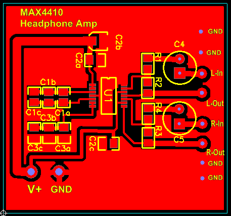

MAX4410 Headphone Amp for ES9022/23
Hello,
I made a ES9022/23 prototype with WM8804 receiver a while ago. I posted the pictures of the PCB in the forum earlier.
I wanted to have a simple headphone amp for it and decided to give a try with MAX4410, mainly because it can run on +3.3v which kind of simplified the power requirements.
Its a small board of size 1.4 x 1.4 inches. I used the reference schematic from MAX4410 datasheet. Its all SMT except for the input capacitors which I did not have any SMTs on hand so went with through the hole parts.
C1x and C3x caps have three 0805 pads to play with different cap values, R1-R4 are 10K, C2x are for power supply filters, C4-C5 are input caps.
Its a single sided board and I etched it at home. I added a ALPS pot between the output of ES9022 and the headphone amp inputs for volume control. Listening to it right now as I am posting this message. Sounds pretty good driving my Audio Technica M50s.
Here is the pic of the PCB.

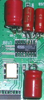

For those interested, I want to share some insight and suggested improvements to the 9022/23 circuit that might be beneficial to others building these.
There is some residual ~1.5 MHz noise from the built in negative supply generator. It is on the order of 125uV in my layout. None of this noise shows up on the output but it can back radiate into other circuits on board so it is a good idea to do the following:
*Power the 9022/23 with its own supply.
*Power the 9022/23 clock oscillator with its own supply, or at least a supply separate from the 9023.
*Connect the XO through a trace directly to the 9023. Don't use a series termination resistor (The 9023 likes a fast rise time in my layout).
*Power the SPDIF receiver/I2S source with its own supply, or at least a supply separate from the 9023.
*Add low impedance bypass caps as close as possible (if not directly across) the AVCC, VREG, and NEG pins to ground.
Patrick suggested additional bulk capacitance on the supplies to the 9023. This is a very good addition. I added it only to the VREG supply as it made the residual noise slightly worse when added to the AVCC and NEG pins. My just be my layout so try it and see what you like.
*Add good polymer bulk capacitance to the VREG near the pin, 100uF to 560uF range is worth trying.
Output noise at zero volts is ~15uV on each channel and the distortion at 1V RMS is <0.005%. Not bad for a 2 dollar chip and around a hundred dollars worth of parts... I added $75 or so for the low noise line supplies and $60 for an enclosure. You could do it with batteries and a plank of wood.
