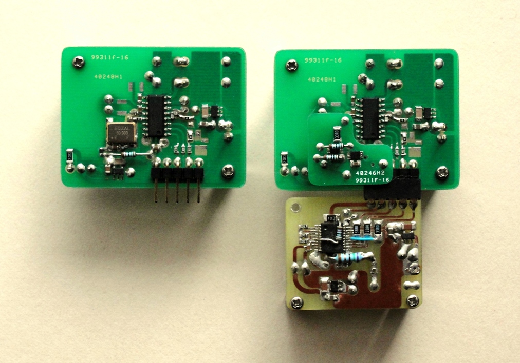

The story of an ESS9022 dac
My digital front end for several years has been a cMP2 computer (please see Computer Asylum) which had a juli@ sound card fitted.
Initially I used the SPDIF output to a Buffalo 32s DAC.....
After a year or so I used the I2S output from the juli@ to a Buffalo II DAC / IVY 3 changing to Buffalo II / Onetics transformers....
Then I decided to try a QLS QA550 Card Player (just out of curiosity) initally going via I2S to the Buffalo II.....
It was at this point that I noticed the talk about the ESS9022 (got there eventually!😀) and I thought I would give it a go - however it was so small that even with the adaptor boards I could not really do anything (mid sixties / failing eyesight etc)....
Enter EUVL, who on a quid pro quo basis made me a balanced dac using the ESS9022 (lucky me!)...
SO I modded the QA550 until I killed it and put the 9022 to one side ....
A few months later I read about all these USB dacs/devices (I know too much time on my hands) in particular the exau2i (USB to I2S converter) being used by some cMP2 / juli@ people...
So goodbye juli@, hello exau2i, feeding in to my Buffalo II / Onetics - quite an improvement but.....
Where did I put that ESS9022 dac? Found and fitted on the outputs of the exau2i - now that is what I call synergy!!!
I cannot believe that such tiny dac chip can produce so much music, it is one of the least digital / most analogue sound I have heard in my system.....
Hmmmmm - thats nice
So thanks to jkeny for posing the question and many, many thanks to EUVL for helping me out.
I know I have cheated (the dac was not DIY it was DI-EUVL) but for people thinking about the ESS9022 (and I assume the 9023) all I can say is give it a go.
As a matter of interest the DAC is two boards each approx 1.75 inches by 1.5 inches.

On the left a standard asynchronous ES9022-50MHz with I2S input.
On the right a WM8804 SPDIF Receiver module, followed by a ES9022-48MHz, with the 1:4 frequency divider which feeds 12MHz to the WM8804 from the same XO as the DAC.
We got tired of etching PCBs, so we have some made for the ES9022.
The next batch of WM8804 will also get factory made PCBs.
Patrick
