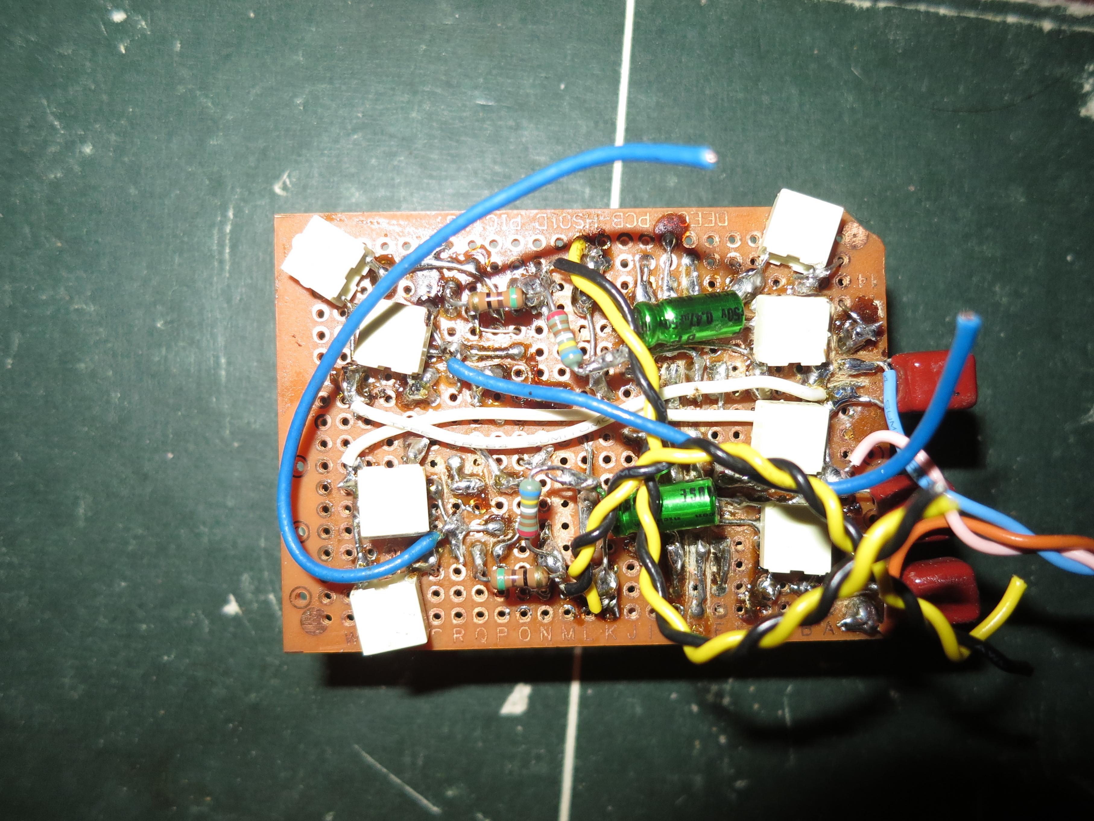

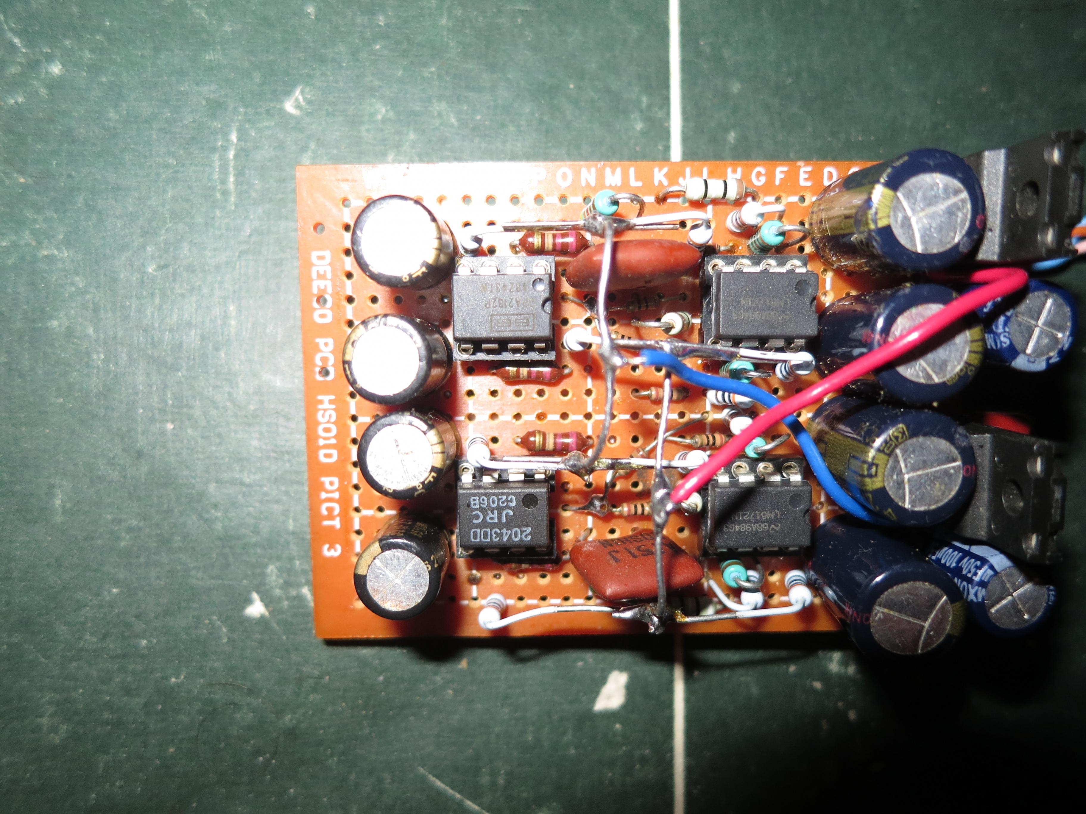

Anybody try this phono preamp ?
The open-loop differential input impedance of an op-amp is basically irrelevant, as it is much increased by the feedback anyway. What does matter (to some extent) are the input noise voltage and current. An LT1115 is a poor choice for moving magnet while an OPA627 or OPA637 is fine because of the high noise current of an LT1115 and the high impedance of a moving magnet cartridge at high audio frequencies.
Very good reminder. Because the AD797 and L1115 are the top choice op-amp in high end moving coil phono stage, people erroneously assume they are also good for MM.
