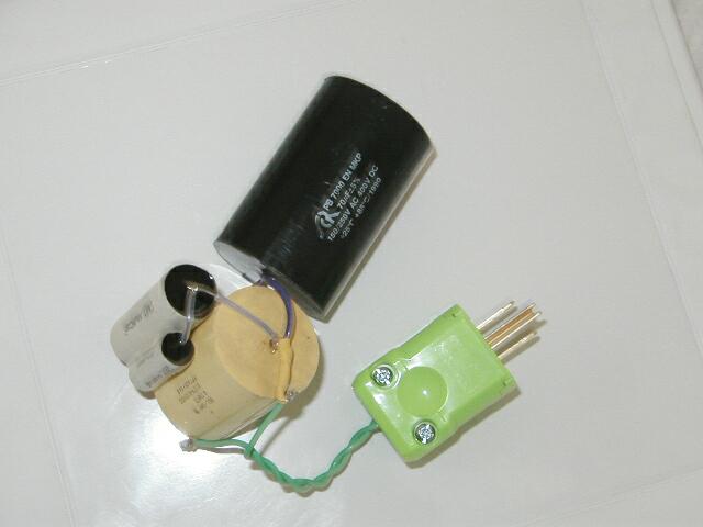

Peter,
All it is a gloriedfied capacitor. Save a lot of money and buy some capacitors from Digi-Key.

I thought it may be a good entry to start power conditioning thread and I knew that Harry couldn't miss opportunity like that.
I need some fresh ideas. So far I ran only 3 dedicated 30A lines to my equipment. Any suggestion how I could utilize the inductor you show in the picture Harry?

P.S. Harry that is an awesome looking power conditioning device.Is it part of the Brittany Spears collection?

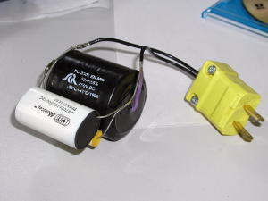

Hi Harry & others
Seen from the power companys point of view it's a great idea to connect capacitors to the net. It will compesate for the fact that almost all the load are inductive (transformers, motors, etc.) and almost none is capacitive. So, bringing the impedance Z nearer to the pure ohmish load will reduce the Ampere in the wires.
Actualy the power company has large capacitor banks placed at the sub stations for the same reason. 😉
And no! Adding more capacitors won't reduce your electrical bill. The meter measures at the R axis anyways, but your wires and fuses will be loaded at the Z. 😀 😀 😀

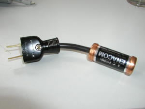

I tried something similar that Harry presented here. It worked OK with A75, however I had to remove it since Aleph5 appeared in a system. Without capacitors the definition of highs is much better and I also achieved better perception of space. Any thoughts?
The device I have shown at the beginning of the thread worked with both amps well though.
