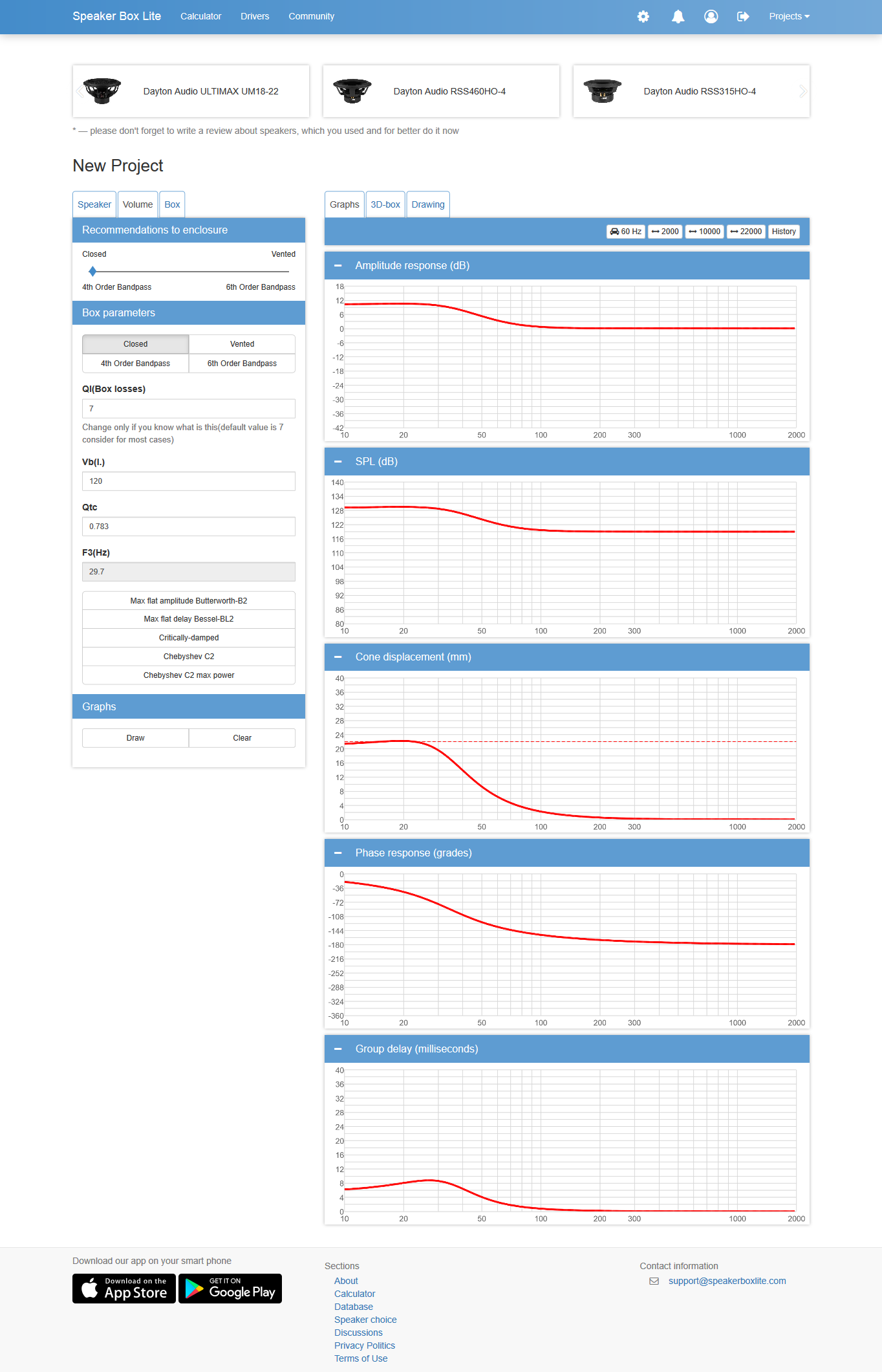

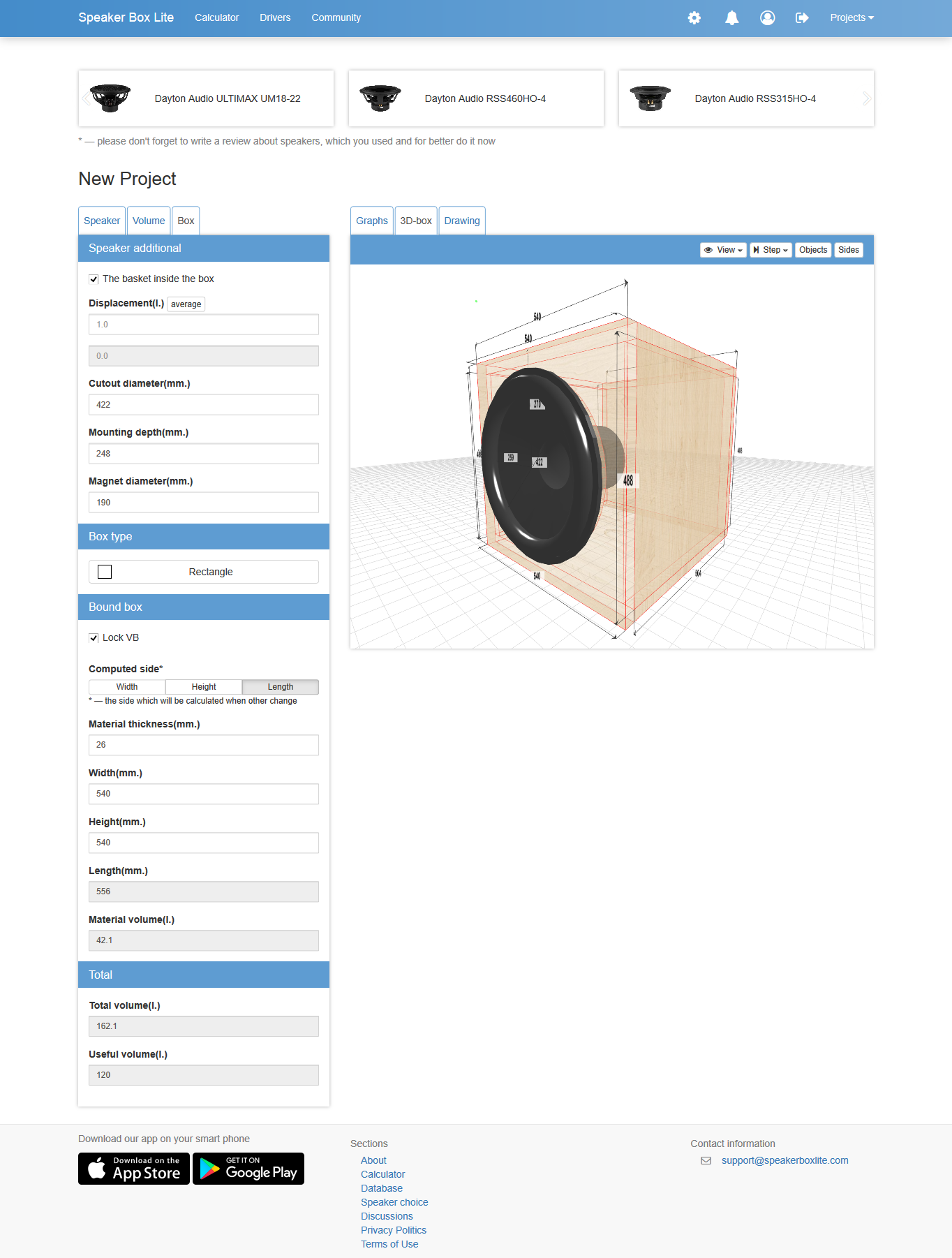

If you play around in Subwoofer box calculator, Sub box calculator you can easily see what sealed vs ported or with sealed what varying volume sizes does. Make sure you keep an eye on Xmax and delay responses. The 3D box design feature is cool and the cut out feature useful.
Your idea of placing both subs at the front in stereo is great for music stereo imaging but bad for even output.
