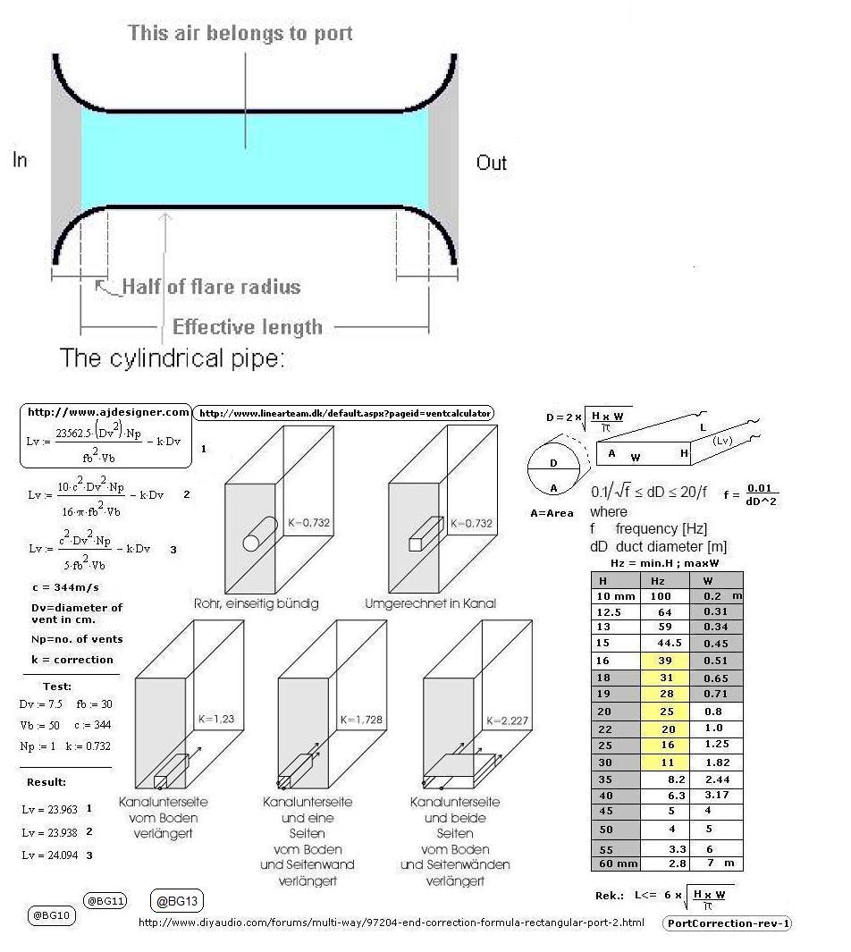

I have bought two Dayton Ultimax 18 inch drivers
Im quite good at building the boxes etc
But need some help on the sizes of the ports and what id expect out of the finished subwoofers in frequency and volume?
I would be building out of 1 inch MDF...many thanks
