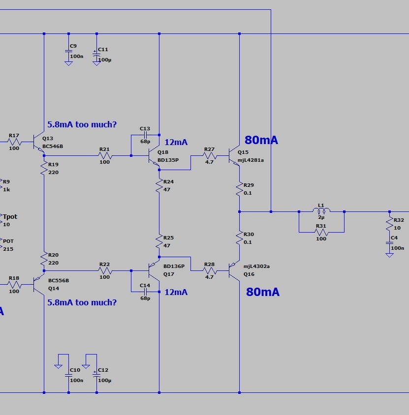

Hello everyone, if you have a little bit of time come take a look at this amp I recently build ( only in simulation so far ) and maybe tell me your toughts, improvements , what you think.
Also attached the .asc, if someone wants to simulate it, also for THD , im not sure I did it correctly.
BD135-136 are gonna be 140/139 in reality.

What exactly do resistors R23 and R26 do? What does the simulation say if you'd omit them?
Best regards!
It is a EF output stage, darlington configuration, and base emitter resistors would " make the darlington nicer" !?.
Im not sure maybe it also makes a close loop gain in the output stage, im not sure. I " inspired " myself from this Pioneer amplifier output stage.

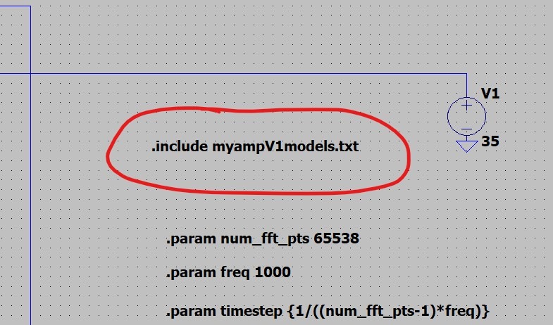

You need to provide a simulation that will click and run and that means including the 3rd party models you have used.
Im not sure how could I share them, maybe like this ?.

Im not really sure what you mean sir. but if it is because I asked for help and did not provide the models of transistors I used, I'm sorry , I did not think not everyone has BC546-556, BD139-140 in their LTSpice, and that even if , they would not mean they are the same models I used. 😊
You should include the models with the .asc in a zip file, or place the models on the schematic, that is best.
Posting it here doesn´t make it run.

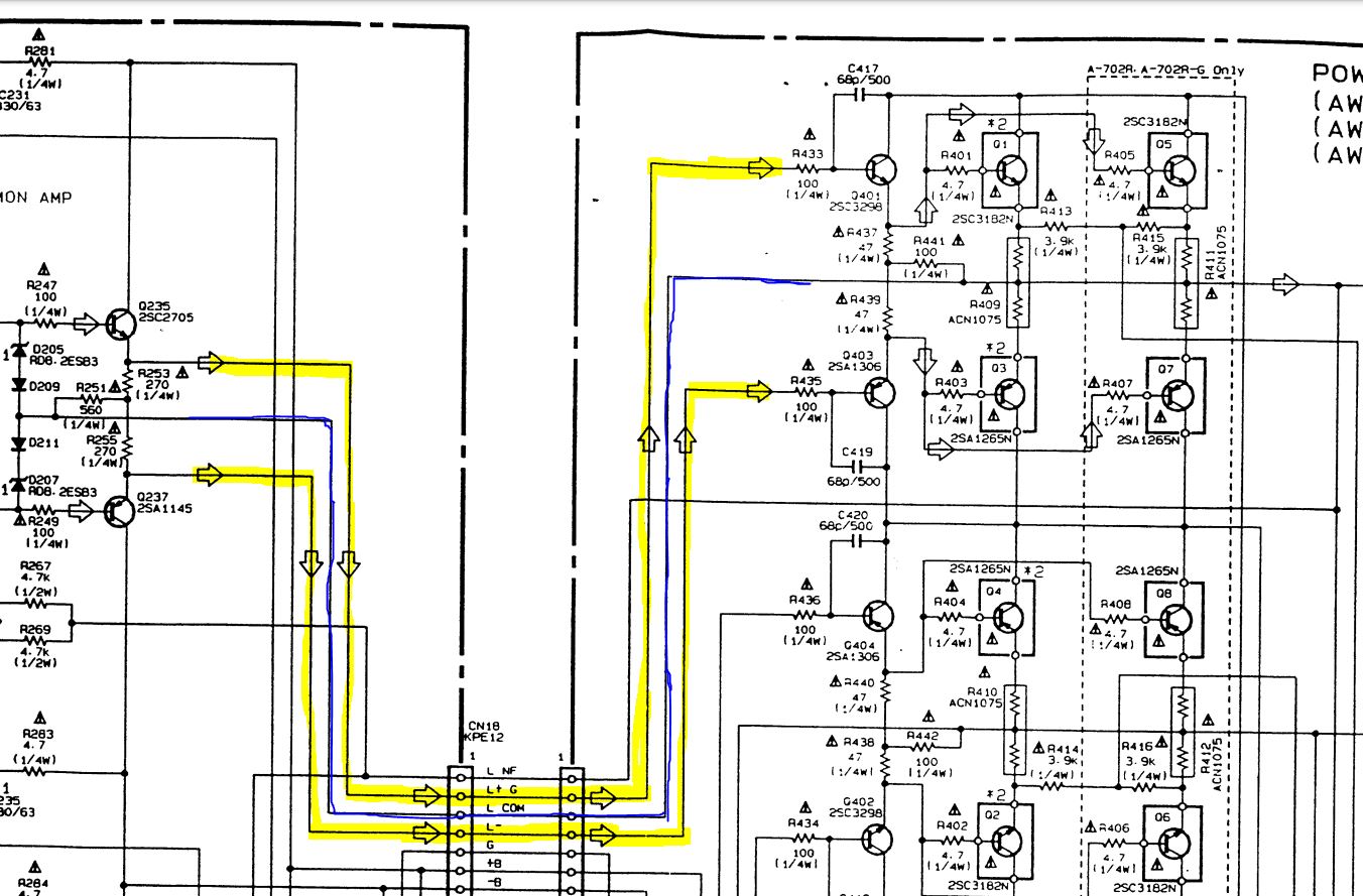

So this is not your design, you used something from someone else and changed it?
If you tell what you changed people may be more willing to reply.

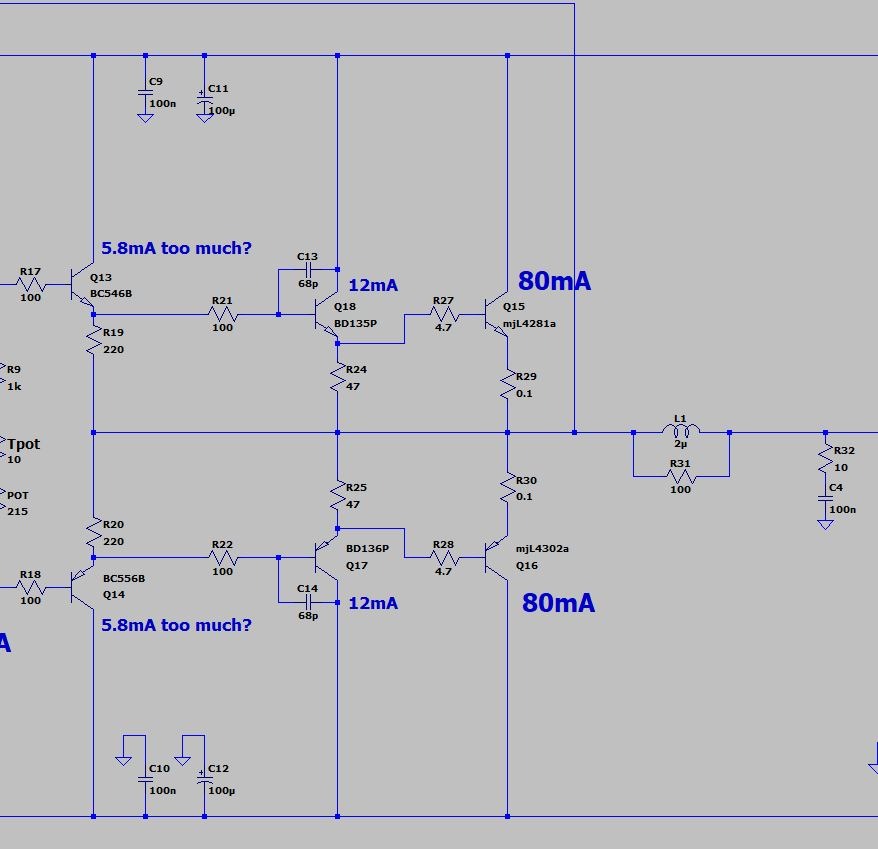

What about R24 and R25 in your latest schem? Why two resistors is series, why not one R?

That was just a reply to Kay Pirinha, tried without the r23 r26.
Yes makes no sense using two resistors , in the schematic you pointed out.
Except for the output stage shown from Pioneer a702r's I used ( emitter follower darlington output stage , nothing special, just with that weird resistors used , hoped someone would tell me why they used it like that . ) apart from that, the "design is mine ".
Started out with the LTP with constant current, current mirror, added EF VAS with constant current, cascode for the LTP , not really sure thats the best way you do it. made an CFP output stage that I didn't like , it oscillated . ended up using the darlington configuration , from Pioneer's amp. if that is copyright in some way , I'll delete it and the post no problem. I did not copy and modify its schematic, just copied its output stage to say so.
"You should include the models with the .asc in a zip file, or place the models on the schematic, that is best." Im not really sure how to do that.
I would check the response to a small current step of the loop Q7-Q9 to see if it rings. If it does, a small capacitor from the base of Q7 to the negative rail, with or without a small series resistor, could fix that.
A decoupling capacitor across the VBE-multiplier could ensure it doesn't affect the stability of the overall loop.
A small change in the output filter could change it into a first-order series filter, as recommended by A. N. Thiele to reduce the sensitivity to RF signals picked up by the cable to the loudspeaker.
R31 = 8.2 ohm
R32 = 0 (short)
C13 = 33 nF
If you haven't done so yet, check start up, what happens during clipping and during recovery from clipping.
The current through Q13 will probably increase enormously during clipping to the negative rail. You could connect a resistor between its collector and ground with a small decoupling capacitor to the negative rail to keep it from going up in smoke.
