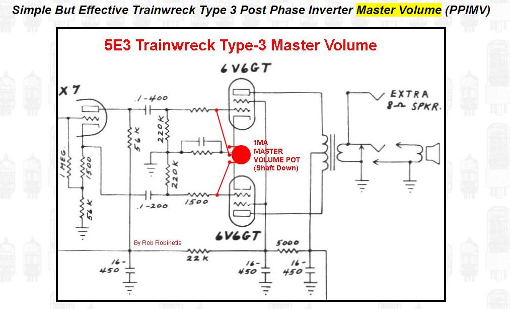

Hey Print - why not add a master volume with a single 1M analog pot? Simple...then you can run the preamp tubes harder than the output tubes.
BTW - I have played with those LND150... they are essentially Solid State 12AX7. I fit them into noval bases and fill with wax...

...why not add a master volume with a single 1M analog pot?

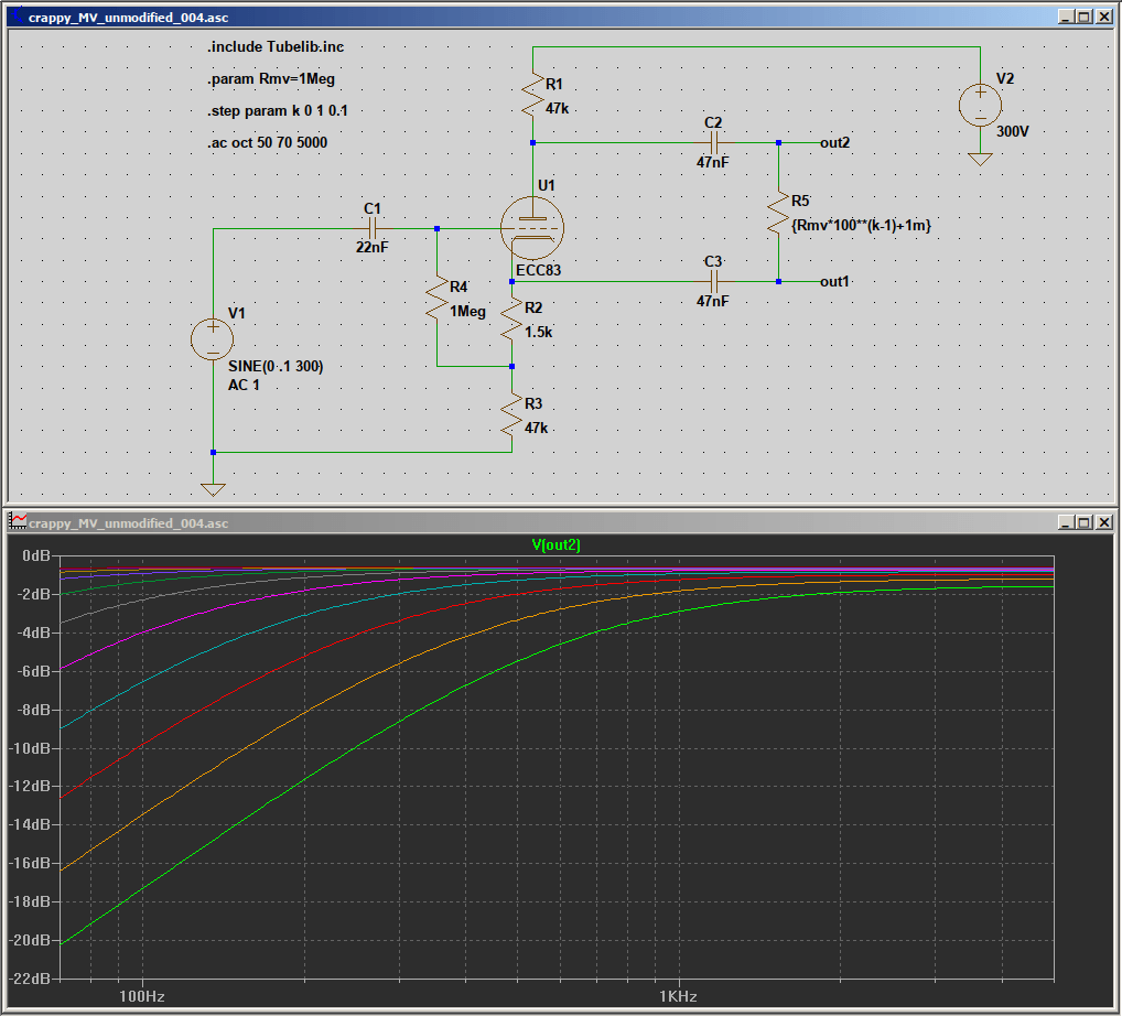

That particular master volume (from Ken Fischer) is a very poor design - it is actually an (accidental) bass cut filter, rather than a master volume. As you turn down the "master volume", bass is dramatically cut, while treble level is almost unaffected.
This is because the two coupling caps from the cathodyne act as high-pass filters with the resistance of the "master volume" pot. As the resistance is reduced, the cutoff frequency is raised, and bass is cut more and more severely.
The attached LTSpice simulation shows what this particular "master volume" actually does. R5 is the 1M pot. As the graphs show, turning the pot has almost no effect at all on frequencies above 2 kHz - all it does is remove all the deep bass.
This is exactly the opposite of what we want, by the way; as SPL is turned down, our ears don't hear bass as well (Fletcher-Munson effect). A good master volume would, if anything, turn up the bass as the overall level is turned down. This particular master volume does the opposite.
The simulation shows 0.047 uF (47 nF) coupling caps from the cathodyne, which is the value I found elsewhere. The circuit John65b posted uses 0.1uF (100 nF) caps. This will have the effect of shifting the curves in the LTSpice simulation to the left by one octave - but it won't fix the major fault in this "design", i.e., it is actually a variable bass cut, and not a master volume at all.
In the circuit John65b posted, this problem can be fixed, very simply, by raising the value of the grid stoppers for the output valves from 1.5k to about 100k each. That will allow the master volume to actually work as a master volume, rather than as a bass cut control.
As a beneficial side effect, 100k grid stoppers reduce blocking distortion and improve overdrive tone.
Worth a mention - input capacitance of EL84s in this type of circuit is in the vicinity of 35 pF. This means 100k grid stoppers won't have any audible effect on guitar treble frequencies, contrary to popular concerns.

...what about the existing 220K resistors before the grid blockers - aren't they going to dominate the high pass behaviour?
They do indeed - until you turn down the master volume pot!
One way to visualize this: there are equal-amplitude antiphase signals at the two ends of the 1M master volume pot. From symmetry, the centre of that resistance must then be at zero volts.
When the pot is at its full 1M resistance, each half is 500k, in parallel with the 220k grid bias resistor. That lowers the effective value of the grid bias resistor to about 153 k.
While a significant reduction, this isn't enough to have any bad effects. The corner frequency of the high-pass filter is still low enough not to be a problem - it's 22 Hz with 47nF coupling caps, i.e. two octaves lower than the lowest frequency (82.4 Hz) you'll get from a guitar in standard tuning.
Now imagine that 1M pot turned down to one-tenth of its end-to-end resistance, i.e. half-rotation on a log pot. This time you have a 50k resistor in parallel with each of the 220k grid bias resistors. Each grid bias resistor is now effectively only 40.7 k, and the high-pass filter kicks in below 83 Hz. This is still not high enough to be a big problem, but the situation starting to become marginal. Master volumes are not supposed to muck with the frequency response, but this one has already introduced 3 dB of bass cut at the low frequency end of a guitar's range.
Now imagine the 1M pot turned down to half of half - i.e. one-quarter of its rotation, at which point its resistance is one-tenth of one-tenth of 1M. That's only 10k. Half of that is only 5k, and this is in parallel with each of the 220k grid bias resistors.
If we pretend the cathodyne has zero output impedance, the high-pass filter corner frequency is now 696 Hz. This is close to the musical note F5 ( https://pages.mtu.edu/~suits/notefreqs.html ), which is the note on the 13th fret of the thinnest guitar string. Every frequency below this has been attenuated!
At this point, it's not just that the deep bass has been removed. Almost the entire guitar signal has been gutted, except for frequencies above 1 kHz or so. All that's left is a very thin sound, like someone listening to a guitar on their mobile phone's built-in speaker.
Not only is this MV an accidental bass-cut filter, it also fails to actually silence the guitar signal - those annoying screechy high frequencies above 1 kHz will still get through at full volume, even with the MV turned most of the way down to zero!
In practice the cathodyne stage does have some output impedance, particularly on the anode side, and since this is in series with the coupling-capacitor reactance, it will eventually staunch the bleeding as the MV pot is turned lower and lower. In other words, the frequency-independent cathodyne output impedance will eventually swamp out the reactance of the cathodyne coupling caps, limiting how high the corner frequency of the accidental high-pass filter can go. It will never get as high as, say, 7000 Hz.
But as the LTSpice simulation shows, the damage is done long before this this small second-order effect kicks in. As-designed, the guitar signal is gutted when you turn the MV down below one-quarter of its rotation (this is for the usual log or "audio" pot, with the usual 10% taper).

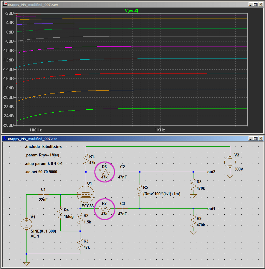

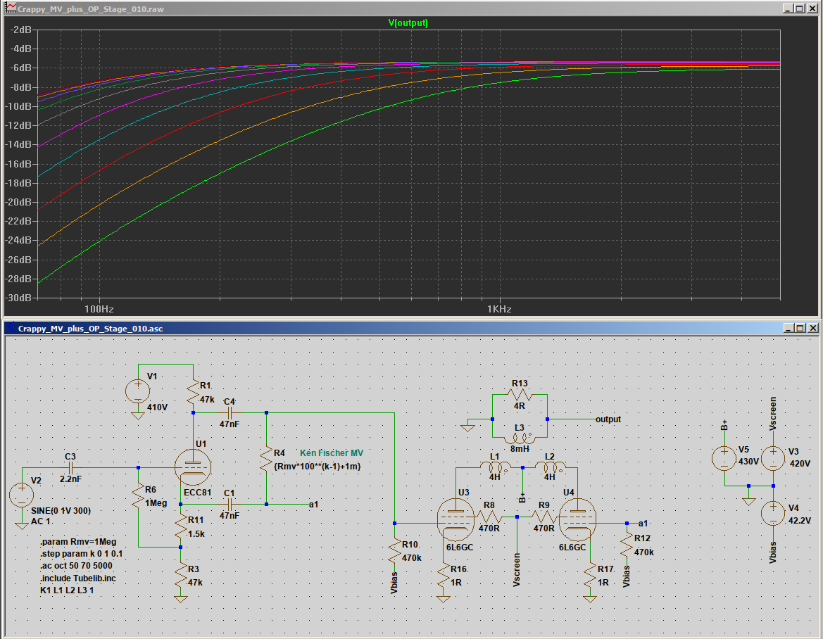

The way the cathodyne output impedance limits the damage suggests a simple and easy fix. Artificially raising the output impedance of the cathodyne with a series resistor in each output signal will do the trick (see second attached image).
Instead of a variable high-pass filter, we now have more or less flat frequency response across, with the overall level dropping as the MV is turned down. In other words, we now actually have a master volume, rather than a variable bass cut filter!
The simplest way to raise the cathodyne output impedance is simply to wire the MV pot directly across the output (control) grids, as in the image John65b posted, and then raise the value of the 1.5k output-valve grid stoppers to somewhere in the 47k - 100k range.
