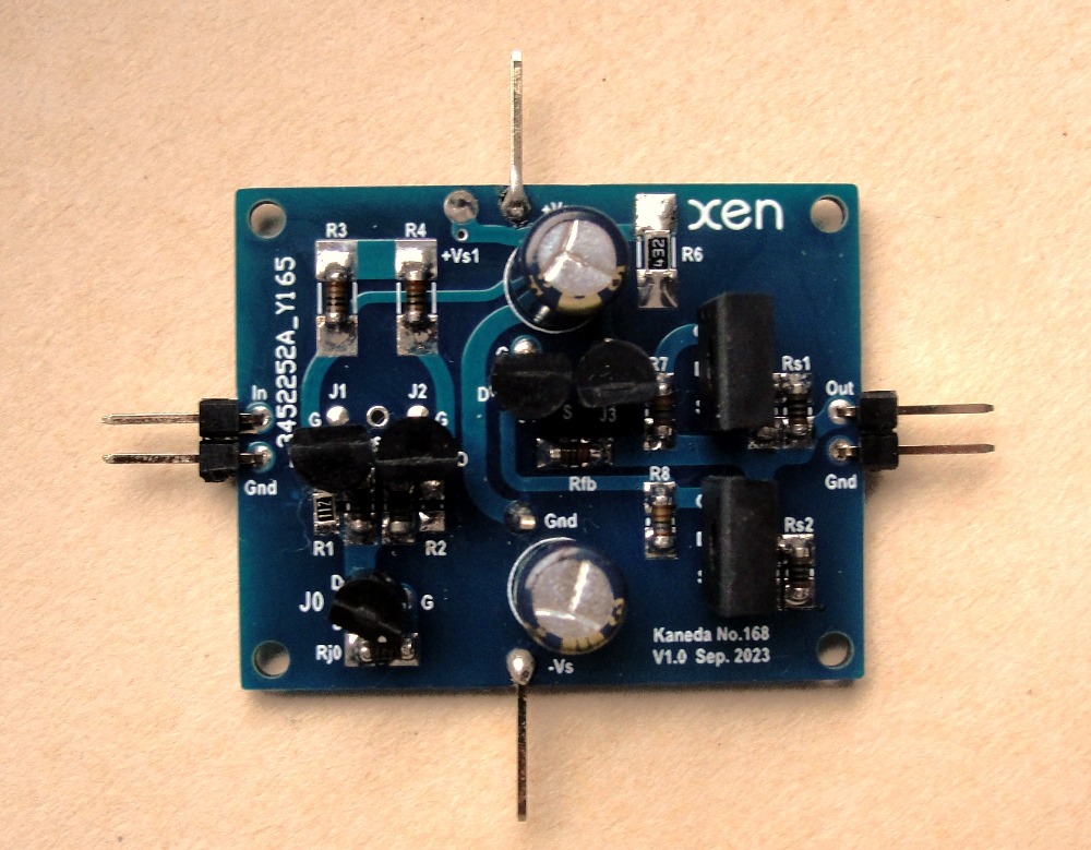

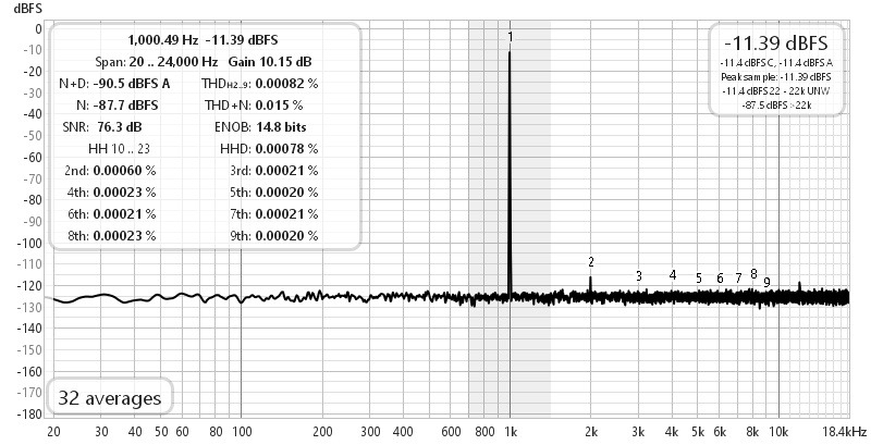

Out of curiosity, I built the No.168 line amp mentioned above to see how it performs.
And it exceeds my expectations. 🙂
Patrick

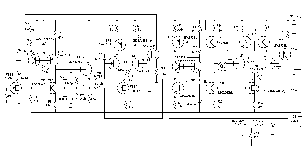

For a long time I have been interested in building some of Kaneda's circuits. It is not easy, unless travelling to Japan or having a friend there, specially if building true to the tradition. Lots of attention to details and parts, not to speak of the hard to find matched transistors.
Patrick, is the No 168 the only circuit you have tried? Have you, by chance, tried the (IVC or not) active crossovers?
Patrick, thank you for the link, nice to see those JFET buffer crossovers, I would very much like to try them.
As for Kaneda, I am particularly interested in his more recent amplifiers, all of which are IVC. The ones using the 6P1 are very well spoken of.
