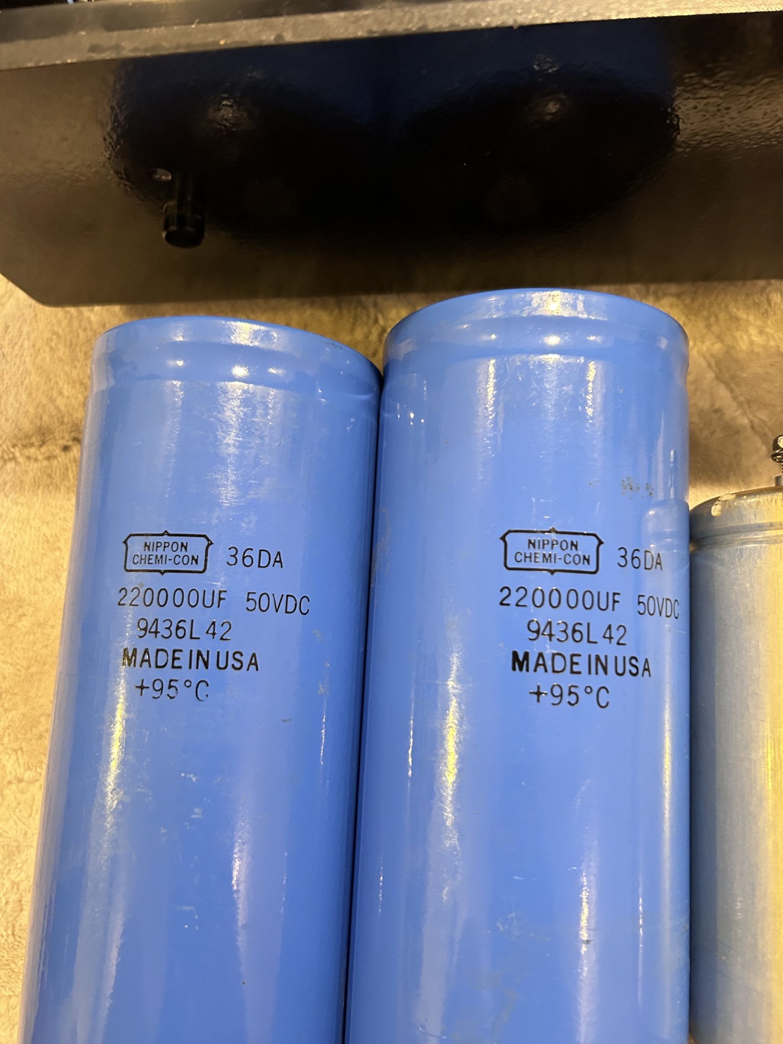

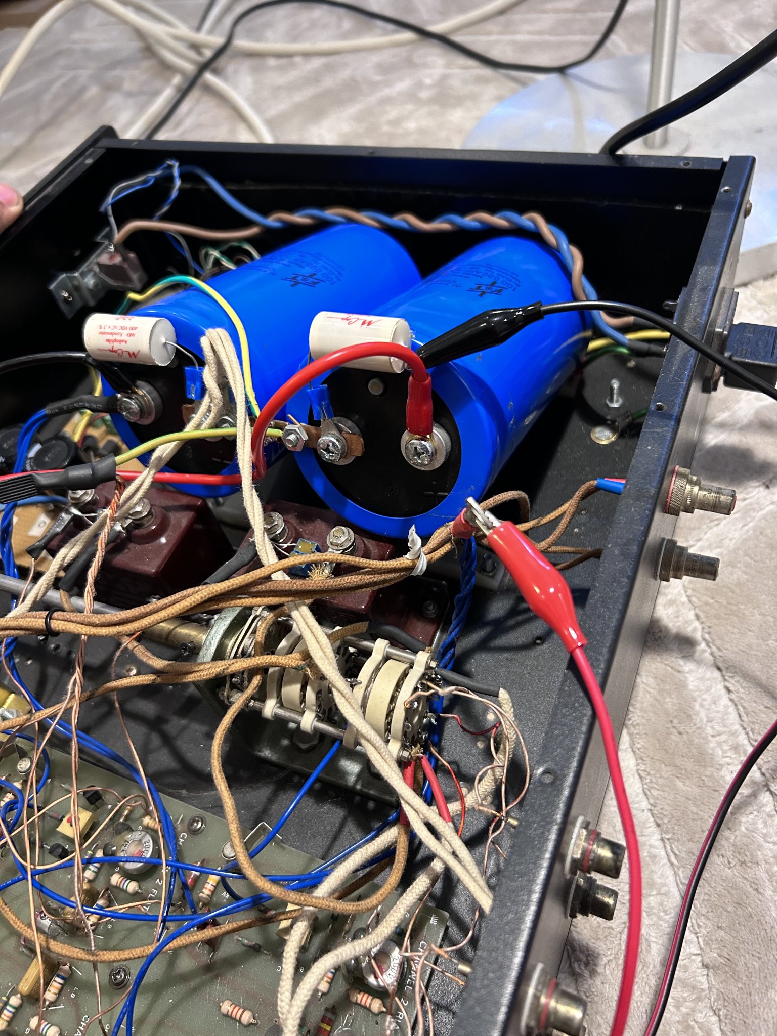

Hello,
I also was wondering why I would have a 230mA and I have found the issue. I have connected the amp meter wrongly, common to voltage. Here is a picture from my phone showing the actual current. 36.70mA which is reasonable and for the other channel it is 36.66mA. This with the 100,000uF /63v caps connected I have removed the 39,000uf I was afraid they will explode.
We can proceed with the 20H and the 40v transformers right?
I am planning to use these big 220,000uf /50v in the next upgrade. I think it will be extremely awkward for a preamp.
And having the website in the mobile is much easier to share pictures.
