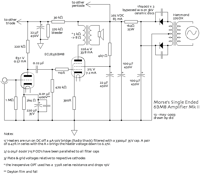

hi morse, sounded preachy? nah, i learn more that way. is this what you did?
Hi ArnoldC;
Nope, it's not the Svetlana schematic. It's the one at http://www.diyaudio.com/forums/attachment.php?s=&postid=170718 with the following changes:
1. There should be another 100uF 450V filter cap after the 820r dropper.
2. The 820r dropper has now been replaced with a 1k2r dropper.
3. The PS trafo is now a Hammond 270DX.
4. The 22uF 450V filter cap after the 820r should be placed after the 4k7r dropper resistor to the screen grid.
5. .01uF 600V 715P OD's have been parallelled to all filter caps.
6. .01uF 400V Dayton film and foils have been parallelled with the cathode caps on the triode section.
7. The heaters are run on DC off a 4A 50V bridge from Radio Shack and filtered with a 3300uF 35V cap. Since the PS upgrade, I've parallelled a pair of .47r in series with the A+ to the heaters to bring the heater voltage down to 6.27V.
The operating values are now:
Raw B+ = 265VDC with .157VAC ripple (measured at second 100uF filter)
Total current draw on HT secondary = 85mA
Total AC ripple as measured at the binding posts to the speakers = less than .001V (inaudible with 89dB speakers).
Pentode section
Ip = 33.8mA
Vp (relative to cathode) = 226.4V
IG2 = 7.2mA
VG2 (relative to cathode) = 215V
Triode section
Ip = .57mA
Vp (relative to cathode) = 83.1V (measured at plate)
With the 270DX, I measured 40.7VA (total from all secondary windings) and 55.2VA drawn (measured across the fuse on the primary); obviously the difference is the waste heat. For this reason I would honestly advise the use of at least a Hammond 270EX if not a 270FX.
Hope this is useful for anyone interested in a similar project!

Hi ArnoldC;
No problem; you might want to make a few revisions to better manage heat issues though.
I've not checked the watts of power out on an o-scope to be sure but it should be a little over 3 watts per channel rms at clipping; that fits with all the valve manuals, manufacturer's data, and direct comparison to my 2A3. Bass response is definitely hampered by my use of cheap iron, but with the 125ESE you'll have no problems there....
The biggest single thing to bear in mind in this design is the amount of waste heat generated by two sources - that 1k2r 25W ww dropper resistor dissipates an honest 9 watts of heat and the PS trafo itself is dissipating something like 14.5 watts of heat. My chassis design didn't really manage heat as well as I would have liked, so it's under revision (extra cooling ports, etc). For cooler operation, you could go to a CLC along with a lower voltage PS that has deeper current reserves, or you could just substitute a heftier PS trafo, currentwise. PSUD II is really helpful there!
One personal opinion is that I'd steer clear of Ei's 6BM8/ECL82. If you check the recent thread on the quality of Ei products, you'll see that my most recent Ei 6BM8's were substandard in quality. That's just my personal opinion though. Anyway, there are plenty of NOS RCA 6BM8/ECL82's out there, along with Svetlana's version and they seem fine!
I was doing up an SEP 50C5 and was wondering about the way the screen was wired in the Mk 1. How does this map look for the Mk II (i'm going to crib off Morse -- just found another SE 6BM8 in my parts collection).
dave

Hi Dave;
Thanks for reposting the revised schemo; since I'd missed the mistake with the screen grid in the posted Mark I schemo (it was always wired as it is in the revised schemo), I can tell that proofreading is not a career I should consider at this late stage in my life!! 😉
Yep, if you build the same circuit you'll be happy - I'm listening to mine through the 40-1354's in 10 litre junker cabs and it's gooood. Violins have a 'real' feel to 'em in classical music, and voices in pop music are 'right' - particularly oldies like Louis Armstrong, Frank Sinatra, Fats Domino and Sam Cooke. The sax accompaniment to Fats frankly outshines my 2A3's rendition of it (*sigh* - time to do some revisions on that amp now....maybe pull the cathode follower and go SRPP or to interstage trafos if I can scrounge up a pair cheap).
Also thanks for the corrections to the RS Canada pricing - I'd remembered it wrong! (early senility over here? who knows?).
One small revision (Mark IIb?) was the replacement of the 220kr 1/2w carbon film load resistors on the triode sections with 220kr 1w NTE metal films. It yielded a little more detail at the expense of a tiny bit of warmth. Overall I like the increase in detail, but that's a combination of personal taste and voicing with the other components used.

Hi Morse,
Just a quick question: Eric Barbour's design on the Svetlana page shows the output of his 6bm8 sep as about 1.5 watts out. The datasheets show over 3 watts out in pentode mode.
Svetlana design specifies B+ range--does this explain difference in power out?
Rick
Rick
Hi Rick;
Re: the Svetlana design, I think you are right. If you take a look at the graph of volts vs distortion in the corner of that one, you'll see that they go all the way up to 5Vrms into an 8 ohm load which translates as 3.125 Wrms with a 400V plate.

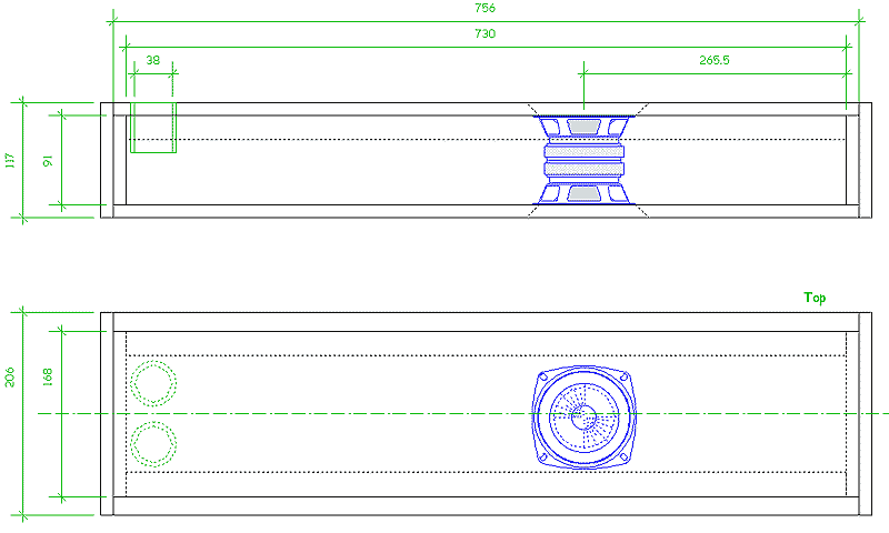

Morse said:through the 40-1354's in 10 litre junker cabs and it's gooood.
My 1354s are still sitting on the shelf... they will be going into a set of bipolar ML-TQWTs. (and i have some more on the way so i can try out a couple other option too)
dave
PS i fixed the Mk 1 map.
Hi Dave;
My Gawd, those are beautiful speakers (drool, drool)! Great workmanship!! I've thought about building a set of T-lines for years (and admired your site - my compliments) but don't have the space for 'em at the moment.
For the future though, do you think that a 2 driver bi-polar TQWT using the RS40-1197 would have any potential? I've managed to track down 9 of 'em since RS USA closed 'em out and I've thought about building a set of 4 of 'em for a HT system I'd like to build; I'd shield the drivers for the centre channel and mount 'em in a midget BR for under the TV use. If necessary I could probably substitute an FE 103 for the front driver in the bi-polar centre channel (should I be unable to find another 1197).

Morse said:My Gawd, those are beautiful speakers (drool, drool)! Great workmanship!! I've thought about building a set of T-lines for years (and admired your site - my compliments) but don't have the space for 'em at the moment.
That is just the 3D computer model. On some thread or othr i posted a pic of some cabs for some PHY 8s -- that is the sort of cosmetics -- we haven't finialized it yet (ie trying to avoid spending the big bucks on materials)
For the future though, do you think that a 2 driver bi-polar TQWT using the RS40-1197 would have any potential? .... If necessary I could probably substitute an FE 103 for the front driver in the bi-polar centre channel (should I be unable to find another 1197).
Chris & I have built quite a few of the BD-Pipes w 1197s -- they are fine (with suitable driver mods). We are now working on a design specifically for the 1197. The 1st iteration are centre channels using coincedent driver magnets for shielding.
The 1197s need a little help above 10k -- an ApexJr 14mm tweeter + 2 uF cap works well (we puesdo horn load them)
dave
PS i have lots of 1197s if you need a single.
Hi Dave;
Wow, those are some terrific looking computer graphics you've generated! I feel really old, being from the pre-graphics 'mainframe computer' and slide rule era.... Anyway, they'll be terrific looking speakers when you build 'em.
Thanks for the data on the 1197 BD's. That's pretty much what I had in mind. Thanks also for the offer of selling an 1197 so I can complete my set for that one; I'll email you on that soon.
By the way, one late mod to the Mark II amp was a cooling fan under the chassis - it did a terrific job of moving heat out from under there, but it was way to noisy. Back to the drawing board on that one. Maybe some kind of baffle arrangement and an internal mounting to let the fan circulate air without being annoying? Hmmmm.
However, one mod that has worked well was the fitting of some .068uF 600V polypro caps I had laying 'round to bypass the decoupling caps to the screen grids. Sounds a tiny bit smoother now, and vocals sound a bit more natural (Less sibilance? I'm not sure - it's a subtle effect).
All the best,
Morse
All the best,
Morse
Morse said:Wow, those are some terrific looking computer graphics you've generated! I feel really old, being from the pre-graphics 'mainframe computer' and slide rule era.... Anyway, they'll be terrific looking speakers when you build 'em.
Hey, i started on mainframes, with punchcards when graphics were carefully layed out arrays of characters. I did get an HP25c 1st year of university and slowly got to put away the slide-rule -- thanx for the complement thou (i was always a drawer and MacPaint & MacDraw got me started on serious 'puter graphics.
The plans and scematics are really quite simple... one of the favorite graphics i've done is this:
(picture deep linked from HD3D Movies)
We have 2 variations of these built already. I just need to add drivers and play with em a bit.
dave
