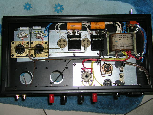

hi,
pls see my laterest version kits
Any suggeestion was welcome.
thanks
thomas
