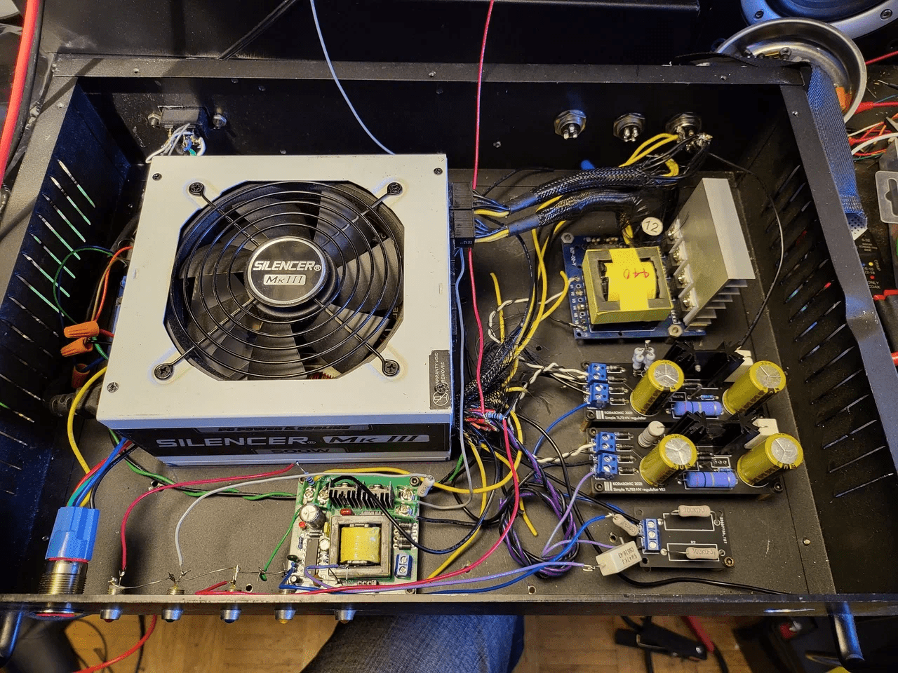

The PSU for my preamp before the final wiring: No discernible noise or RF...
This is after making a few linear powered versions and having hum.

I would like to supply a SE tube amp at 430Vdc 350mA per channel, and the deiver at 235Vdc 10mA per channel plus a variable 380-410Vdc 50mA per channel. The latter could be derivednfrom the former through a pair of buffered LR8.
Can the first 12Vdc be elevated by 80V?
I could supply the heaters of the 12at7 in parallel with two KT88 in parallel directly from it.
Wow, lots of B+ power per channel, what are you planning to build?Impressive!!
This amp: https://www.diyaudio.com/community/...7-shunt-cascoded-and-kt88-in-ul-unset.389721/Wow, lots of B+ power per channel, what are you planning to build?
350mA is the peak value, but not being sure about the reliability of these SMPS at full power, I preferred to communicate peak value.
