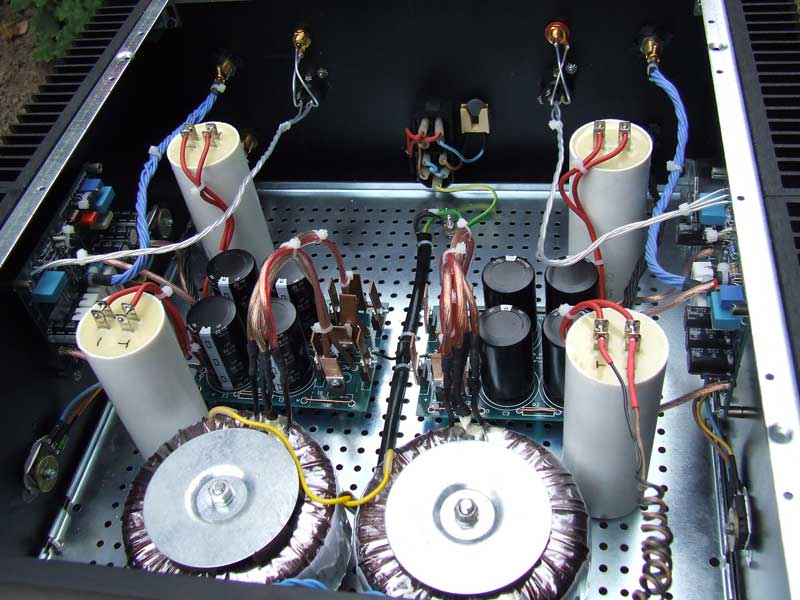

I would say you have never done the Monobloc thing , give it a try , or even better move the power supply away from the flat amp ...
Magura ,
every Magura's amp is monoblock ;
they're simply too heavy , with his approach .
OK, so i guess he is saying there is no difference between "his" stereo amps and his mono blocs , besides weight ? .... 😕
My listening experiences have been the opposite, especially when the transformer is moved away from the flat-amp board and inputs ...
Magura would love to see your approach !
To have the transformer moved away from the amp board and inputs, is a design issue, not mono VS. stereo.
As Choky pointed out, there are many other variables, but for a class A amp, with reasonably constant current draw, the difference in real life, is a point of diminishing returns. I have actually made one amp in both mono-block and stereo version (SE class A), and it made no difference, besides when I had to move it.
You can see some of my stuff at Class-a-labs.com
The rest I'm hiding for non-Serbians 😉

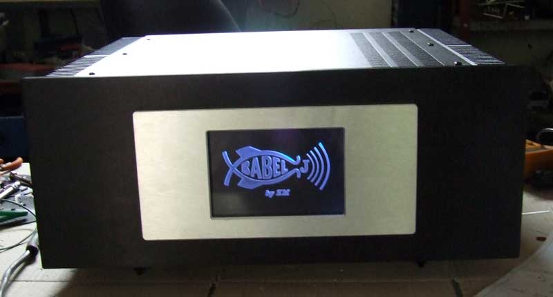

Hello Magura,
Nice work! I'm considering using chokes in my F5 build but is a little put off on the prices for the chokes. I think the Hammond chokes go for about $30 each. Diy chokes could be an option. Mind sharing the recipe for your chokes? What are the dimension of your chokes, wire gauge, etc...?
Thanks,
David
Is this your amp?
nope ;
that is amp of one Serbian DiYA member ;
he's not skilled in DIY , so I participated in project ;
he purchased and paid for all parts (I told him what and where) - box from HiFi200 , xformers , caps from GB , PSU pcbs from GB , additional front plate from local box guru ( AKA Leonardo on our forum) , where logo is result of collective fun ;
inside work is mine , along with Babelfish pcbs and related small parts
