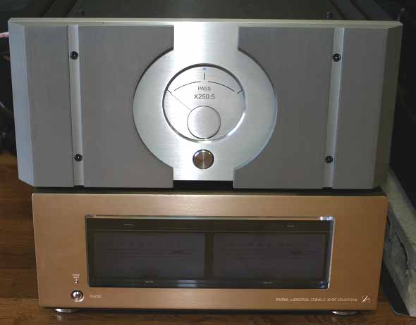

looks like an empty box
Option 2 : can also be the same junk in a bigger box.
Passlabs X250.5-Luxman M-8f
Both 250W, both use a single comparable size 4-wire transformer, comparable price range.
WTFuse, the X250.5 is bigger.
PS : The box is so big because it needs to dump 350W of heat, a minor issue that the competition doesn't have.
(each amp side running on its own set of secondary transformer windings/rectifier bridge/smoothing capacitors is also considered dual mono)
