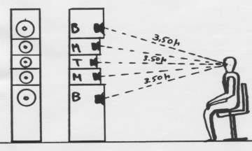

my diy ideas
As i want to built a hi-end project in a BMTMB Dapollito compination i want to choose great drivers
Midbass: scanspeak 15w/8530k00 or 18w/8531g00 # peerless hds 134 or 182 # vifa p17wj or xt18wh09-08
Tweeter:dynaudio esotar 330 #scanspeak d2905/70000 #vifa xt25
Bass:8" driver most probably from the same company of the choosen midbass driver
MY GOAL is to built a reference loudspeaker using:
-separate cabin for each driver
-every driver has the same distance fron the listener in aparticular point
-external xo
-very strong built cabins, maybe fron concrete
I LIKE TO HEAR THE OPINION OF THE EXPERTS
