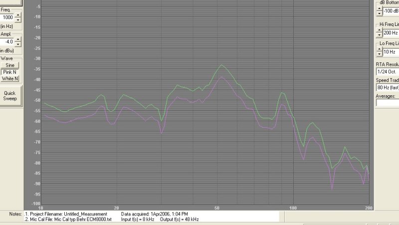

Here's a plot of my corner loaded tempests, with an 80Hz low pass filter. The plot shows 1 playing versus both playing. They are placed directly next to each other. Each driver has its own amp.
I cannot see any change in the response - Shows the 6dB increase that using 2 drivers gives, if the power is supplied.
Rob.
You don't see the cut-off point moving lower because there is no cut-off!! The horn-like corner loading together with the 12dB/oct room gain are supressing completely the 12dB/oct roll-off from the sealed enclosures.
If you can, repeat the test outdoors with the enclosures placed together and absolutely no walls near (10 meter clearance should be OK), except the own floor of course.
Also, note that gain is becoming *more* than 6dB below 60Hz while it's *less* than 6dB above 60Hz. This suggests a 5dB gain figure due to placing the two enclosures together and a 2dB additional gain figure below 60Hz due to enclosure zeros being shifted to a lower frequency while room poles being the same.
Hi eva,
The tempests have an f-3 of ~35Hz. If using 2 lowered the f-3 then surely you'd notice the top plot change around the 35Hz mark even in room ? According to what you've stated there should be a boost visible between approx 25Hz - 35Hz if the 2 subs had an f3 lowered by 1/2 an octave.
I'm remaking the boxes soon (few weeks) so if the weathers kind I'll do the outside measurements.
The 6dB figure is pretty consistant. The slight +/- 1 could well be to the curve 'rippling' as I don't use the peak hold function, I just pause the rta and save it to memory. (was only a quick measurement)
Rob
Rob
