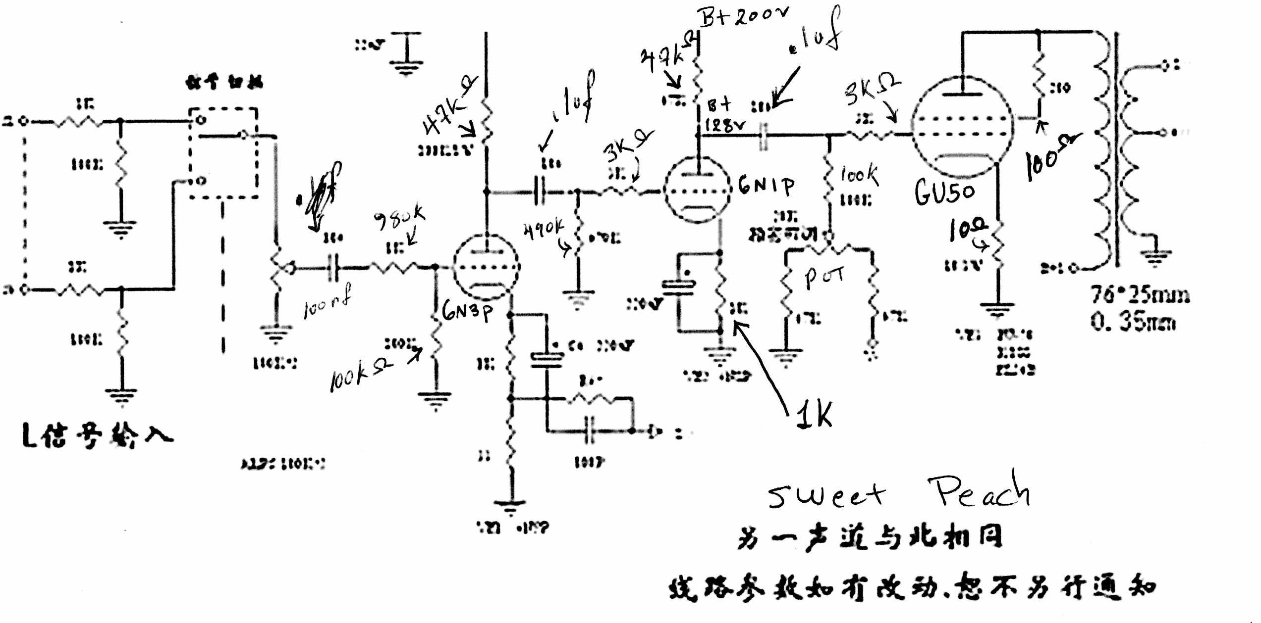

After about a week of listening I feel it is worth replacing the coupling caps(vishay roederstein MKP), series grid stoppers (used Vishay Beyschlag) and swapping the 6n1p for the 6n6p ( performs better with stock plate/anode resistors & B+). Probably not going to change much else with the Peach for a while, the bit of grit and unrefinement that was bugging me before is gone and the amp is now an absolute pleasure to listen to.

I'm a little new to tube design - could you post of the definitive Peach schematic of your amp? What values did you use for the coupling caps and the stopper resistors? Can the 6n6p just plug straight in?

I will also replace the 0,1uF coupling caps, I do not trust them since there are chinese copies of the Wima caps out there, and the quality is a real questionmark.
I will also change the plate resistors in mine, since they differ too much, over 1k!
However I will stick to the original (3k) gridstoppers, maybe change them later since I already have a whole shoppingbag of beyshlag reisistors.

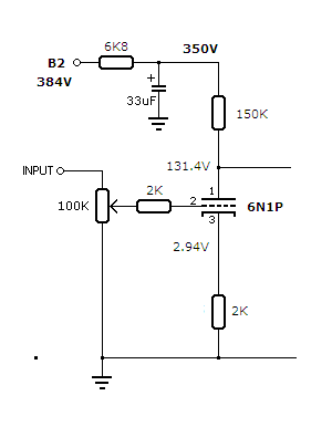

If the Sweet Peach schematic is correct the original 6N1P runs with an anode resistor of 47k dropping (200-128) = 1.53mA.
So the 1k cathode resistor is therefore at 1.53V bias, which is a little low, and could be substituted for a red LED (1.7V) and a smaller resistor for the anode?
However I want to substitute that for an ECC88 which I can run at 2mA if I use a 4V cathode to grid voltage (Two orange leds) with a 36K anode resistor [disclaimer - I'm new to load lines!!]. What do you think?
The original circuit uses 47k anode (plate) resistors.
I am using a 6n23p which is equivalent to the ecc88. I have not made any changes as of yet and it sounds pretty good.
