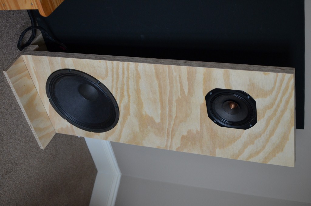

I have made the baffle as suggested by are sreten, just one sheet of ply so far. It sound very promising, the midrange has returned!
I have adjustment left for both gain and crossover frequency on the plate amps too.
Next step is to add the second ply sheet and stand.
I mounted the beta 15 3" from the bottom edge of the baffle, I couldn't wait for an answer, had to seize the moment 🙂

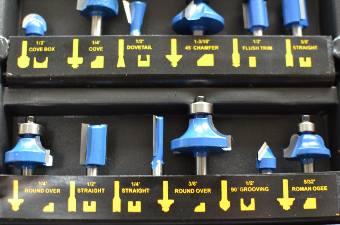

I bought a router and bits, which one would be the most suitable. I am thinking the 45 degree, would be the easiest to make over two baffle, I think?
Would flush mounting make much difference?
And a pic of the temporary setup.

I bought a router and bits, which one would be the most suitable. I am thinking the 45 degree ... ?
Flush mounting the woofer isn't necessary at all. I even question the need to chamfer the hole on the rear.
Chamfering and flush mounting would be basically helpful for the AN8, but flush mounting will be difficult to achieve. Getting the crossovers right certainly makes more of a difference than any work with the router.
What kind of crossover will you apply?
45 degree chamfer the current 8" hole down about halfway / 1cm.
Then for the rear sheet just make the hole ~ 1.5" diameter wider
for the 8". Flush mounting is very pointless for both drivers.

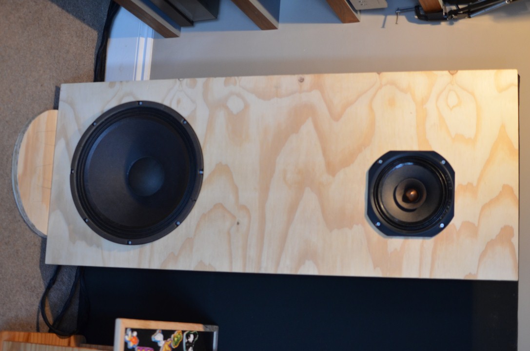

Here is a quick update, In between posts i have been busy.
Before reading your suggestions Sreten, I had already glued the second baffle, 45 degree chamfered both holes for both drivers, mounted them on a base with some 2x2 to add rigidity screwed and glued.
I tried flush mounting on some scrap, I don't have the skills yet, made a mess.
Just couldn't miss the opportunity of having my 18 month old daughter and wife out of the house for the day.
Left to do is,
1 Rubber damp the rear of the baffle, glued with silicon.
2 Cover the front of the baffle with a cosmetically friedney fabric, maybe faux suede. The bitumen sealer would not be acceptable to my wife, the smell too 🙂

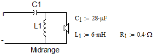

I would like some input on the crossover please?
I see three different strategies:
A fully passive solution. I can post the Xover parts values if interested:
This has a bass boost around 70 Hz which comes free with the filter configuration.
A full active solution that tries (somewhat) to follow the passive one above:
You will need the bass boost of your plate amp to give this any "ummmph" 🙂
And a full active alternative:
Now the Beta is boosted 8 dB entirely. Be aware that this solution will run out of Xmax rather soon.
SPL values are for 10W listened from 3 m distance at 10° off axis to the "short" side of the baffle.

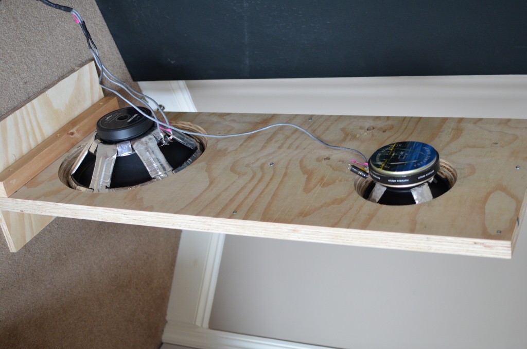

Plus some pics of the progress.

The filters are separate for each driver, yes:
Fullrange driver and woofer are in phase.
This is just a proposal. You can change any value by up to 20%, depending on what you have at home or can get. We would do a new sim when you have sorted it out.
Don't become too demanding with the big coils.They don't need to be air coils. Ferrite or iron core would be fine too.
You don't need any more filters, if frequencies above 2 kHz of the AN had worked for you with your 150 µF highpass. Dipoles don't need BSC. Above filters will achieve the response as shown in the graph.

How much is the cut-out for the AN8 chamfered? Sorry, but that single shot doesn't tell me much about it. Looks like it should be wider.
What will you do to make that tiny baseplate stick to that floor? I believe you don't want spikes. But you probably need something to press the base plate firmer to the ground.

Hello Ian,
I assume that your largest router bit does a 2,5 cm radius. The baffle edge radius must be at least a quarter wavelength to be of any use. This results in 3,4 kHz as the lowest affected frequency. At 3,4 kHz your AN8 is quite directive already. Only a small fraction of the sound will reach the baffle edges. In your case I don't see any acoustic advantage in rounding the edges.
Decoupling the drivers from what? Is your baffle vibrating in itself, or is it rocking as a whole? Don't we need to know the disease before we can talk about the cure? 😉

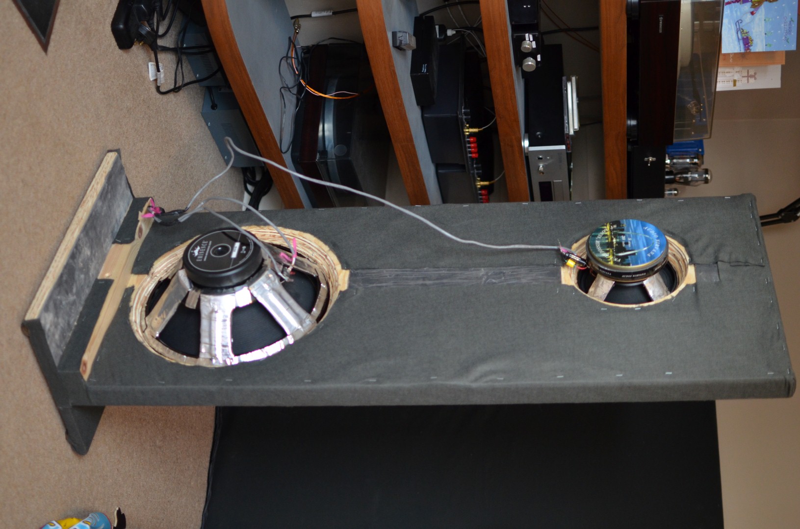

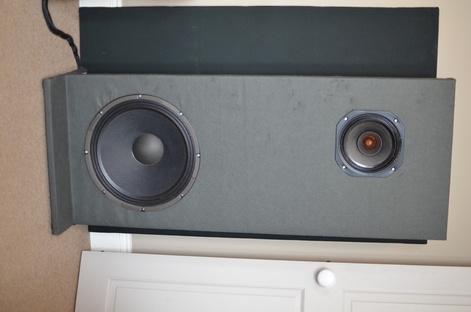

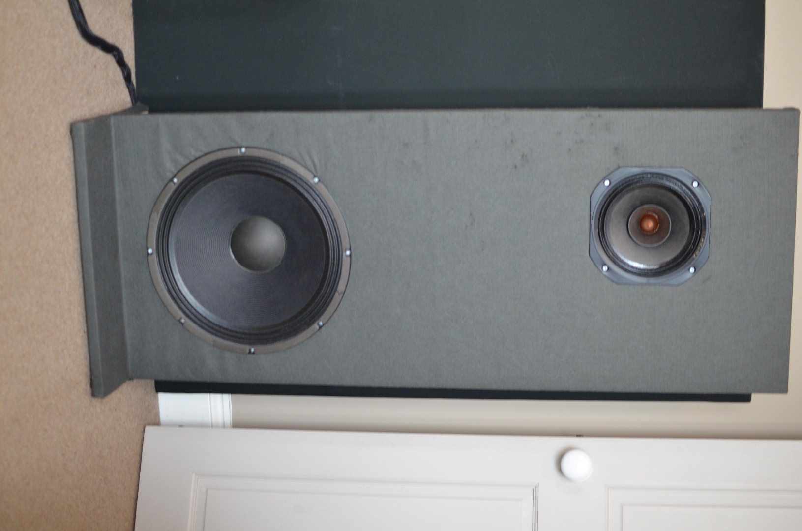

A Little update
Hi All,
I have damped the rear with heavy 8mm rubber sheet, added floor spikes and covered with grey felt. They sound much more detailed and soundstage better. I haven't got hold of the crossover parts yet, next on the list.
Unfortunately, my cats have been using them as scratchers so might have to cover with another material. It looks worse than it is in the photos.
Cheers
Ian
The rear wings Nelson suggested could simply be the depth of the base plate and taper down as they go up to the half way point. They have the added advantage of transferring some vibration from the woofer away from the baffle to the floor and also take some stress off the screws holding the baffle upright. Great job by the way..
