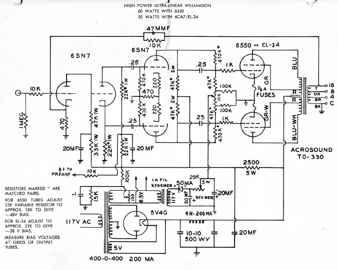

The Toroidy's come with several primary options, 2k, 4k, 5k, 6.6k, and, 8k. Curious why you wouldn't suggest using the the UL taps? I've heard a few people recommend Wiliiamson's circuit's, ElPasoTubeAmps mentions them a lot in his videos (I like his videos). I was thinking about going with their circuit that could be used with either the EL34's for 50 watts or KT88's for 60 watts, I just wasn't sure how to incorporate the CFB winding into the circuit. I'll see if I can attach the diagram.

I said full pentode, not UL, because a 5 K primary is incorrect for KT88s and a "tall" B+ rail is needed as compensation. If UL was tried with that "tall" rail, the screen grids would be subjected to excessive voltage. A 3.3 K primary is what you use with KT88s.
Buy the 6.6 Kohm primary model. Use 6L6GC or 7581A O/P tubes. Now, you can safely use both the UL taps and the CFB winding(s).

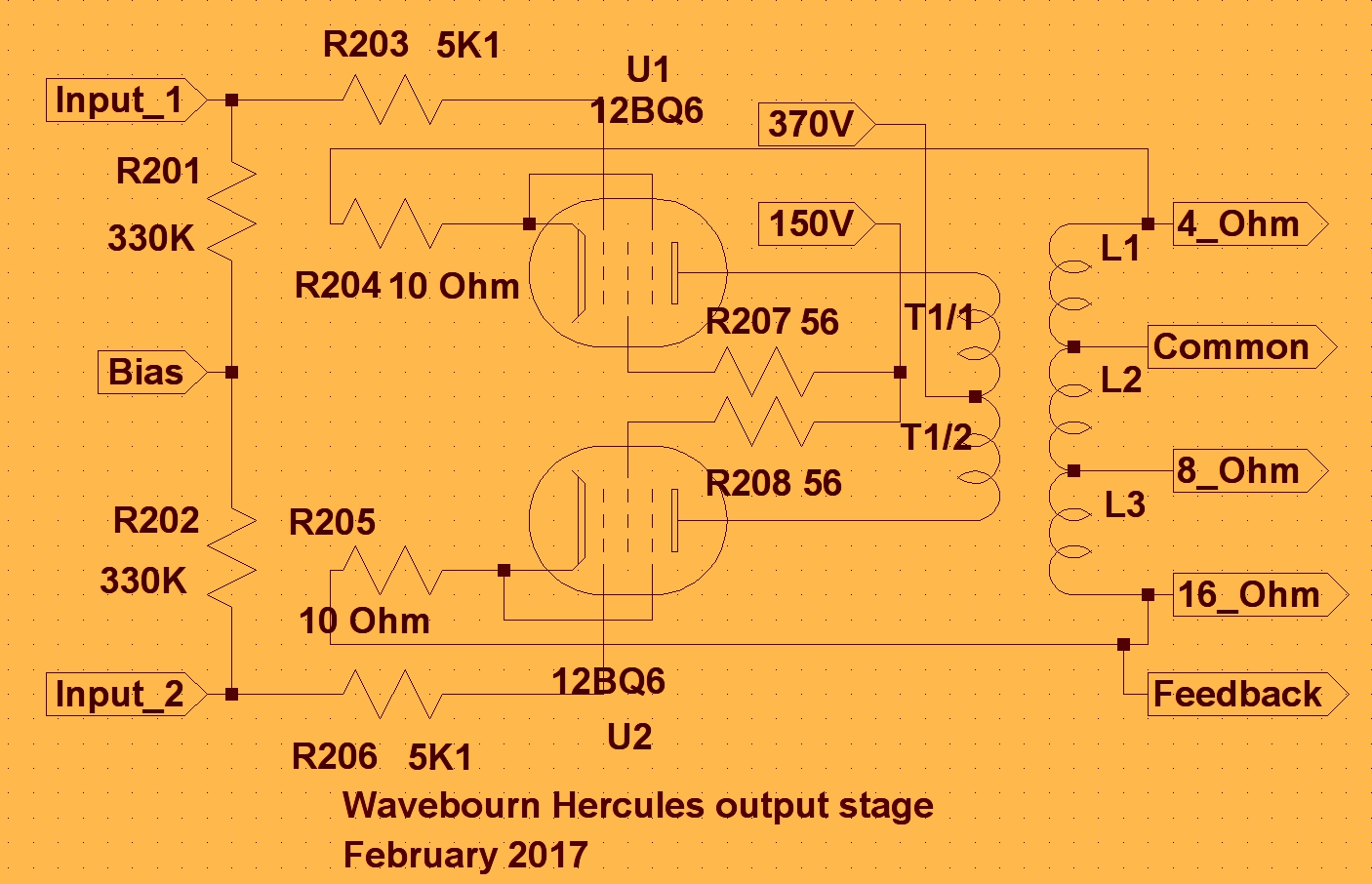

Here is how I did that: I grounded 4 Ohm tap instead of "zero ohm" tap, and took feedback from "zero ohm" and "16 Ohm" taps.
Of course, binding posts were not relabelled, so Zero ohm post is still zero ohm, despite between it and the ground is 4 Ohm output. The picture has a bit misleading marking of outputs.
