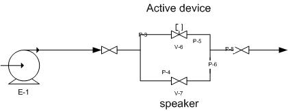

Transconductance is a nifty term for comparing apples and oranges.
What you're doing is taking a voltage input and converting it to a current output. Since the terms (voltage and current) are different, you can't use a simple ratio like Volts/Volts or Amps/Amps. So they invented a term that meant voltage-in/current-out.
Whether something is called a "voltage amp" or a "current amp" is kinda vague...there's no clear dividing line between them; it's a sliding scale. You can look at it in terms of the output impedance of the circuit if you want. A circuit with a low (ideally zero) output impedance is a voltage amp. One with a high output impedance (ideally infinite) is a current amplifier. Between those two extremes you have to split hairs.
Most amps have a real low Zout. This translates into a high damping factor and looks good on a spec sheet. It's also good for controlling wayward woofers. Nelson's F1 has a comparatively high Zout (though nowhere near infinite). This kind of circuit is good for dealing with heat-induced increases in the impedance of a speaker's voice coil, for instance.

A transconductance amplifier is a fancy name for current
source. The input voltage is translated into a specific
output current, not a voltage like with regular amplifiers.
