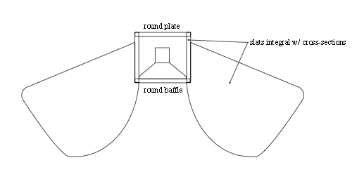

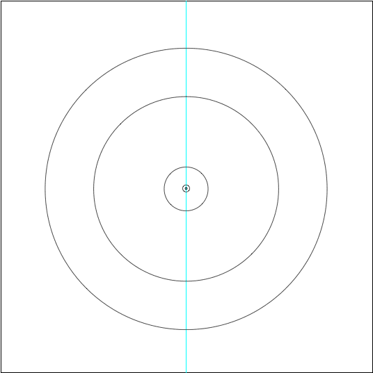

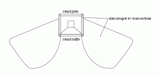

now you're talkin' my language!! i've actually had a mono setup for the past 2 years (up until recently). of course...there have been any number of rotating "systems"...but i went through a big mono kick!!
i have a new "design" that's a combo front/back horn that mounts on a wall (in the center), and uses the ceiling/floor/side walls much like a corner horn would. it is round (or some sort of polygon w/ many sides) and looks almost like a flower (with the driver in the middle). i figured...why not use the whole room as a horn ;-) it would probably only work in a square-ish setting. of course...it is a rough design not based on horn calculations just yet...more to get the idea down. i've attached some screenshots of the "design". just mount that sucker up on your wall and violá!

enochRoot said:and a cross section...
Thanks. When I looked at the first one, I couldn't help thinking "You know. For kids!" (for those who've seen the film The Hudsucker Proxy)
Looks like you're off to a good start. I'm afraid I don't have a free wall to do something like that unless I remove a rather large brick fireplace. Oh well. Someday perhaps.
