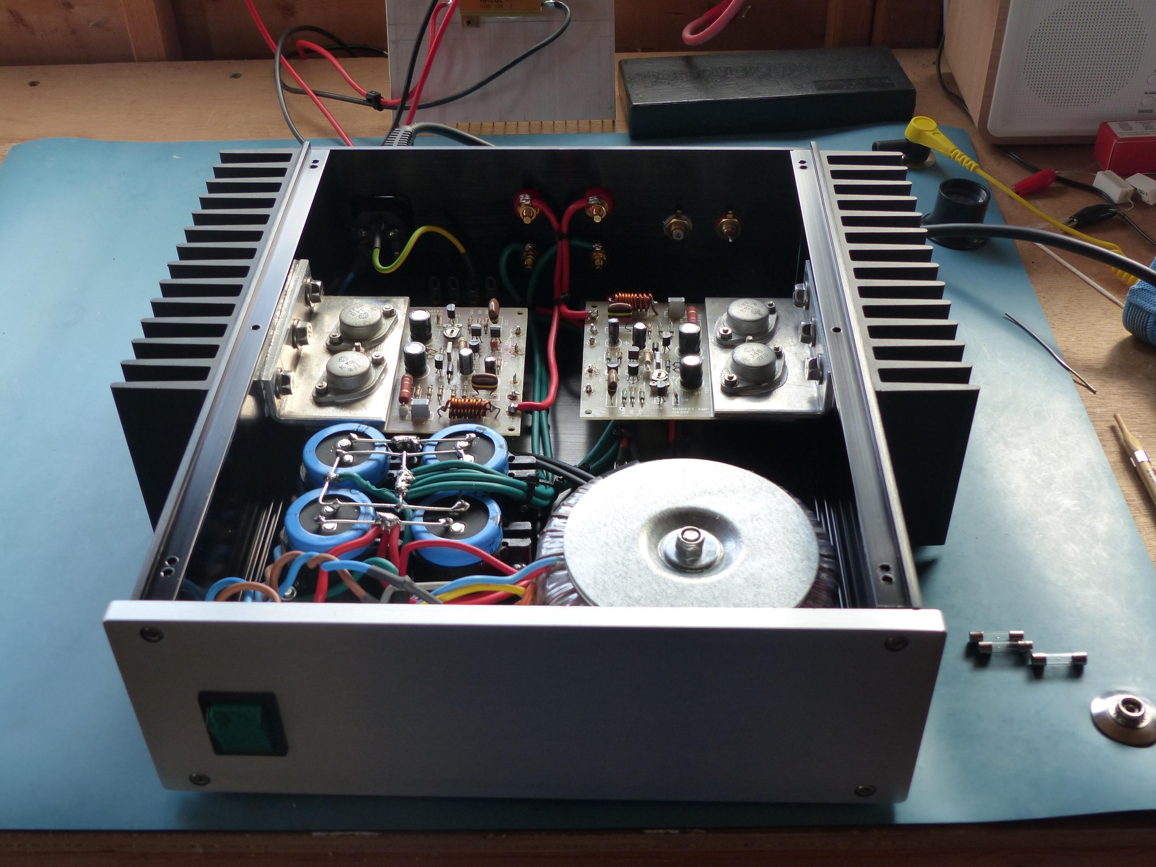

Just finished refurbing my original 1980's Maplin MosFet Amps, 2SK133 - 2SB48, Fitted in new case etc....
Before installing them in their final resting place, I ran them up on a +/- 15v supply, just to make sure they were working ok.
Today came the day to run them up on the full supply, after setting the Bias Current (50ma) is the figure I have for these.
All checked out ok, and with about 10mv dc on one amp and 14 - 15mv dc on the other.
My initial goal was to run them up slowly in 5v pk-pk steps, I only got to 15v pk-pk when I realised the OP Transistors were very hot, and by that I mean holding a pinky on one of the transistors started to get very uncomfortable after about 10 seconds.
I thought I had provided adequate heatsinking, after all, I'm using the original heatsinks I used from when first built them many years ago, and they gave me years of trouble free operation, but at that time I didn't have access to a signal genny or scope, and being in my early 20's I just boxed them up and away we went.
In the configuration I now have, I have used the case side, which is 3mm thick, and the Amps are bolted through this to the Heatsink with 3 x 6mm bolts, which is 190mm long, by 80mm High, with 14 x 5mm thick 40mm Fins, couple this with the side panels which are 90mm High and 290mm long / deep, and that's quite a lot of metal to heat up.
The one thing I did notice, is that over the years the Heatsinks have bowed very slightly, so there is a very small gap at the front and rear between the heatsink and case side.
I couldn't find my Thermocouple's at the time to see exactly what temperature the transistors got to, but I have found them now, so will take some readings tomorrow, ummm Later today now !!
As the heading implies, is there anyone using one or a pair of these amps at the moment, or carried out tests with a sine wave, and noticed they generally run pretty hot, or am I going to have to rethink my mounting method, and possibly drill and tap some more holes at the ends of the heatsinks which I have just had sand blasted and resprayed

Its not a heatsink its a mounting bracket to bolt to a heatsink.
I run mine at low watts without a heat sink and it doesn't even get warm.
Yes Sorry, The Amplifier Mounting Bracket is bolted through the side panel to the heatsink, I'll try and put a photo up later.
The Bias is set to 50ma with No Output Load attached, A temporary 250ma Fuse in the Negative Rail, and the Bias set with a meter across the positive rail fuse (Fuse Removed).
I seem to recall these amps running very cool, and maybe they will with normal use, and not a continuous sine wave.
If I remember right you monitor current in one rail with a meter while adjusting preset to set bias current.
If the bias current is wrong it will get hot.
All thermal transfer surfaces should be very flat, and preferably machined.
The metal surface should be anodized, not painted, for good transfer.
The rear (Contact Side) of the H/S is not painted, but the side panel is anodized, Maybe that's where my problem lies !
Edit, Maybe not Anodized, but a Black Brushed Aluminium surface, it does have a good coating of thermal paste between the H/S and Side Panel, not ideal I know.

The 50ma Bias was in the original documentation, but I suppose might have changed over the years, or possibly for the 2SK135 and 2SB50 variants.
I was feeding mine into a 7.5 ohm 100w Dummy Load, No crossover distortion present at 50ma Bias.
I found the datasheet.
I think my best bet would be to unbolt one of the amps from the side panel arrangement, and bolt it directly to the Heatsink, and see if it runs cooler, if that's the case, then I will have to cut some slots in the side panel to allow the amp mounting brackets to pass through directly to the H/S.
I think that's the same or similar to the one I have, 50ma Bias.
Just out of interest I set mine up as per Maplin datasheet 50mA.
After 10 minutes it gets to 35 degree's C.
Barely hand warm.
And that's with only the mounting bracket.
