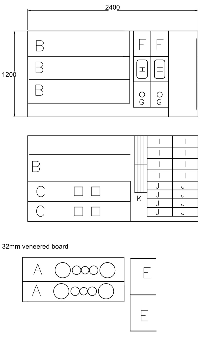

Do you mean, like a cut list?
I’ve offered this in the past; but then it wasn’t clear whether people wanted metric or imperial, and what kind of boards they have access to (our standard in AU is 2400x1200mm) and it’s slightly regional differences.
So I kind of put a pause on it. Certainly I can see that it does make it handy to give it to your cabinet maker or your local Bunnings / Home Depot panel shop. It certainly isn’t fun trying to do this on the spot.
I’m sure there’s an app for that…
If this not what you’re referring to, and I’m completely off, perhaps @Heissmann Acoustics can clarify. That’s a bit unusual for Alexander to not respond.
Hope he’s doing ok…

I can make a cut list easily enough (and I’ve had to because I’m using 18mm material, not the 19mm available in Germany or 3/4” US folk can get) that’s not a problem.
The issue I have is getting plans that basically consist of some dimensions, a schematic, a couple of sketchup model screenshots and almost nothing in the way of construction information save for “route this bit with the waveguide in place and seal the waveguide where it touches the woofer”.
Maybe I’m being unrealistic, but for €40 on sale, I expected a bit more than that, especially with no way to get answers to questions about the build without leaking the commercial plans on a forum.
