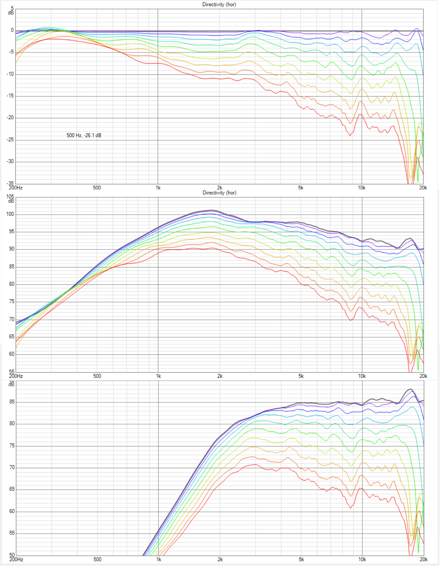

The difference looks hard to understand in terms of driver variability but the shape is somewhat suggestive of an uncalibrated microphone. Are you confident the measurements included the calibration curve?
Yes, calibration file loaded. The mic is a Dayton EMM-6

Measured in the middle of the room.... far away from most things and with a pillow on the floor at first reflections?Yes, calibration file loaded. The mic is a Dayton EMM-6
As far as I know, Alexander used to measure his speakers under rather good conditions.... and I did not find it hard to replicate.... at least with the DXT 🙂
Again, first reflections are gated out. See impulse response.
Reflections will cause comb filtering, not overall "smiley face" tonal balance shifts of 6-7 db.

Not too sure about the validity of the official measurements. I built a pair of the Cinetor Evo kit and here's the gated response.
Hello Defo
As this looks way outside of normal drivers or parts variance I would guess, there is/was something wrong. ~-5dB @ crossoverpoint is just too much.
If you feel like, you could send me raw driver measurements per mail (Impedance + FR without crossover) and I would analyze that.
Best regards
Alexander
