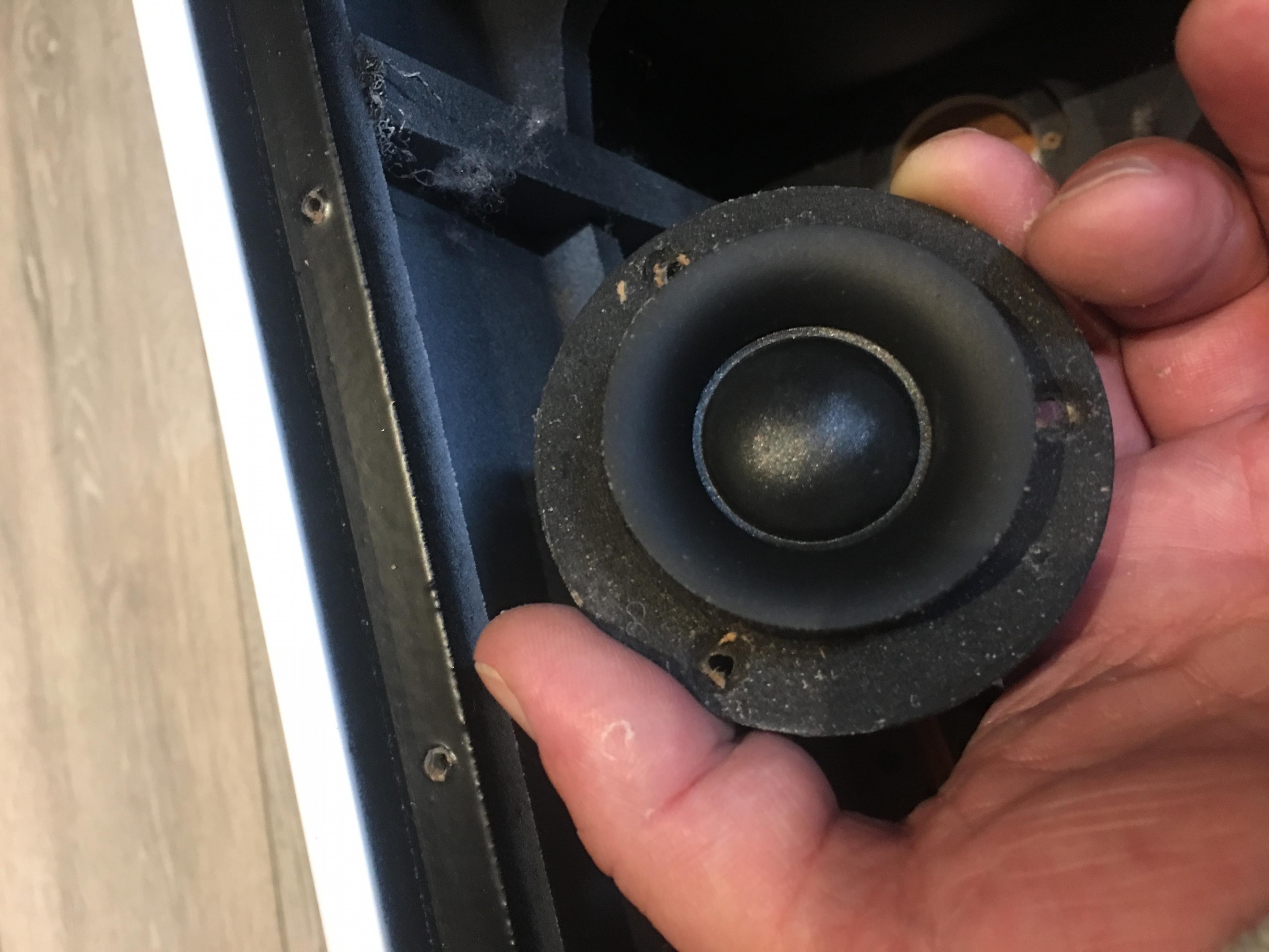

Any ideas for a good replacement 25mm dome tweeter

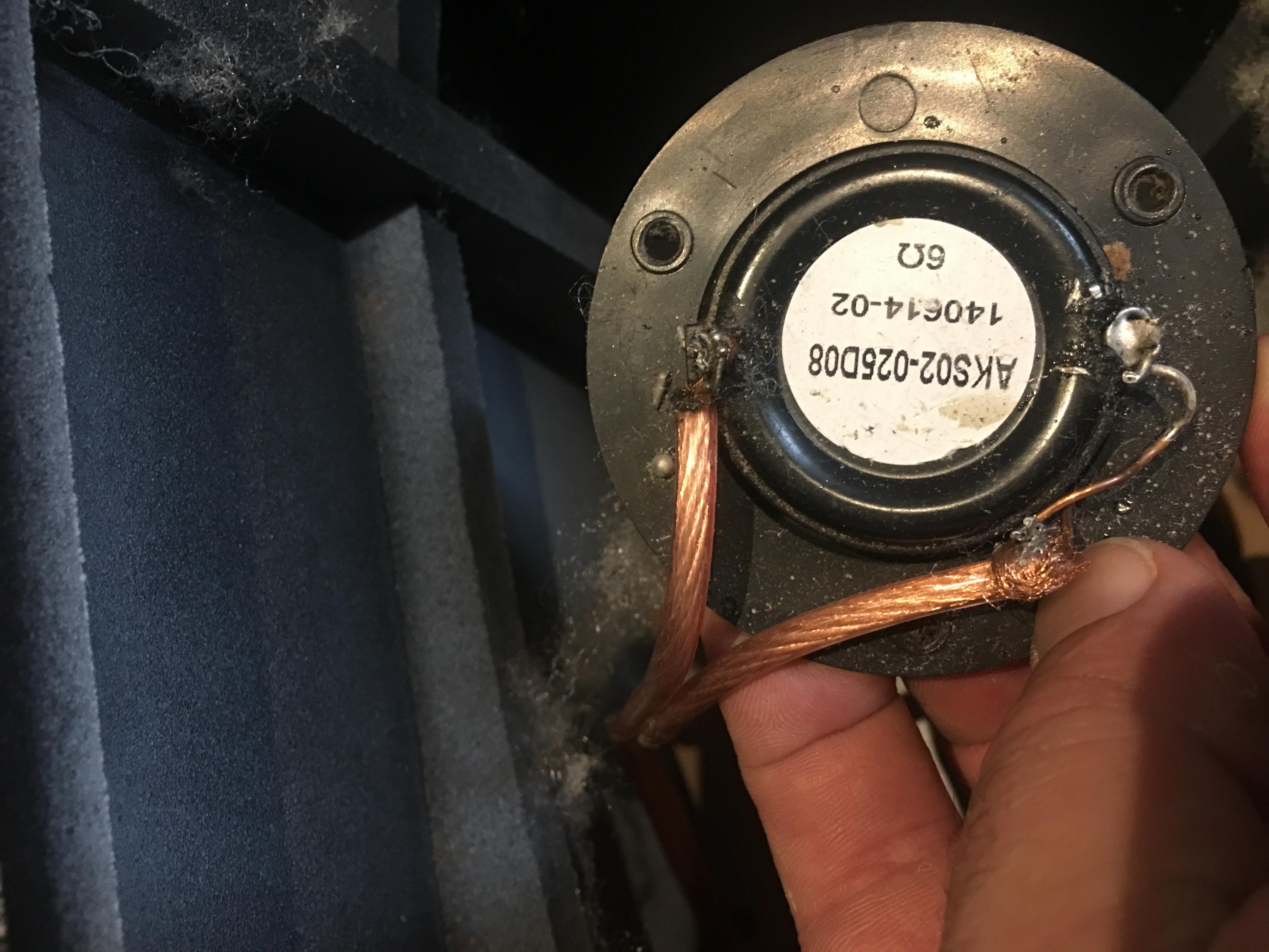

Measure the rear diameter of the tweeter as visible in your rear view photograph. This will be easier done by measuring the diameter of the internal cut out in the baffle board once the tweeter has been removed.

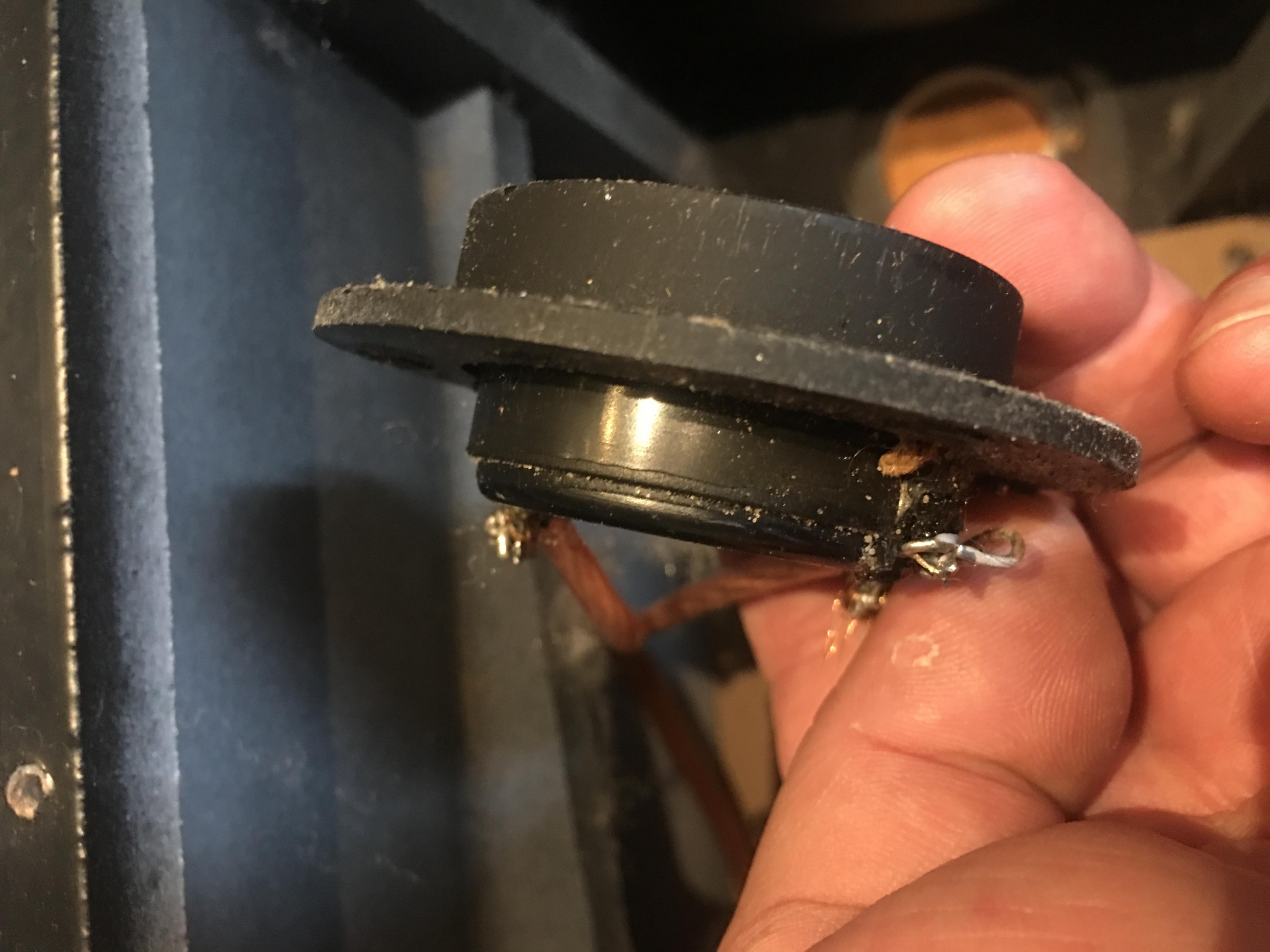

When the tweeter is out, take a photo of the front and side view of the tweeter to reveal how it is constructed.
Also measure the diameter of the outer opening left in the enclosure after removing the tweeter.

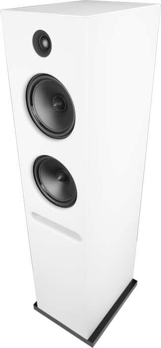

P.S. I've added some images of the K3 for future reference.

The Morel Classic CAT408 soft dome tweeter requires a cut out diameter of 4.4cm so would slot into your enclosure from the front, where it would need to be secured by three screws.
IMPORTANT: The faceplate diameter is 7.2cm so you would first have to make sure there is sufficient space to accommodate the faceplate on the front of the enclosure.
https://www.morelhifi.com/product/cat-408/
The tweeter is available from Wilmslow Audio as well as other suppliers.
Wilmslow can also supply large hex head screws.
Self-tapping Screws Socket Hex Head
DISCLAIMER: Think very carefully before parting with your cash as I cannot guarantee that you will be happy with the performance of these replacements.
If it were me, I would contact Epos for the custom replacements! ;)

The loudness of the tweeter is determined by the series 1.5 ohm 5W resistor and you may decrease or increase its ohmage (or even remove it entirely) to suit the replacement tweeter.
The crossover frequency is determined by the 3.3uF capacitor which may be decreased to 2.2uF if you wish to experiment with the result.
Whatever you do, do not attempt to solder that heavy solid core cable to the tweeters. Epos used 18 gauge stranded copper wire and, since tweeter connections are easily damaged by overheating while soldering, I highly recommend you attach it with push on connectors rather than soldering directly to the tweeter terminals.
