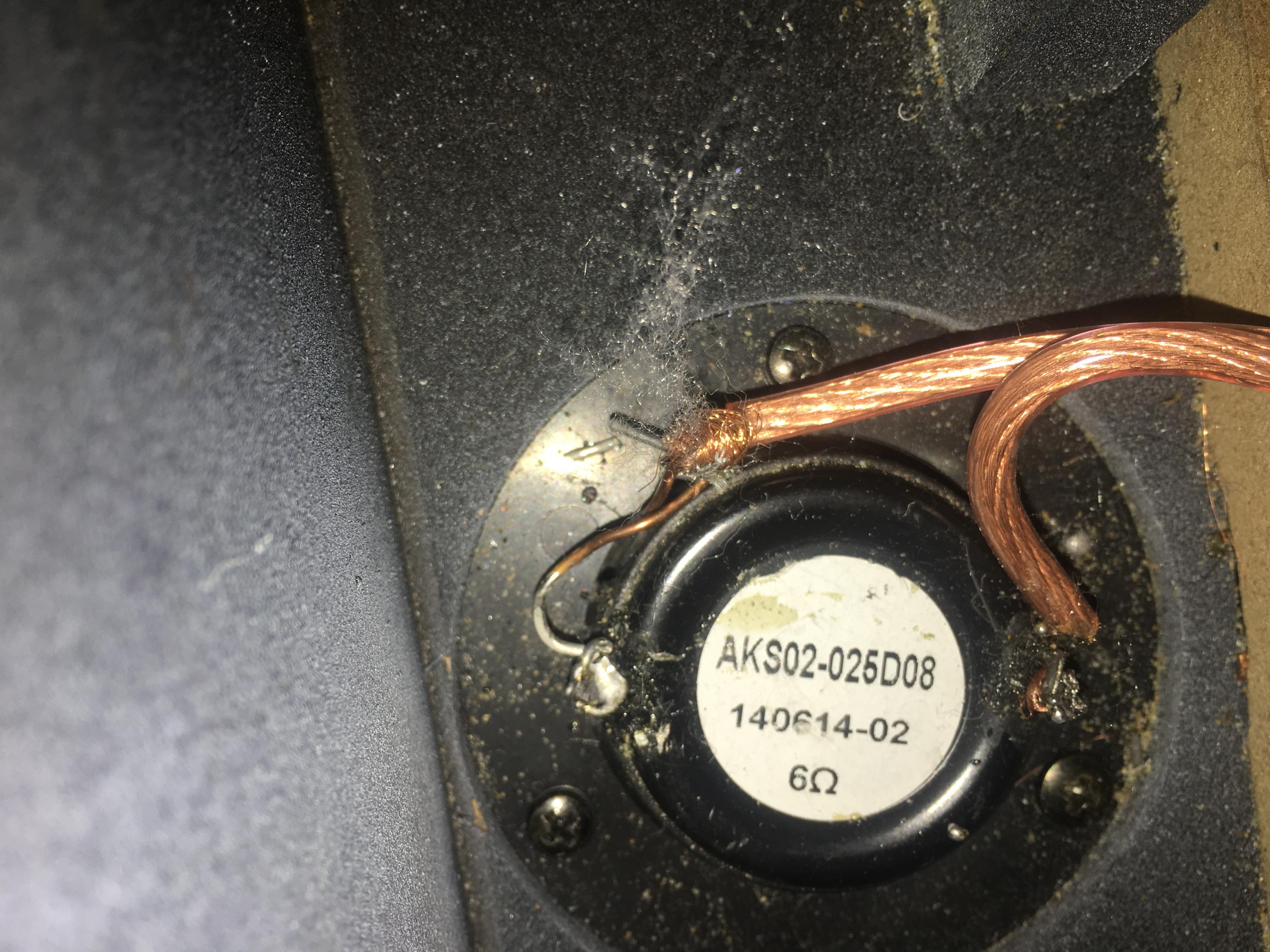

If you have removed the tweeter, could you supply photographs, front and rear, which may identify the tweeter?
Take it out and have a look what's underneath. Could be a normal tweeter with that horn-like faceplate added on top.
Those connections/soldering are not of the quality I would expect of this manufacturer.

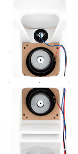

Have you owned these speakers from new? Could the tweeter shown be a diy replacement? What does the tweeter in the other cabinet look like?
Have found this interior shot of the Epos K3. Your tweeter looks like the original, but apparently has been resoldered while replacing the tweeter wiring.
Can you confirm if that is the case?

Thanks galu yes there are the original tweeters. I brought them second hand awhile ago. I want to replace them and do a much better solider job that what you can see in the cabinets. Do you have any good suggestions for me. Once again galu thank you mate.
Thanks youngie. Could the tweeter have been damaged while soldering that unnecessarily heavy solid core wire to it?
Try unsoldering the tweeter and testing it via a 2.2uF capacitor (e.g. from the headphone output of a mono transistor radio).
Alternatively, swap the 'faulty' tweeter with the working one to see what happens.
Whatever the outcome, I would get rid of that heavy solid core wire - it won't make an audible difference over the original Epos wiring!
