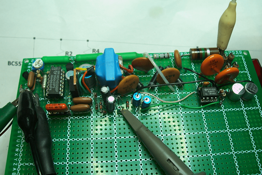

Here is the HV supply, including the electronic filter (bottom right):

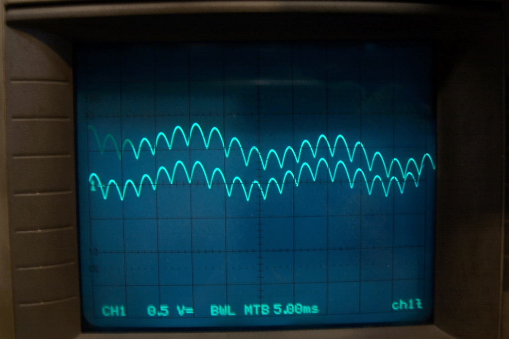

It seems to work as expected, this is the correction waveform at the output of the opamp:
It contains ripple from the converter, some 50Hz, and large amplitude, slow variations (which explains why two successive traces aren't superposed.
It never reaches the +/-18V limit though

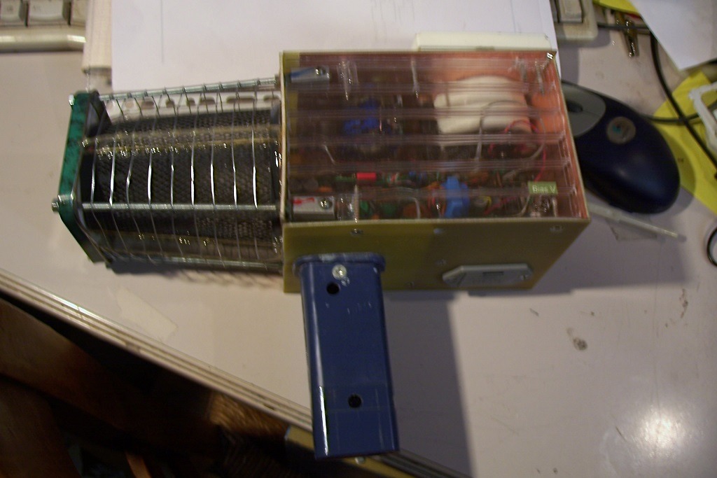

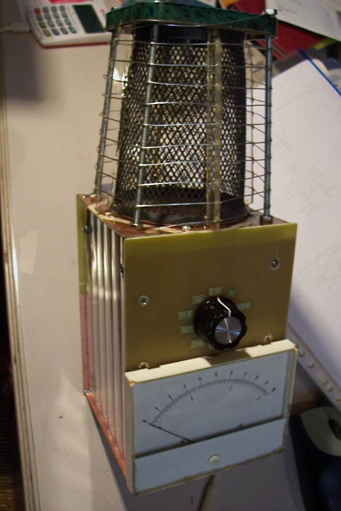

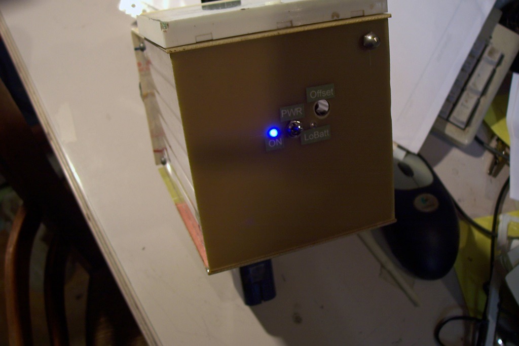

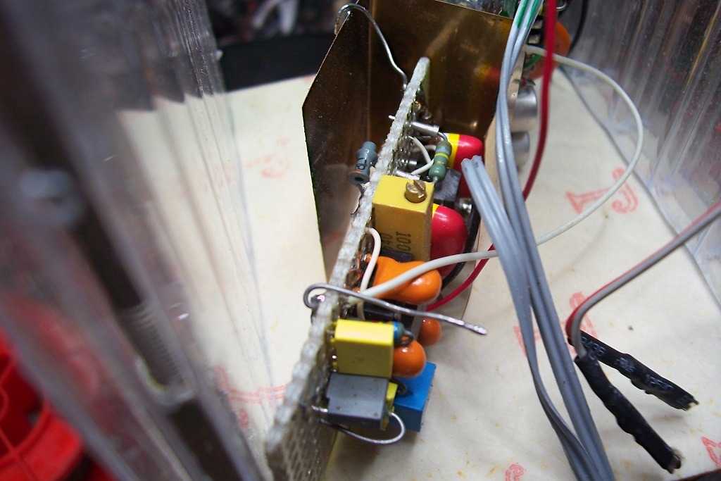

I have finalized my radiation detector:
In the end, I had to add a passive shield: the supply regulation, passive filter and the active filter (courtesy of Marcel) worked well, and kept the supply variations <1mV when subjected to hand effects, but it was still too much.
They caused significant deviations when the device was moved, or when a big object came close (the whole outer envelope sits at ~-5kV).
The centre electrode is a 0.05mm silvered steel wire, and it has capacitance of ~0.6pF to the chamber (the meshed pot, courtesy of IKEA).
The TIA has a physical feedback resistor of 27Gohm, but a programmable divider can be inserted, bringing the virtual value to 27Tohm in √10 steps. A feedback cap of 8.2pF is also included, but electrostatic disturbances came through, due to the insane gain: after the TIA, a post-amplifier can add a further x100 gain, also in 10dB steps.
Between the the TIA and the post-amp, I have included a LP filter, to eliminate the chopping residues, and a twin-T passive filter to kill the 50Hz.
All of this is made possible thanks to the TIA opamp: it a chopper-stabilized ICL7650, having a µV level offset, and its -input is left hanging in the air: the PCB and IC socket have been milled, and the input goes directly to the guarded PTFE passthrough connecting to the center electrode.
The passive shield is the coil of iron wire surrounding the chamber.

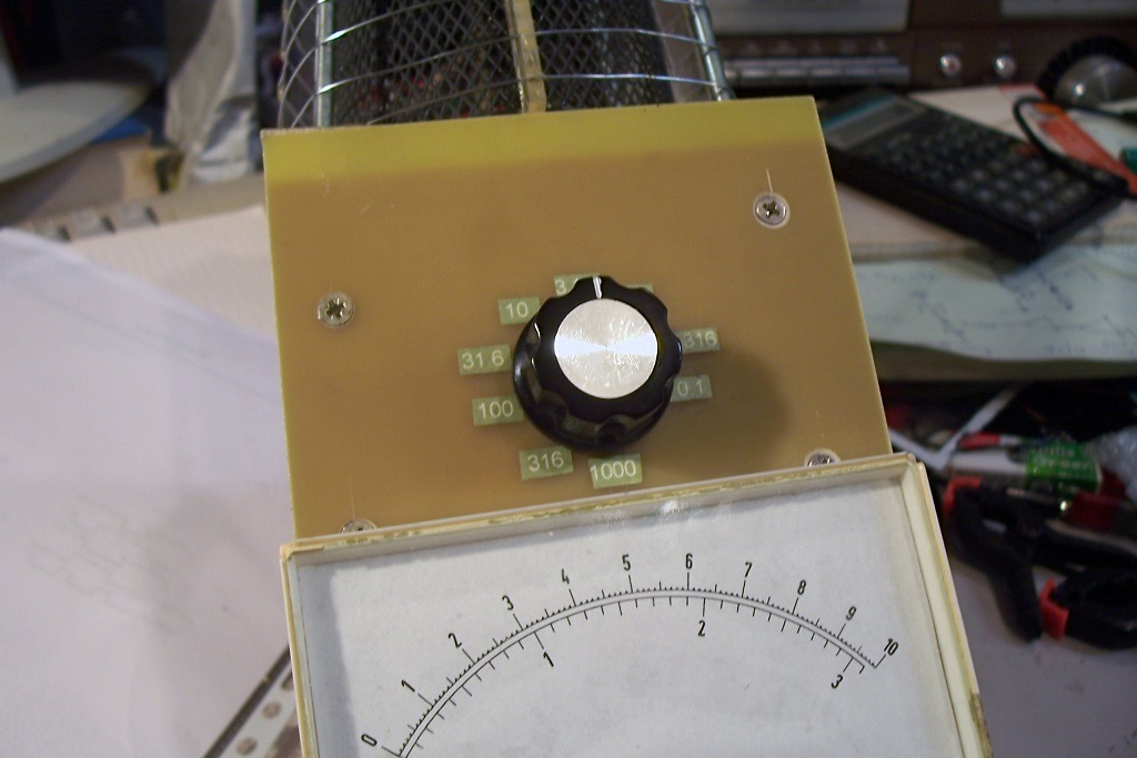

It works well, but the full sensitivity is unusable: the needle remains stuck full-scale all the time after the 5th range, due to the background radiation.
I know that it is radiation, not noise, because noise has an average value =0, but each ionization event causes a positive excursion, which is what I see here, and all the circuitry is bipolar, with +/5 and +/-18V supplies (on even more sensitive ranges, noise certainly comes into play, but they are completely unusable anyway).
I packed such an insane gain because it practically free: a few resistors on the selector.
The current time-constant is 0.47s, but I will probably include a switch to allow a much longer averaging, like 20s.
Ionization events are relatively rare, but at high gain they are violent and send the needle crashing full-scale.
The ideal would be an averaging method that limits excursions without increasing the response-time too much

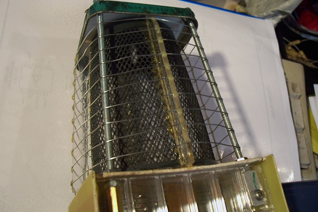

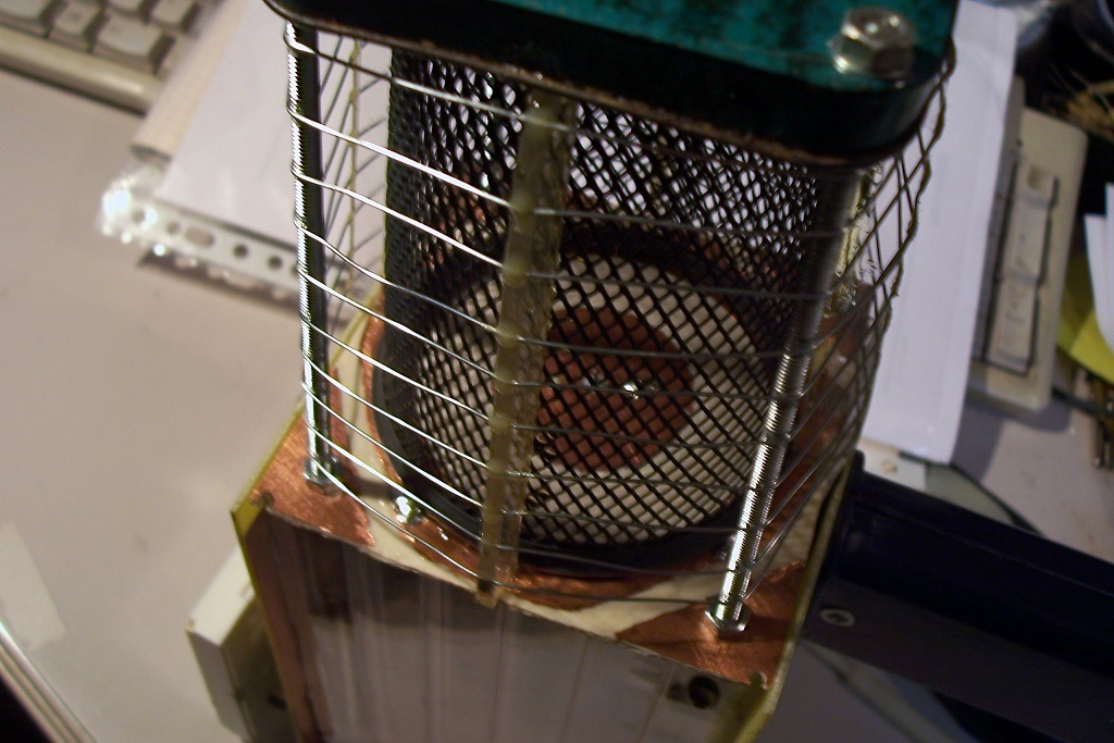

This the chamber, with its guarding ring:
The electric shield has another advantage: it protects the user against an accidental contact with the 5kV can (I had a brush or two when testing!)
The units are arbitrary, as I have no way to calibrate it, but the sensitivity is astounding: it detects the americium source of a smoke detector at 20cm, thanks to the mesh chamber allowing alpha particles, and a small vase made of very lightly doped uranium glass gives a strong reading on the most sensitive usable range.
The construction is an horrible kludge made of disparate materials, angular and bulky, but that is the result of an evolution/growing process rather than a deterministic design.
The total current consumption is 21mA for a battery voltage of 7.5V, which is quite reasonable
