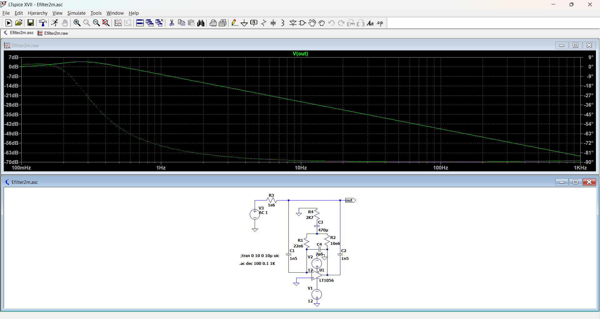

In my view, the circuit looks like a bridged-T inverting bandpass with the output taken at the (2nd order) lowpass node. With equal caps the Q-factor is the root of the resistor ratio (if I got that right), no wonder that it rings severely with a large ratio like 22:1.
The output load has to be accounted for especially if it's not fully resistive (when it is resisitve its value is simply paralleled to the input resistor). I haven't checked what happens with a capacitive load but I would guess it totally throws off things...

One time constant gets a bit large, so large that you get a power-on settling time of about an hour if you want to run it off a single supply, see the attachment.Wow! impressive work, and it looks very promising too. I eagerly await for the continuation.
It is probably possible to get around that limitation and reduce the settling time by using carefully located non-linear components like diodes, but the leakage of a real 470µ will remain problematic. Something to think about.

I'm not sure if the leakage of a typical (rather than worst case) low-leakage electrolytic capacitor will be a big problem for a version with symmetrical supply. The settling time will be much shorter because a 0 initial voltage is already close to the final value. Leakage with a near zero voltage across the capacitor will also be far less than with half the supply voltage across it. If it is a problem, maybe some sort of capacitance multiplier circuit with a film capacitor can solve it - although you probably need three op-amps then.

It may be interesting to note that CL is inversely proportional to the third power of C, also known as C3.
With C = 33 pF, the capacitance of the whole circuit drops from 300 nF to 71.181818... nF (still much more than if you had just connected your high-voltage capacitors in parallel), but CL drops from 470 uF to 4.7 uF. There are reasonably small 4.7 uF MKT film capacitors available nowadays. RC becomes 56 kohm.

I have tested both versions of the filter, and they worked (almost) as expected.
For the 470µ, I used a non-polar cap, and I had to short it manually after the supplies were applied, because the output of the opamp seemed stuck at the + rail. After ~10 seconds, it began to return slowly towards 0V.
It would probably have been able to recover by itself, but I was a little impatient.
I noticed something harmless, but odd: a low-level oscillation at a fraction of Hz was permanently present. It didn't prevent the circuit from operating normally, and it was completely blocked at the output due to 1.5nF capacitor. The amplitude was low enough (<1V) to keep the opamp in its linear region, and it had thus no practical impact.

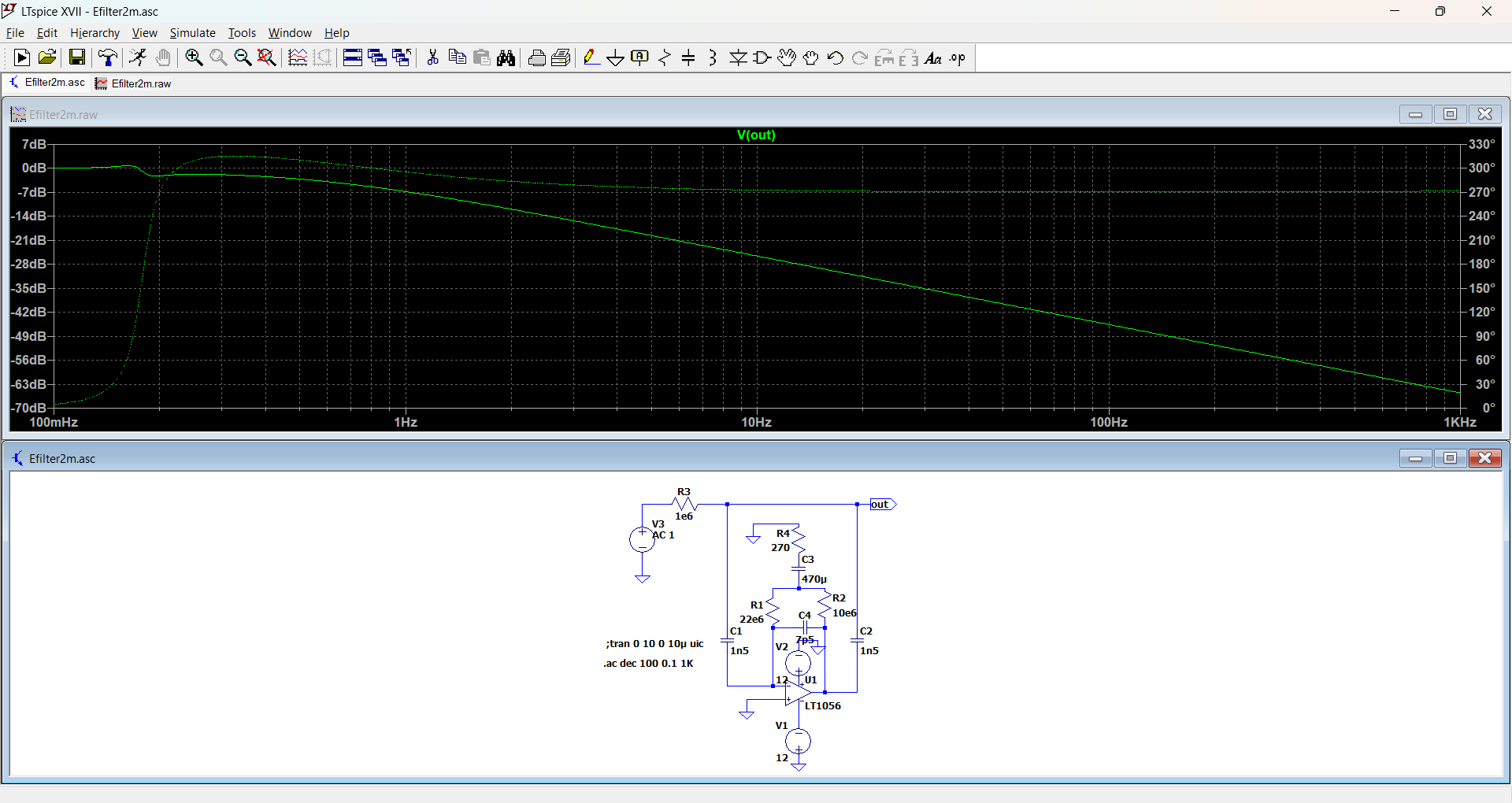

The sim shows a quirky behavior between 0.2 and 0.4Hz; it is probably related:
The less extreme version behaved exactly as expected.

As I said, I cheated: after 15s or so I shorted the cap and had to wait a further <10s for settling. It probably depends on the offset of the opamp, and the initial conditions. Adding a leakage resistor across the cap might help, and I don't think it would impair the operation of the filter: after all, an Ecap even bipolar is pretty lossy, and it has a 2K7 series resistor in circuit anyway. Replacing it with a 2K4 would result in the same loss level, and allow a clean start under all conditions?A gentle bump is inevitable due to the zeros in the transfer. Good to know that this one also works in reality!

A resistor in parallel with the capacitor will increase the closed-loop DC gain and increase the sensitivity of the settled DC output voltage to op-amp offset, bias current and high-voltage capacitor leakage. To keep those effects under control, the parallel resistor shouldn't be too much smaller than 10 Mohm. The effect on the damping will then be negligible, so the series resistor can remain 2.7 kohm.
For example, with 1 Mohm in parallel with the capacitor and not taking into account capacitor leakage, the DC current to voltage transfer changes from -32 Mohm to -251.4075995 Mohm and the voltage gain from 1 to 10.9730727. The series resistor can then just stay 2.7 kohm.

When I made subsequent tests with the correct resistor, I simply kept the cap shorted until after the power was applied, to minimize the startup time.
I am going to test it without any intervention of any kind, to have an idea of the real startup time (using this particular TLO72, supplies, etc.)
I am also going to test the effect of a parallel resistor. I don't think it will have a detrimental effect: the cap will always see the offset voltage of the amplifier, and the output will have this voltage multiplied by the gain, but since the output is AC-coupled, it will only begin to have an impact if it eats up considerably on the dynamic range.
For example, with 220K, the offset, say 2mV, will be multiplied by ~50, resulting in a 0.1V shift. Not really problematic.
In circuits where the only discharge path for the caps is through semiconductor junctions, a residual voltage of 100~200mV can linger on some nodes for hours, sometimes day, and adding a deterministic leakage path can be useful
