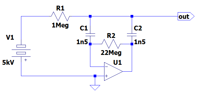

I am building a HV (5kV) supply to bias an ionization chamber.
The supply needs to be clean, both from the converter ripple and the external electrostatic influences.
The logical solution would be a large bypass cap, but at 5kV, it is unpractical.
I plan to use 1.5nF caps, and multiply their effect using an active circuit.
This circuit works:
But I wonder if simple improvements are possible, without going overboard, compromising the stability or using insane components values.
Any ideas?

No ideas from Linear Tech/Analog Devices application note 118? https://www.analog.com/media/en/technical-documentation/application-notes/AN118fb.pdf
Jim Williams did a few app notes on the subject, but out of convenience he placed the inductor in the wrong place.The inductor should be from positive rail to mid tap of the transformer as Baxandall placed it innitially to be more efficient.
The top resistor of the feedback divider is 1gigaohm; it is very high, but it consumes 5µA, and the flyback converter operates at a very low frequency, low duty cycle: a few tens of Hz, a hundred max., and the conduction time is a few µs. This is sufficient to cause a significant ripple on the final 10nF filter cap.if this is a low current, low energy supply then why are stacked capacitors impractical ?
This very discontinuous mode of operation is required to achieve a low current consumption, a few mA, because the equipment is portable and operates from a 9V battery.
Adding a number of >5kV capacitors is certainly possible, but unpractical for a small, hand-held device.
The resistors would consume much more power than the 1G feedback resistor, which is already borderline.You're on the wrong forum for that.All xerox machines have 4...10kv bias circuits for that.

In addition, the converters operate in a ~continuous mode, which is incompatible with a low power consumption
Same remarks, and the voltages illustrated are an order of magnitude smaller than 5kV. The filter caps are also proportionally much larger.No ideas from Linear Tech/Analog Devices application note 118? https://www.analog.com/media/en/technical-documentation/application-notes/AN118fb.pdf
Basically, I don't want to dramatically alter the topology/configuration: the current circuit provides a well-regulated, 5kV supply whilst consuming under 5mA, which is quite nice considering the simplicity of the circuit: one BJT, one MOSfet and a standard CMOS IC.
It is very compact too. I want to keep all of those features, but at the same time reduce the noise to insignificant levels. I know that I can use brute force: increase the cap values, or push R2 to hundreds of megohms, or use a multi-opamp corrector, but if a simple and clever fix exists for the current filter circuit I would like to know about it; I have already searched the net, but I have found no satisfactory solution.
As the current consumption is insignificant, I could increase R1, but it would make the circuit more sensitive to external electrostatic perturbations, which is undesirable

You have a nice FDNR (Y = K s2) with damping capacitance now. Replacing R2 with a T network, with the branch to ground being an RC series network, could maybe result in an K s3 term and damping terms in the admittance from out to ground and make it a third-order filter. The keyword is maybe, I haven't calculated the transfer yet.I am building a HV (5kV) supply to bias an ionization chamber.

Thanks for that analysis: what I tried to achieve when I arrived at that particular configuration was a low impedance as seen from the junction of C1, C2, R1, whilst using only ~low value caps (because they are HV).You have a nice FDNR (Y = K s2) with damping capacitance now. Replacing R2 with a T network, with the branch to ground being an RC series network, could maybe result in an K s3 term and damping terms in the admittance from out to ground and make it a third-order filter. The keyword is maybe, I haven't calculated the transfer yet.
I didn't aim at or see a FDNR in it before you mentioned it.

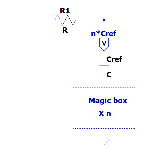

What I dreamt of was a capacitor-multiplying circuit using a single capacitor, C1 or C2 as a reference, something like this:
It would kill many birds with a single stone, but thus far I didn't manage to find a solution (but I have a deep, strong feeling that it is possible).
The best I could find was the circuit of the first post.
Using a synthetic, negative capacitor having a value close to 1.5nF could create a positive combination much larger than 1.5nF, but the problem is that it uses a second capacitor, and it would need to track closely the 1.5nF, which is a HV ceramic, X7R at best, not particularly stable.
The schematic shown is just the barebone concept; the real circuit includes many additional resistors, protection diodes etc. to deal with mishaps inevitably inherent to HV circuits. I don't want to confuse the situation by adding components having no function during normal operation.

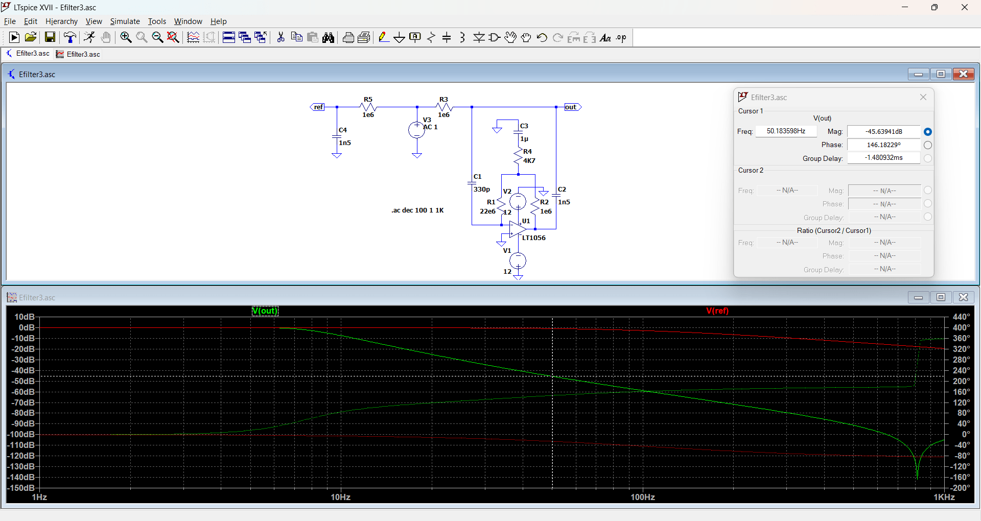

I have tested Marcel's idea: it works very nicely, and allows asymmetrical values, which is convenient, as one of the HV caps can be reduced to 330pF:
The reduction in performance is minimal, and the circuit allows for more than 40dB reduction at 50Hz. The settling time should remain tolerable.
