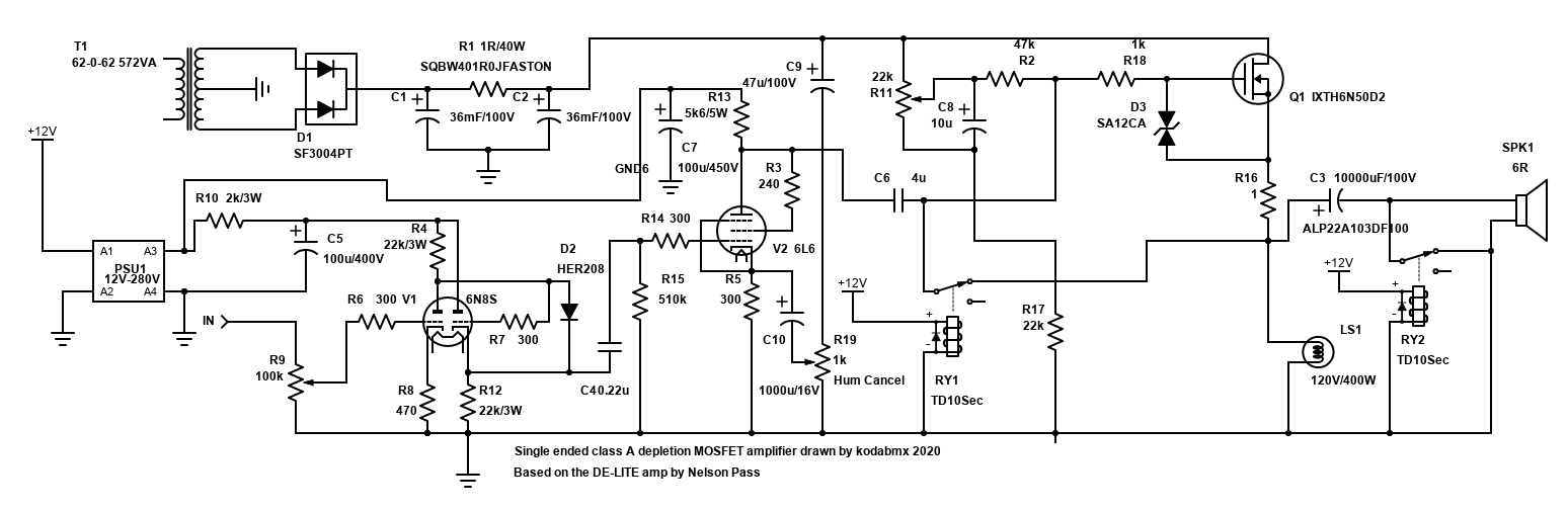

Any help? First attempt at a "hybrid" using depletion MOSFETS
Here is the final current schematic that works properly... Ohms law says it's good for 10W at 4R and 20W at 8R... This is maximum power, it won't sound great at those levels... Still it is very enjoyable to listen to.

Can't quite put my finger on it, but there's something about having the bias pot, R11, span the output signal. Maybe that the low-frequency roll-off will vary with the bias setting; the amount of distortion and its distribution probably will as well.
It would add a bit more complexity (but you've already added a lot to the De-Lite;)), maybe bias the CCW end of R11 with a CCS and zener. Then if you fit the CW end to the output, instead of the Source terminal, should both improve stability and further reduce distortion.

Yes, you're right... This must be why Nelson Pass suggested I tie R11 from ground to B+ instead of ground to source. Still, C8 should stabilise the gate voltage, no? If I terminate R11 into B+, I'll need to pad the R11 to make adjustment easier - it's already a 5 turn pot but the smallest change on it makes already a 0.2V difference across the MOSFET.

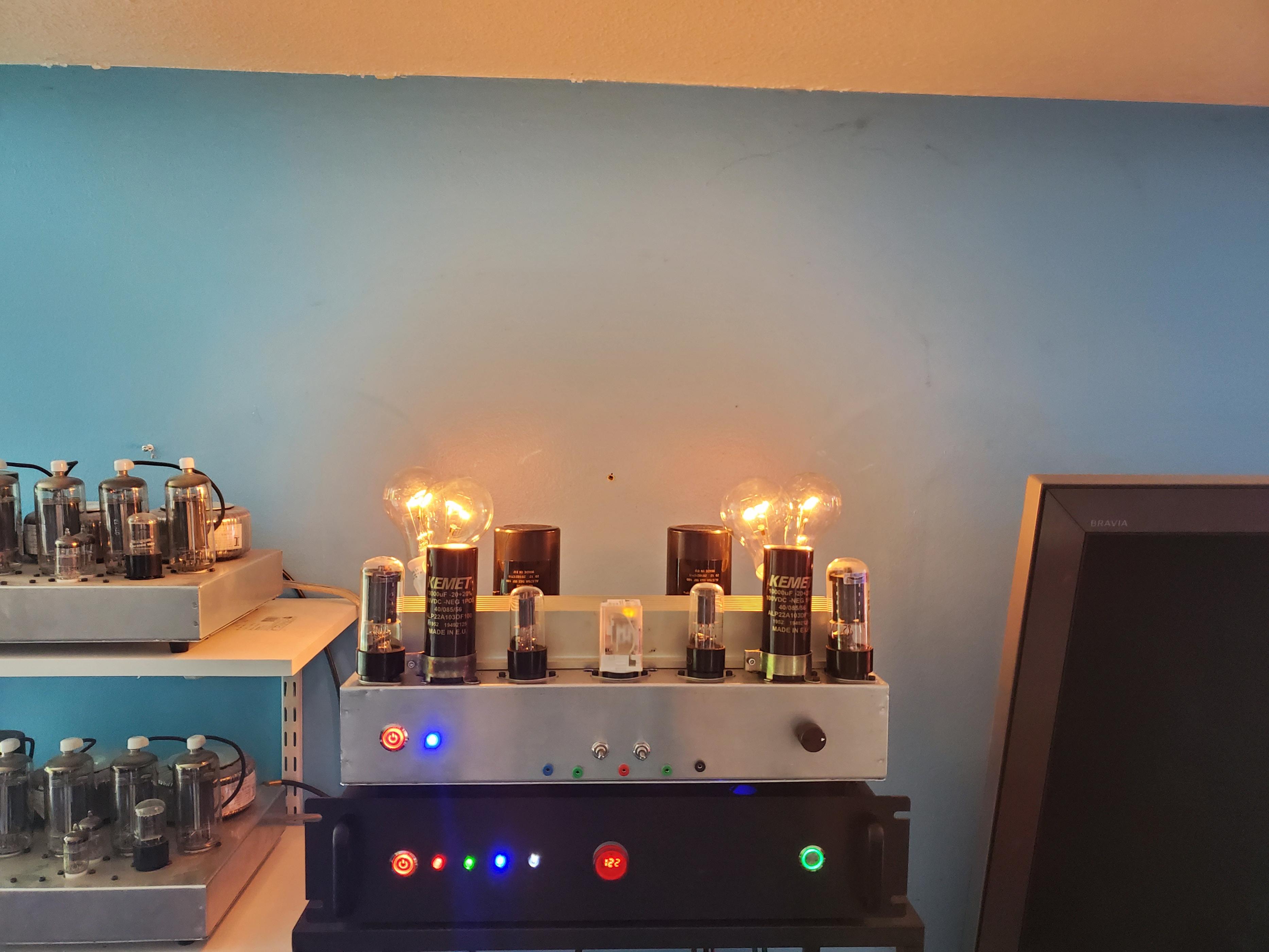

I also decided to try 400W as load: Current is now 2A instead of 1.6A. It seems to be a happy. I will post an update when I change the termination of R11. I might jump out R16 to see if the added voltage in the circuit would be better than the local NFB that it provides.

Umm .. now you have Vgs=0 'til the relay goes off -- near maximum conduction! Maybe not such a big problem with the load being LS1 ..
Also, C8's negative terminal should probably go to ground. That would provide better PSRR, and would attenuate the noise generated by the ~2 mA through the divider's resistors.

I always had Vgs=0V until the relay turned off :) Indeed, because the load is LS1 switching the transistor "ON" just turns on the bulb and prevents Vgsmax being exceeded :)
Good point about C8. Although I don't hear any hum, I have two window shakers going in here, too.

Ok. So after a day of listening I can't believe this thing is single ended. The change in biasing arrangement make a huge difference to the dynamics - It doesn't fall over on bass heavy tunes anymore and I find myself not needing to have it "full blast" to get anything out of it.
The heatsink is hotter than the 6N8S tubes, and about the same température as the 6P3S.. ~80C or so.

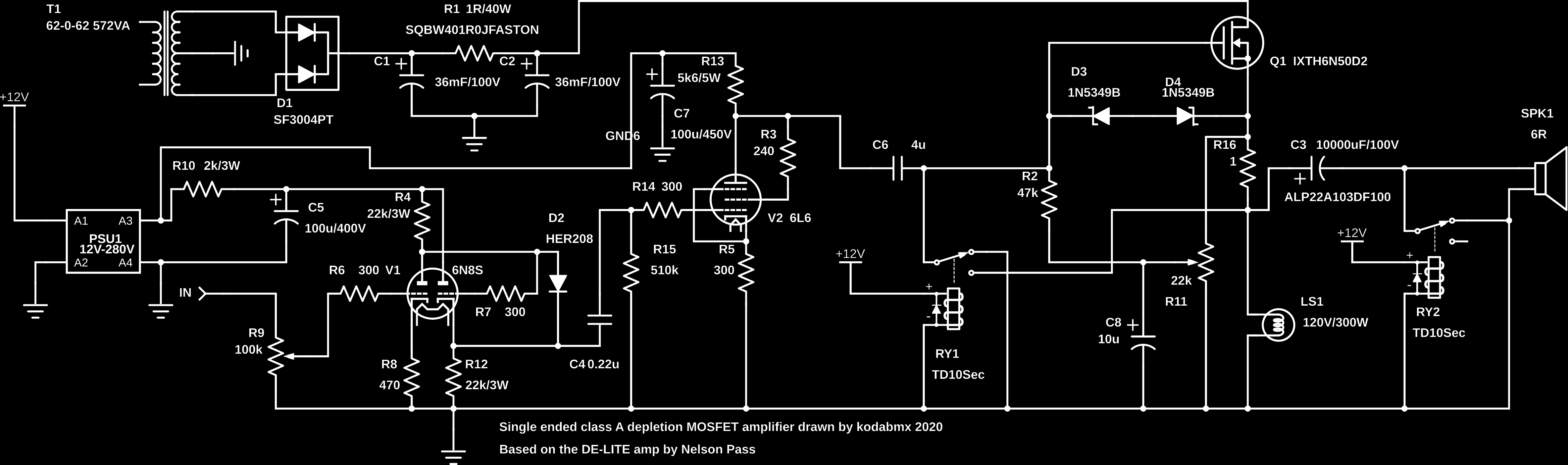

Ok so as a test, I cranked the volume on the preamp to 10's of volts of clipping. Even with 12V anti series zener diodes between gate and source, the MOSFETS both f*cked off. They are basically wires now. I thought the zeners would protect from this? What am I doing wrong?
Wow .. super bummer .. I dunno. This could take some serious analysis.
I also have no idea how Depletion Mode MOSFETs feel about Gate stopper resistors. Could it need one?
Since the B+ for the preceeding stage is much higher, maybe a Schottky or something else fast, Cathode-Drain to Anode-Gate would help.
Just my 2 cents ..
edit: Just curious, what was going on in the (presumably) music at the time?
Nothing special - just nasty clipping. Of course my tube amps don't care at all when I do that sort of test LOL
I'm thinking of replacing the zeners with a bidirectional TVS.Maybe that will sort it. I'll do some voltage tests of power out vs input and see if I can clamp the input signal to the tube stage instead of relying on the protection diodes at the MOSFET.

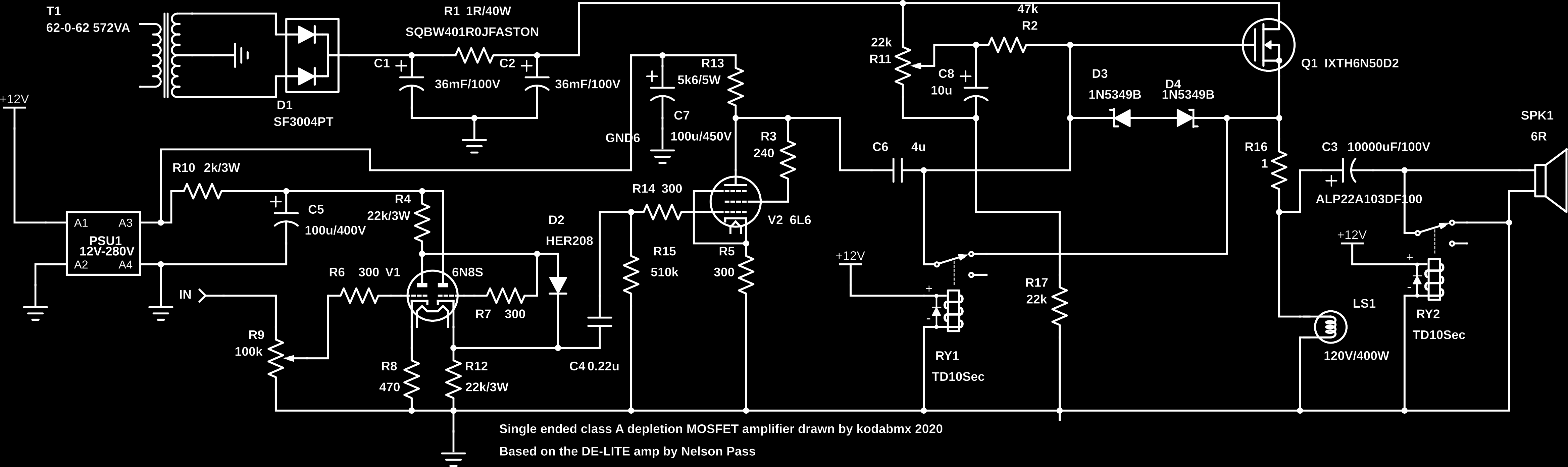

Ok... A/C season is done and now I hear the hum. It's such a minuscule hum that most of you would tell me to live with it.
However, Since I designed it, and I have read Broskies site many time, I came up with a cross between Aikido and Janus...
C9, C10 and R19 make a hum injection scheme ala Janus. This should null the hum by injecting anti-hum, no?
Thoughts?
