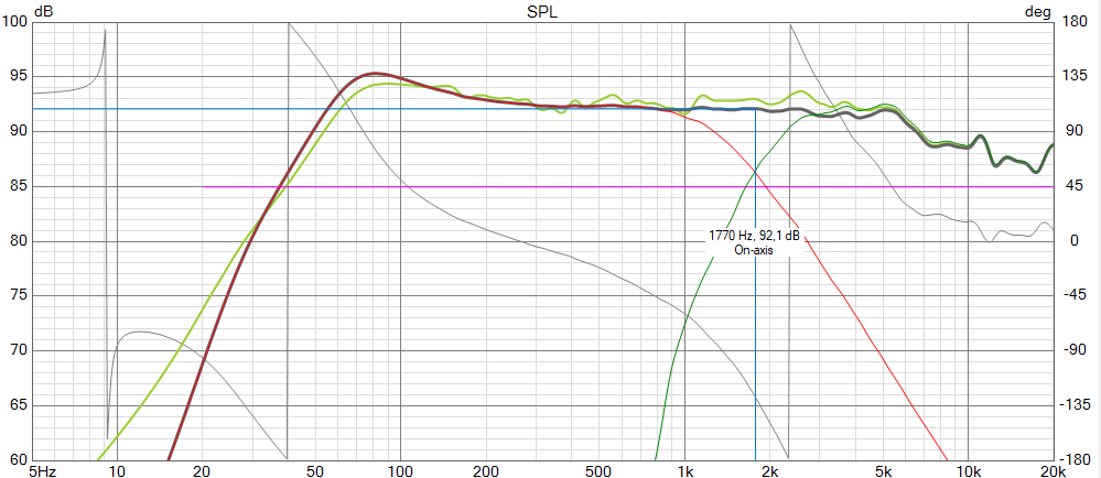

Can't decide if I should cross a little low around 200 hz to a 6.5" or a 8" PA driver to profit from a higher spl (BSC on the mid unit not on the Faital) or higher below 500 hz with the BSC on the Faital 12pr320 so sligthy less spl, maybe more around 90 db at 2.83V and go for a dedicated 4" to 6" midrange...

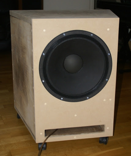

I would like to know what would be the dimension of 2 rectangular ports in 100 liters cabinet for the 12PR320 and the 15PR400.
if i made 2 ports 280mm lenght and 35 mm wide what should be the height?
My second question, if I decide to go sealed cabinet, what would be the best possible woofer and what to expect as F3 with the 15 and 12 Faital
