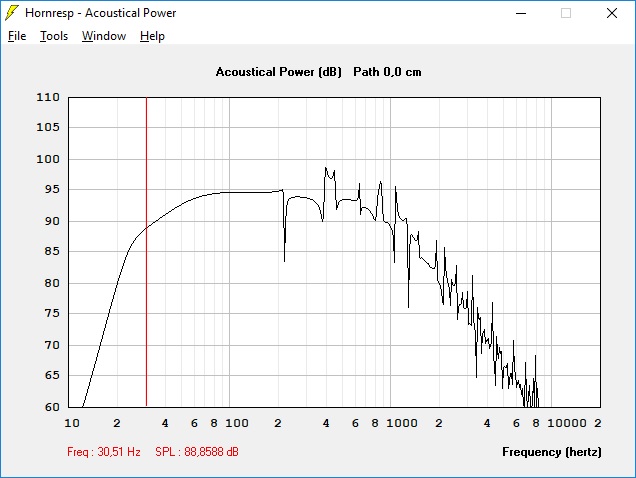

Ref: my first post, it looks really good in 108 liters, but here's a slightly smaller box at 101 liters in 2,83v/2pi:
I do not mind sharing the numbers, but thought you might like to fool around with simulations yourself first.
Note the slow roll off, I have found that I personally prefer this type of frequency response to completely flat to some point, it gives very good group delay and very smooth phase. Sounds like a closed box, but goes deeper.
