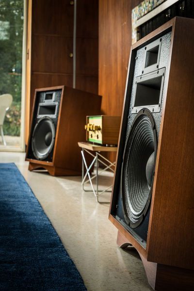

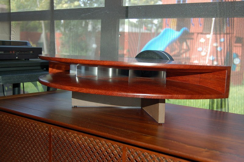

With bass reflex box and a horn "tweeter" option I would like to make rectangular wooden horn which will be independent located above.. but I mainly see too large square horns in calpanos speakers
The dimensions of a horn might have to be specific (the length and the height of the mouth, and the angle comparing to the diameter of the tweeter). Those would change the frequencies and the directivity

With a 12", the horn does not need to be that large. What brands can you buy at your place? Selenium, Eminence or RCF make some nice horns - e.g. RCF H100 or HF101 or Selenium HM25-25.
My horn stack is also in separate enclosures. Ideally, the acoustic centers od the 12" and HF driver in the horn should be aligned - which means either a wide shallow horn or the horn sticking a bit forward as you can also see in some pictures. The other option is active four channel amps + DSP for crossover and delays to achieve time alignment with the placement you need to look good.

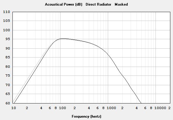

The first attachment is showing the difference between 60 l (dark) and 90 l (light). The second attachment is showing the effect of 6 dB boost at 50 Hz said:Thank you for your help.
Watching back these 2 files focused on our conversation on the low frequencies but I am trying to understand on the other end with high frequencies? The curve seem to get down without any high frequencies.

Hornresp is using a simplified model of a loudspeaker (as any other software does). It is modeled like a rigid piston (I think), which it is definitely not.
That's because the chart is showing the power response. Use the Directivity tool to show the pressure response instead.
