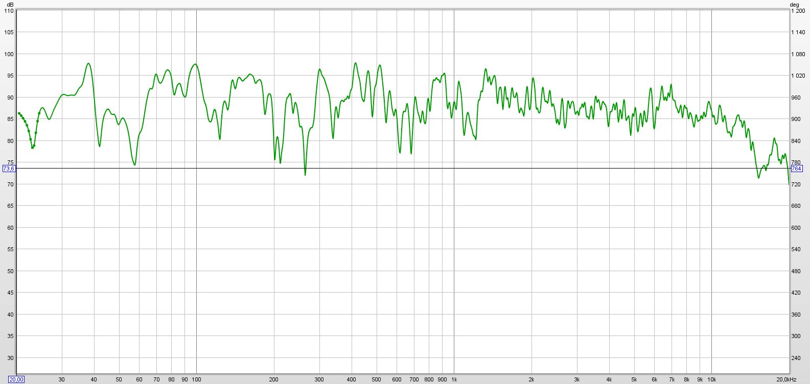

I had the 12-250TCs in a 44 l BR box of unknown tuning (attachment 1) - the box was used basically as a holder, since I crossed over to my subwoofer horns at around 120 Hz. Now they are in ca 90l sealed boxes and can be easily listened to on their own (the other pictures) and since they are sealed, they can handle a bit of boost at the low end to extend the response lower. The key to listening to those is to toe them in/out, so that the sound at the listening place is balanced. Some in room measurements of the sub/fane combo are in the attachment as well. This is around 20 - 30 deg off axis in a ca 2.5 stereo triangle and no smoothing.

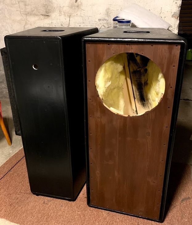

Vha, I just should say, that the Karlson type speakers have a certain magic to them (I got one German made, unfortunately, just one). Aesthetically, you could place an acoustically transparent cloth in front of the slot and they would look as standard speakers - about the size of a 2x12 guitar combo on its side or a vertical 2x12 guitar box.

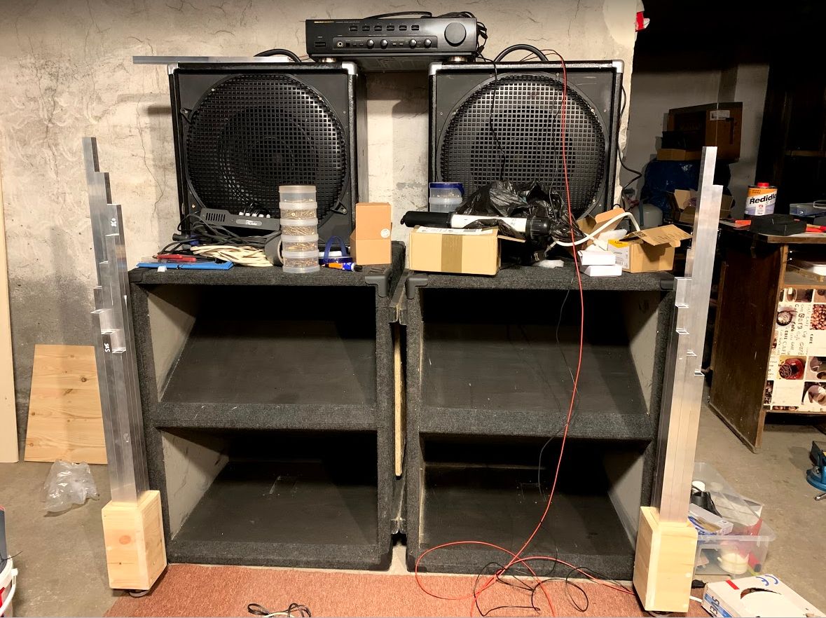

I used a 90l box because I got a used box of this size cheaply (it used to hold two 12" speakers and a horn). I used them as PA (with the subs) for a small garden party and it was plenty loud for that purpose (reproduced rock/metal music).

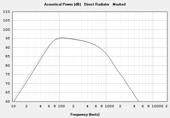

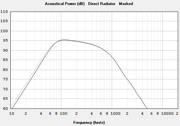

The first attachment is showing the difference between 60 l (dark) and 90 l (light). The second attachment is showing the effect of 6 dB boost at 50 Hz, which is safe up to ca 8 W at this frequency. 8 W with this loudspeaker gives something like 105 dB for a single speaker at floor level. Which is plenty loud. You will be able to use even more with music that is not too bass heavy.

Maybe we should start drawing pictures🙂 Two full range speakers in one enclosure playing one channel and other two in another box for the second channel is a no go. That brings lots of comb filtering into the game. I would instead go for a dedicated midbass woofer with a horn crossed over at ca 1200 Hz. Or the other option is to use one full range and one dedicated mid-bass in one box, crossed over around the baffle step frequency, each with its own internal volume - separated. The midbass could be bass reflex and the full range in a relatively small sealed box.
