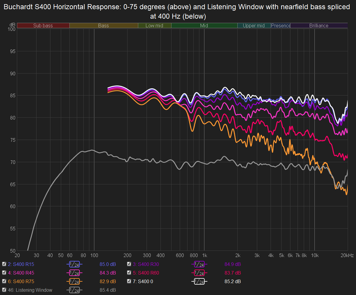

I'm trying to wake up this old thread, cause I'm trying to figure out a basic understanding of waveguides.
Basicly - if that is possible with this kind of topic.
If you have a nice and even cross between a waveguided tweeter and a midrange - then is it not just 2 things that need to be in place?
1. The waveguide needs to be the same physical diameter as the midrange.
2. How low in frequency and how narrow the directivity works is directly related to the size of the waveguide/midrange combo.
Am I oversimplifying things? Or is there a "red thread"?
Thor - it's best not to refer to specific products and be more general about design attributes rather than specific models. I have no idea what a Buchardt S400 is (although I do recognize "Summa".)
In general what Allen says is correct, equal size is not a hard and fast rule, but it does tend to be very near the sweet spot. In general if the waveguide is smaller than the woofer, there will be CD problems at the crossover. On the other hand I have made some of my best speakers with a waveguide larger than the woofer. And, in general, bigger is going to be better as a tighter control DI is possible. I find higher DI to be much prefered over lower DI, but in either case it needs to be flat and smooth throughout most of the audible range.
Soi I don;t know if this is "where (you) are trying to get at", but I hope it helps.
Thank you for your response - highly appreciated :)
Sorry for taking it for granted - I should have posted a picture of the Buchardt to make a more clear point. In short it is a small speaker that clearly has the same size waveguide as the woofer/midrange. In my limited knowledge of waveguides, I presumed that there was some kind of logic in this design, that could be scaled, so that I could use it in a floorstanding speaker. Righ now I use a typical dome tweeter with my 5" midrange and three 6" woofers to blend with my 4 subwoofers. I was then thinking of putting in a waveguide to make the top end a tad better - even though I do understand, that it can never have a perfect DI - but I hoped that it should be better than a normal dome tweeter design.
Does this picture give an idea of my assumptions of a scaled down Summa?
It scales in the sense that as the dimensions get smaller the best crossover point moves higher and the DI lower. These have a lot of disadvantages to them, but hey, if size rules over performance then scaling directly may be the best option.
Hate the square edges however!!
Hey - looks is always a factor - more or less ;)
But thank you for your answer. It kinda tells me, that I can scale a waveguide - roughly - but have to live with some compromises if do not want a big bulky speaker.
Fair enough - I can go by with that :)
If I do get curious and want to build something along the Abbbey/Nathan - do you still sell the Waveguide as a kit, or do I have to find something similar in the jungle of waveguide on the market?
