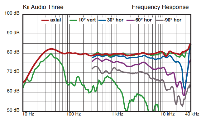

I don't believe that there is extensive research of directivity behind the bass layout of Kii3. I don't believe that the response is cardioid either. The dip in 60¤ horizontal off-axis appears in crossover region to the mid and it comes from signal delay + physical time alignment. We should see full 3D power response actually. KEF Blade and Devialet Phantom are doing the same thing. Any speaker with a sideways bass driver is almost in same league, but usually xo is lower.
You should rethink your belief. 😉
The measurement from AUDIO magazine is a bit misleading, because there are two green curves. 10° is the one mostly covered by 0°. The other green curve is at 180°. And it clearly shows a cardioid directivity above 80 Hz. Without the DSP controlled woofers on the back this would be impossible for such a small speaker.
Hi Juhazi. I don't think you can compare the Kii 3 with either KEF Blade or the Devialet Phantom. The big diffrence in the Kii is the two rear mounted woofers, which is driven time delayed. This is what can acomplish a cardioid response in the lower freq.
FoLLgoTT good to see the response, though somewhat disapointing in the low freq region ..... below 80 Hz .... thats where it is needed if it should do anything what so ever to standing waves ....

I stand corrected about Kii 3 bass system! Obviously rearside drivers are delay matched to sides (reverse phase). And obviously there is delay also for front mid and tweeter plus appropriate transfer functions to arrive in one-knee step response. However the peak of the step impulse is ragged.
