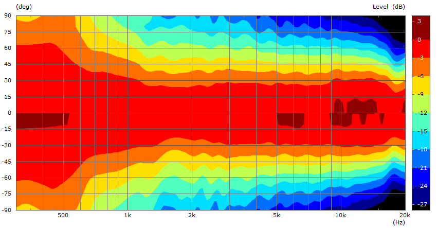

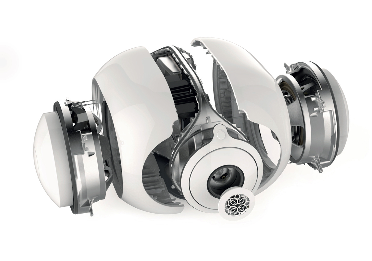

The SEAS DXT waveguide and opposing bass drivers in the Kii speaker are not really directivity controlling system. However the Kii 3 has quite nicely smooth but low directivity characteristics. The specific thing happens in upper bass at 60¤ (some phase cancellation?) KEF Blade and Devialet Phantom have similar construction. but with coaxial mid-tweeter.
Those speakers are not controlled directivity however.
Of course they are. In the upper bass to lower midrange the DSP creates a cardoid which controls directivity. In the midrange the baffle does it and in the highs the small waveguide.
However it could be a bit better.
kii three horizontal:

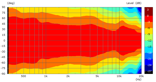

Just for comparison: here is a 12" + horn combination I build last year with a friend. Even in the low mids directivity index ist higher and overall more constant. It was a speaker we designed especially for in-wall usage in home theaters.
12" + 1" (on Limmer 022):
attachment.php
Beside "constness" I find the value of DI to be very important. The kii three radiates wide in comparison to typical horn systems. This fact makes it more sensitive to rooms with high reverberation times. Personally I prefer a higher DI.
