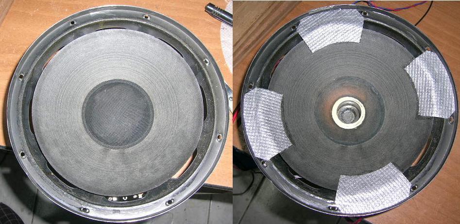

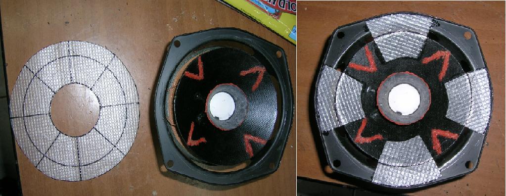

I didn’t have some 20$ to buy (it didn’t worth the cost for these speakers anyway) some descent surrounds, so I experimented with an old idea.
Four strips of some packaging plastic sheet, glued radially on the cone. They leave a vent area around the cone edges, which can serve as the bass reflex vent area. It works particularly well for bass-midrange drivers.
(For the strips, you can use some thicker cloth or some leather instead).
It is important that, before you apply the new surround to have the cone radially centered and held away from it’s axial rest position .
To do this, remove the dust cup and insert some photographic film strips between the center magnet pole and the coil former, pushing the cone in.
Make sure it remains at this position for the rest of the job.
Then glue the four surround strips at the speakers basket.
After the glue has cured, you can glue the strips on the cone. After you are done, remove the centering film strips from the coil former and reapply the dust cup (or place a phase plug over the center pole).

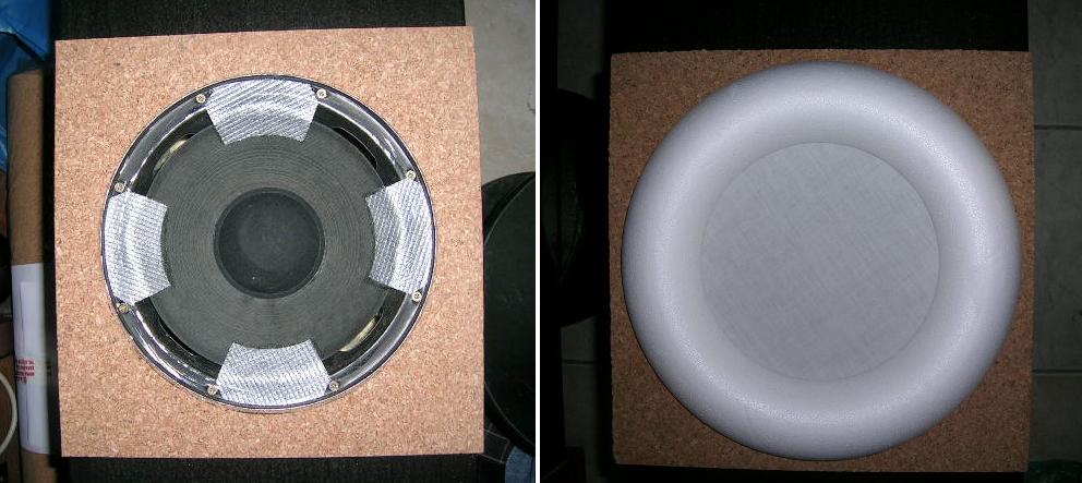

On the 8 inch Philips woofer you see on the photo, I applied a decorative touch to hide the ugly looking mod, by placing a half polystyrene donnut over the speaker.
It had the added benefit of acoustically loading the cone, as the donnut’s inner diameter was a bit smaller than the cone’s outer diameter.
