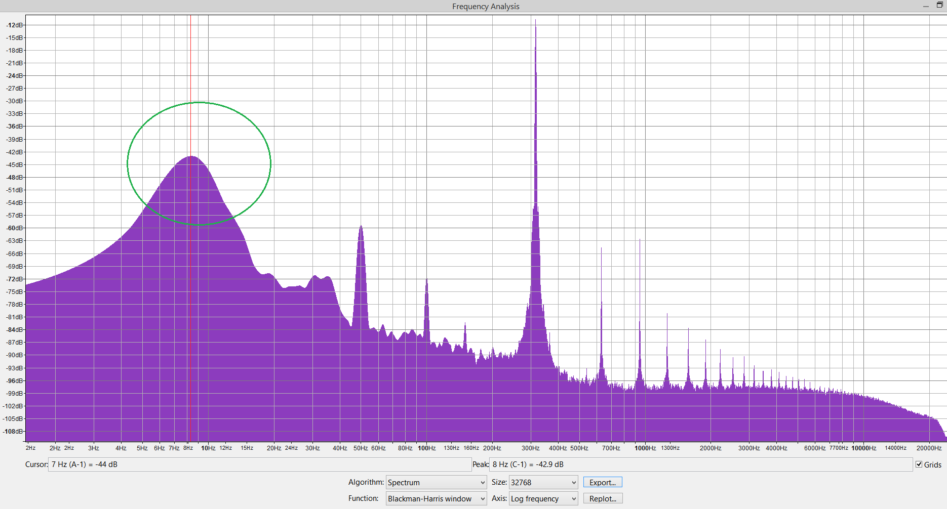

But a simple, -6dB/oct 20Hz high pass would not help much with a typical peak near 10Hz. It is ineffective. DSP is the best tool.

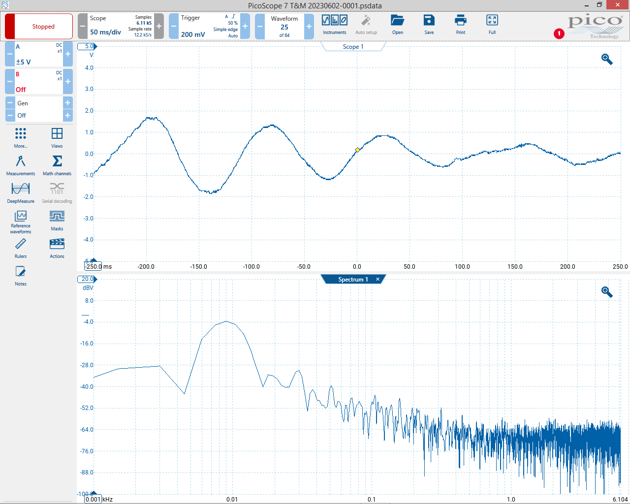

It looks to me like your subsonic hump is rather larger than the 5 dB to 10 dB of Nick. That's also consistent with the rather long ringing in your time domain plots.

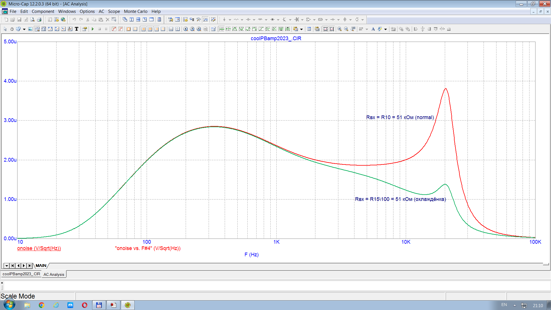

Yes, I know (you sent me pdf files a few years ago). And your active cooling phono pre as well as Bohumil Sýkora`s and later D.Self were used for MM phono preamp, where -20 dB FR @ 20kHz significantly reduces the effect of cold resistance. But it is much more effective in tape playback amps with a more elevated high frequency response, see circiut in MC12 here https://www.patreon.com/posts/usilitel-s-uv-80024956 [ and attched file, red line normal, green - with active cooling ], up to 5...6 dBA vs approx. 2 dB in MM preamp.Percival thought his electrically cold resistance was mostly of academic interest

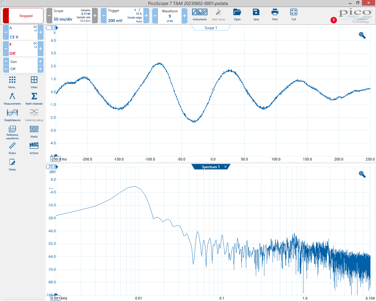

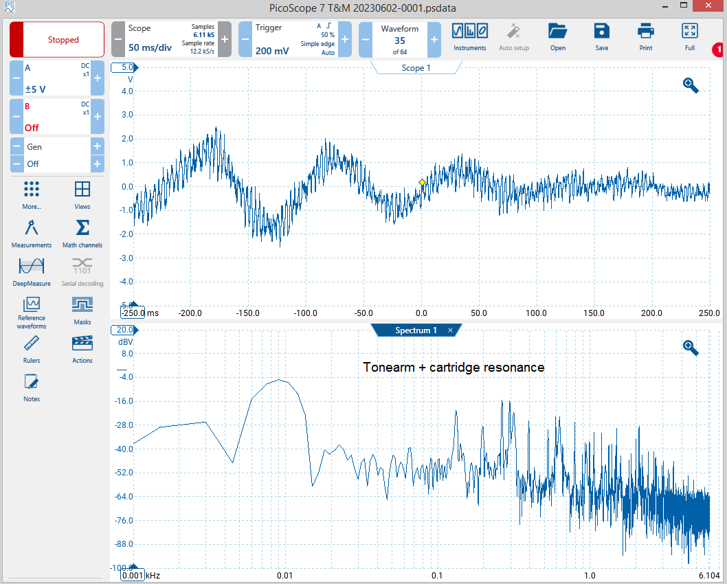

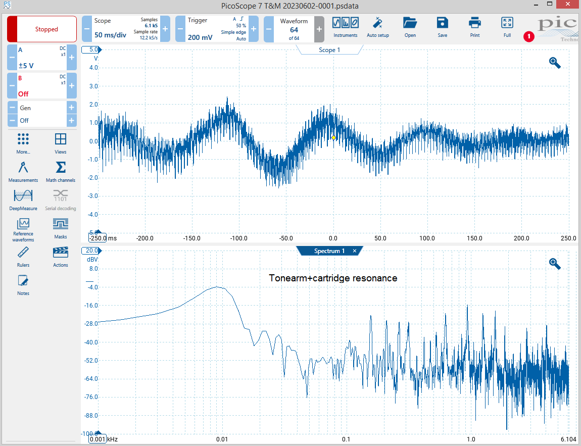

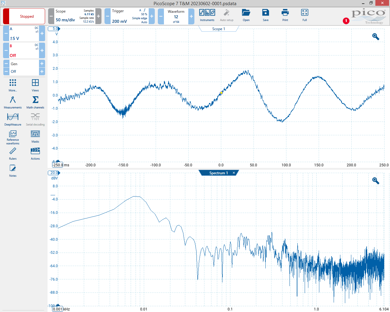

Pavel, can you clarify in your very interesting screenshots what tonearm and cartridge were in each picture?The nature of issue is not the steady state one, so the transient response of such filter is better not to imagine.
View attachment 1434587 View attachment 1434588 View attachment 1434589 View attachment 1434590 View attachment 1434591
Nikolai, the tonearm would be that of Technics SL-1200MK2 and the cartridge Ortofon 2M blue.
