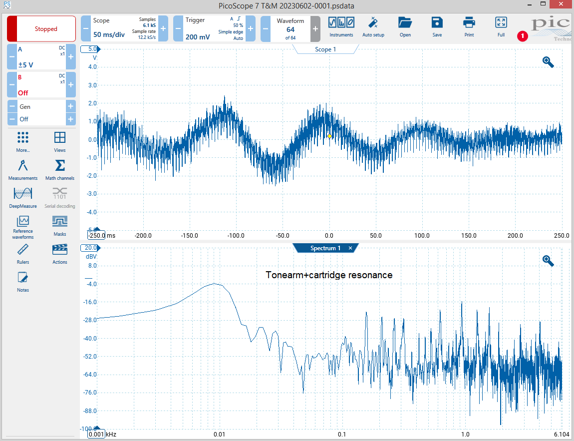

I like Marcel`s "one opamp phono preamp" with 3d-order rumble HPF @input , I did something similar in April 1979 [ https://archive.radio.ru/web/1979/04/062/ ], but I do not like its noise penalty and relative complexity. imho simplest 1st order 7950 RC is enough for tonearm antiresonance, and also to comply with the requirements of the active IEC 60098 standard
