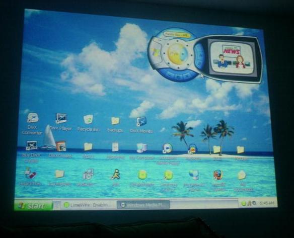

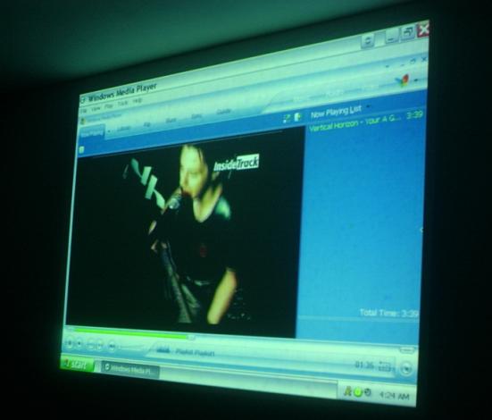

I used watered toilet paper on 15" benq 557 v2.
It came off easily, I used craft knife to peel the corner.
The image has better contrast and brightness.
Attached image is better in real life, colors are deeper. I took this pic with canon a60, 1/5sec, 100iso, f2.8.

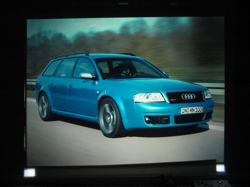

the purpose of the gallery is to capture results that more closely resemble what you have on screen.
For example, In the images youve posted, Ive noticed some really extreme dark corners, are your corners that dark to the human eye, perhaps you dont have everything alligned.
I try to take my images, to portray what I see in person
You mean my pictures of a white screen? Yes, the corners are that dark, but you don't realize that when you look at the big screen. If you would move much further back, so the screen would cover only small part of your entile field of view, you would see it clearly. You can't align anything to get rid of the dark corners, and you can calculate how much darker the corners would be in an ideal case, with everyting perfectly aligned. I don't remember the numbers now, but it's something like 2x difference in brightness in the center and in the corners. This is a "feature" of such projectors with a relatively big LCD and short throw distance. Don't be jealous, your projector also has it 🙂

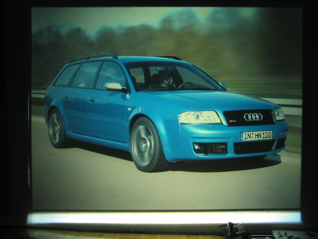

If youve read any of my replies, I have stated that we all have dark corners, but my corners are NOT as dark, nor taper off as extreme as your pictures indicate.
Thats what Ive been trying to say, the wider aperature setting of the camera lens, lets me recreate the accuracy of the corners not being darker in my pictures as they are in person.
In the beginning, with my old camera I had to take images 20-25 feet back in order to not get the severly dimmed corners, If you look at post 55, you will see the corners are dimmer, but not as EXTREME as yours are.
My newer Sony Camera, allows for me to get CLOSER to the screen, with the bigger aperature setting, thus no being effected by dim corners as much.

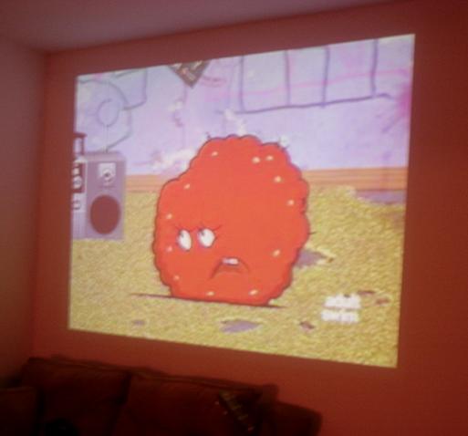

So I got brave this weekend and tried the A/G removal. Here are some pics of the process:
I used plain old paper towels and wet them in the sink until they dripped when I held them in the air. I did cover the towels in plastic wrap to hold in moisture (not shown in pic).
This is what the LCD looks like with no A/G filter; strikingly similar to a "glossy" LCD.
The A/G filter held up in the air. Holding it in the air is a little exaggeration because when it's actually being used it's glued directly to the LCD; not floating 3 feet in front of it.
So I did a little better comparison of A/G vs no A/G. The A/G filter is laid flat on the table. This one is with a flash. You can see the right side (A/G filter side) is more dull, dimmer, and slightly blurred.
This is the same setup with no flash (the light is overhead lighting).
So what do I think? Well, the image is definitely clearer. Sharper, more contrast, a little brighter too. How much more? Well, enough to notice but not night and day. Was it worth it? I think so. It really wasn't hard at all. Soaked it for about 6 hours. Then, used my thumbnail to get an edge started. Peeled right off with no problems. The most difficult part was not breaking the EXTREMELY delicate ribbon cables connecting the LCD to the controller board. That scared me way more than the actually stripping did.
