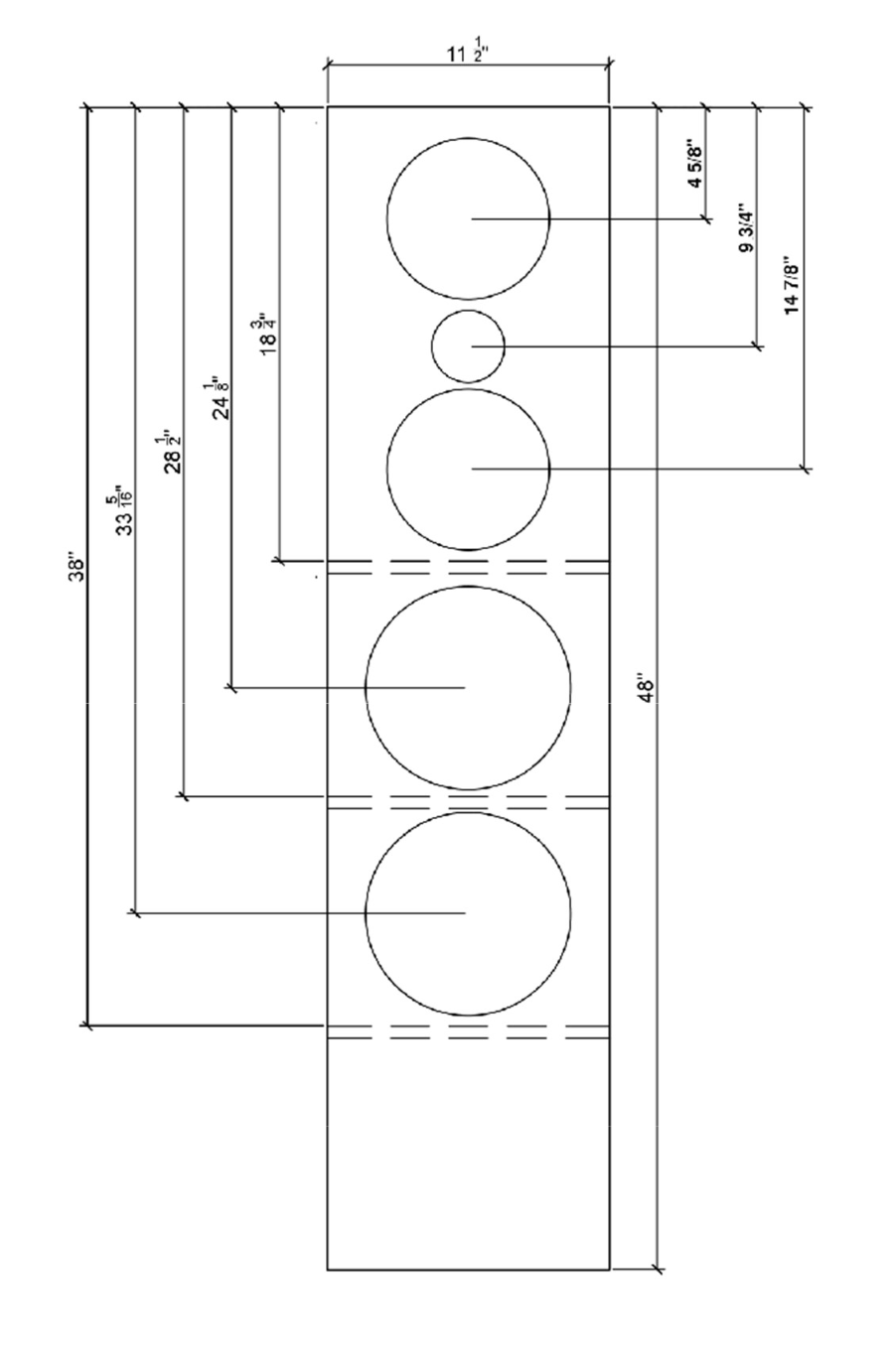

As to the original question i would build with quality plywood (i expect 15mm would be fine), but i would fix the bracing which is not well done.
This study leads to this general rule: the subpanels produced by adding a brace should have a higher aspect ratio than the panel being braced. Corallary: do not space the braces evenly.
In the anthology as better box could be done by orienting the braces vertically. I also like to brace the drivers to the back of the box (at least the woofers). This distributes driver vibrational rective energy to way more box maning the vibrational box load for any unit volume of box material to be less.
The construction seen is common and not nearly as effective as it could be.

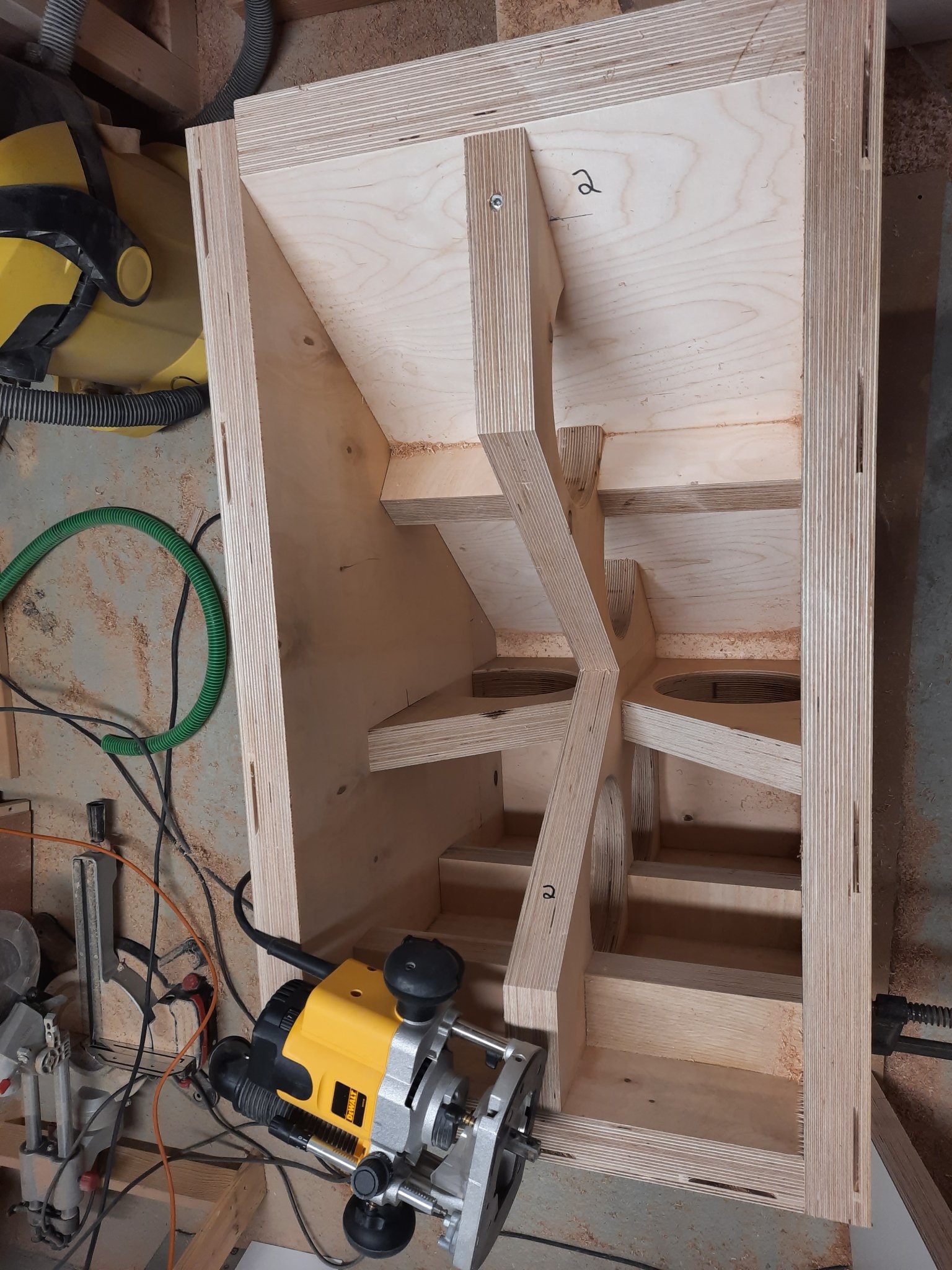

Here in the photo you can see a good quality 47mm birch plywood
