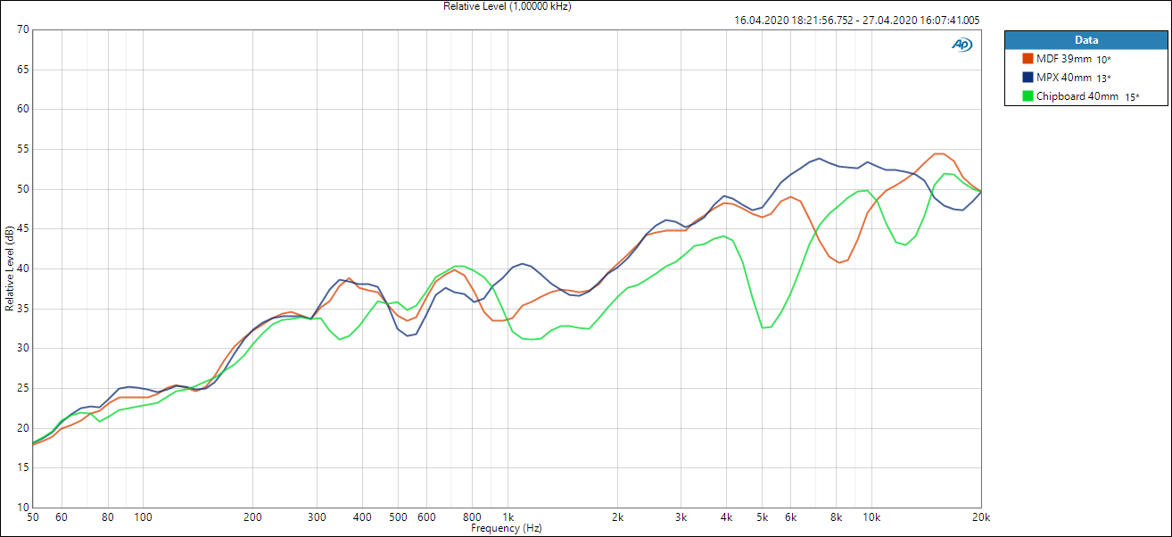

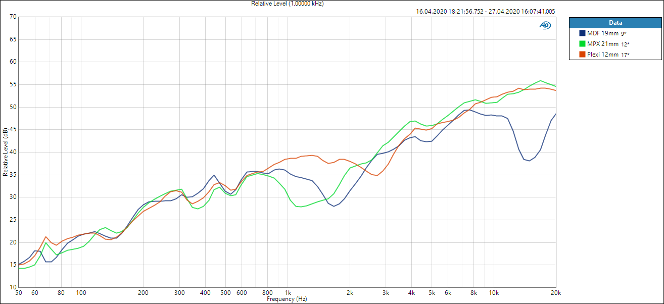

The old wood material game ... I actually measured it and the differences are surprisingly small:
