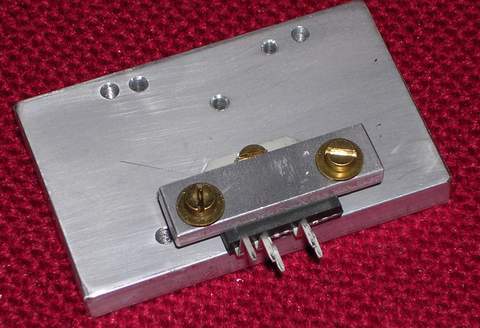

Glue
What I have done on a gainclone is bolting the chip to a block of alu 60 x 50 x 5 mm both tab and clamp, unisolated with silicone grease. Then the block was glued with thermal conducting, electrically isolating glue. I used locktite 315 from Farnell. Works fine.
Rick
