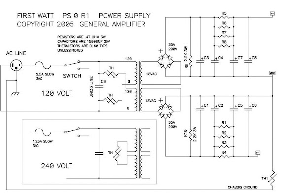

Guys,
I built mine same as on the first page of the NS datasheet. I used 100uf caps. I see people all over using 1000+uf and I dont get it. I have wonderful sound with really impressive bass. What am I missing here?
I dont know if my supply makes a difference here but its kind of massive for this. I am using this guy:
It has 144,000uf on it but I know its overkill, but could this be allowing me to get better bass since it always has a good steady stream of power no matter how small my CM and CS caps are?
Uriah
Uriah
If you are using 144,000 uF in your PSU then you can get away with less than 1000 uF on the pins of the chip. The people that you see using 1000 uF often don't have any other capacitors in the PSU! 😉
and the resulting amp is incapable of properly reproducing frequencies below 160Hz or so.Nuuk said:The people that you see using 1000 uF often don't have any other capacitors in the PSU! 😉
But reputedly great for mids and tops.
Expect to see an argument on this, but at least go back and search for other views.
Above a low power threshold, adn above that, you will get LF IMD from the PSU.
Owen
