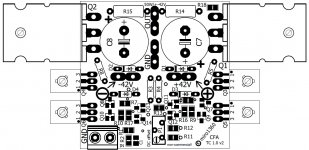

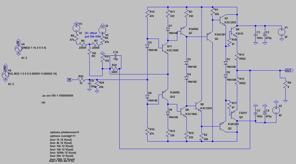

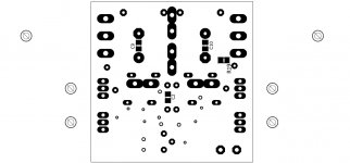

TC 1.0 v2
small update: TC_1.0_v2
- version with bigger output transistors 30MHz (FJL4215/FJL4315)
- improvement in few values (resistors for input transistors, VAS resistors)
- PCB remained small, in cheap size 5x5cm (gerbers included)
... sound is excellent

it all depends on your preferences
if R5/R8=22k == cca. 15mA each output transistor (+-42V)
you can modify it with own preferences, if you need trimer and thermal stability than instead of D1/D2 you can add vbe multiplier, or you can place D1/D2 on heatsink (or use transistors with diode - like NJL3281D/NJL1302D)

Just a classic CFA with a transistor used as a diode to equal DV voltages between input and feedback input ?What about this CFA concept from THS3001?
http://www.ti.com/lit/ds/symlink/ths3001.pdf
And what about input impedance ?
Is seems to me that Diamond do the same, adding some other advantages like gain in the input stage ...
- input impedance is not big, I think about 150k?
- if diamond is doing the same, I dont know ... note that I am not a pro-designer, I am doing it just for fun ... and for sound impression 😀 😀 ... some pro designs were for me boring or disturbing in sound impression (with diamond), and this amateur thing kicked their *** ...
And what about linearity?
On my opinion (and, like you, I'm as much involved in the subjective sound qualities than pure technical results), it is a pity to loose the gain that can bring a transistor, using-it as a diode.
Diamonds will give-you a big amount of current gain, and isolate the input.
They, sometimes, are prone to very high frequencies ringing. You can cure-it, adding a resistance in serial to the base of the second stage as i showed. And, adding a capacitance to ground after this resistance, fix an input filter which will be independent from the source's impedance. This will ensure you will never overdrive the amp in speed (TIM) while keeping a very high slew rate. A tip: fix your Miller cap for no ringing at high levels, then this filter for no ringing with little signals. This will be the minimum value of the input filter. And the first stage of the diamond is out of the feedback loop.
An other tip, fix your Miller cap between the output of the amp and the base of your gain stage, instead of between its base and collector. You will decrease distortion, as the output stage has no problem to deliver as much current to charge this capacitance at HF than needed. Not the case at the collector.
The problem with the simple diode, is that they don't exactly follow the voltage drop of the transistor. So, you add a risk of DC at the output, or ask too much from a servo. The original solution was better, I thinkWith your point about diodes was possible to simplify this design even more 😀 😀 thanks for that 😀

About Diamond: Your capacitance at input is not at the good place: charging the preamp that you don't know how he behave with a capacitance load.
See my quick'n dirty image.
Well, you'll have to reconsider too your compensation. Paralleling a cap with the feedback resistance is not recommended with current feedback amps.
And last, i thing the impedance of your feedback bridge is too high in front of the parasitic capacitance of Q9 Q10: you will loose bandwidth and add distortion.. Try something like 500 Ohms with ~23 Ohms as the feedback bridge ?
I changed these values ... except feedback resistors, because with 500/23 it goes into oscillation 😀
cap in feedback with CFA amp is questionable, you can find right value with square simulation (bad/too big value can increase possibility of oscillation, too small value can do the same, right value can help) 😀
here is ltspice file if you like to simulate ...
