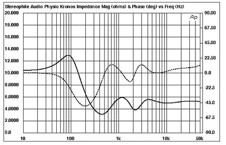

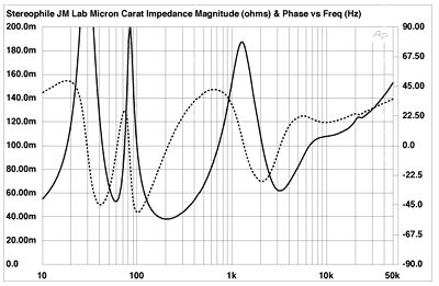

The only explanation that I have for this is the consistent phase response of the Unity and Synergy horns. The phase response of the SH50 follows a gentle slope, whereas a traditional two-way has a phase response which shifts dramatically.
I couldn't find a phase plot of the Summa anywhere; as it is a traditional two-way I expect it would have a phase response which is similar to a typical two way, like this. In the plot below, we see that the phase jumps around quite a bit. It's interesting to note that the biggest phase shift happens in the midrange, where it's most audible. If I'm doing my math correctly, the phase shift would be virtually equivalent to the speaker being moved 4.5 inches as the phase shifts sixty degrees from 2khz to 500hz. Then it shifts *again*, in the next octave.
Now compare the phase plot above to the phase plot from a coaxial. This is an Audio Physics Kronos:
I would kill for a phase plot of the Gallo A'Divas, as that would let me make an educated guess about the phase response of a full-range system versus a Unity / Synergy horn.
Long story short - I'm guessing that a lot of the "Unity Magic" is due to it's phase response.
It's a bit amusing that the guys at Stereophile had the same reactions to an Audio Physics coaxial that I had to the Unity. Here's what they had to say about listening to a Johnny Cash song:

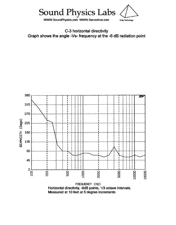

Anyway, FWIW, here's an F6 polar map of the SD/SPL's C^3, an early pro version of the Unity:
GM

Beam width plots are not of much use to me. They are way way to coarse to tell anything important.

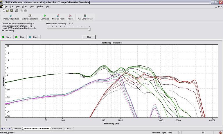

I'd be very interested in your measurements. Tom was supposed to supply me with some but he never did. I'd really like raw data if possible since then I can do what I want with it. Any possibility in that?
I don't know how to get at the raw data, but if I did, I would want to take better measurements. I just did a quicky with these to get an idea of the polar resonse for playing with crossover points. You can see a fair amount of reflections in the midbass respone, due to the windowing and floor reflections. I can try to play with that a bit. But the relative polar response should be good enough to get a general idea.
The curves should be pretty self explanatory as to which is which. The mids are basically a bandpass alignment. The widest angle is 52 degrees and goes down in 7.5 degree increments from there.
Sheldon
John,
Other than the image height being a little different, I don't notice too much else. The full Unity set seems to have a little more perceived "richness", but at least to my ears it's fairly subtle - not day and night. And I'm not generally very suggestible, but still it could be just my imagination. I've only done a sort of quick check. I'd want to try a variety of music to make any further assesment. Now, I'm using 96dB digital filters, so that may play into it. Certainly, in either case, all the dynamics are there, imaging is good and nothing seems missing.
Sheldon
Sheldon
I was reacting to your earlier statement
"If I take polar measurements of the horn and mid bass, I get something that looks very much like those on the Gedlee site. "
I guess that I don't see where this comment comes from. I might say that there are similarities, but I wouldn't say that they "look very much" alike.

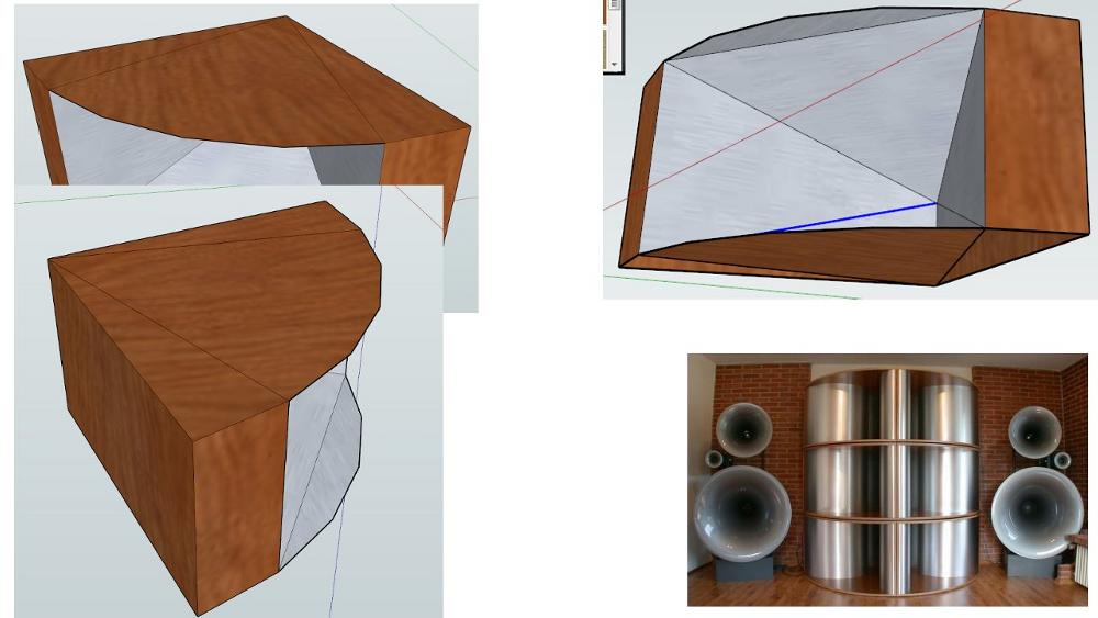

So I took out the tape measure, and tried to figure out how on earth I could make a horn with a 30in mouth that wouldn't make my entire house look like hell.
That was the mistake I made when I put the Unity in my car. It was SO UGLY. One of my friends said that it looked like I had "a car bomb on my dash."
People would walk by my car and do double takes! As in "what the hell IS THAT?"
I think that Jadis and Avantgarde do a good job of making big horns look acceptable. I fired up google Sketchup and created a 60 degree by 40 degree conical horn with a 30" wide mouth. The key is that I made it look like one of the Avant Garde subwoofers, which are quite handsome. The conical horn fits nicely inside of the circular enclosure, and keeps it from looking too weird. I slapped this together in less than an hour, so it's not pretty (see attached.)
