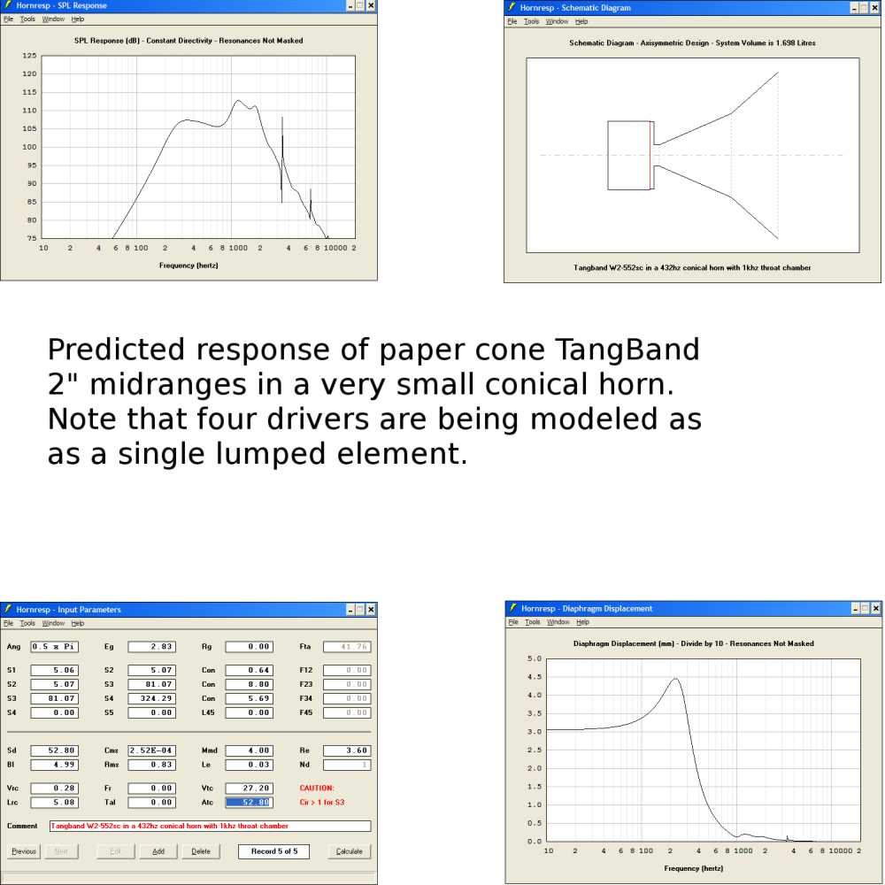

Patrick Bateman said:Using the same midrange from my posts above, I optimized the chamber volume and diameter to some extent. Then I varied the depth of the holes, and took screen caps.
In the attached pic, you can see the depth of the holes has barely any effect on the response, until they get dramatically long (like I was using.)
I spent some more time trying to optimize the holes.
In my last unity, i had a peak and a huuuuge null in the midranges. If anyone's curious, I can explain what I did wrong there. I figured it out yesterday, but haven't posted it yet.
Nonetheless, take a look at the attached pic, where I've tried to optimize the enclosure for the Tangbands. It looks like the peak is caused by using a compression ratio which is too agressive. When the throat (aka the holes) is big, the peak is reduced. Of course as the throat gets bigger, it begins to screw with the response of the compression driver.
I'm thinking it may be possible to have a relatively large peak in the midrange response, then null it out by placing the holes one quarter wavelength from the apex of the horn.

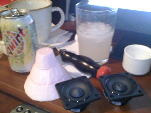

Alright, it took almost two hours, but I've finished the mold.
First thing you'll notice is that it's stupid small. No joke, it's smaller than a soda can.
When I make a Unity, I make it SMALL.
This one is going right back in my Accord, just like the last one.
Don't give up on this thread though; you can use this for a full size unity. All you have to do is extend the curve all the way to a 30 inch mouth.
I can get away with a dramatically tiny waveguide because I'm placing this in the corners of my dash, where the windshield and the driver's window extend the mouth out to the proper size.
Corner loading rules.
Check out the pix.

I've spent the better part of two hours trying to make an enclosure small enough for these TB mids.
Back in '06 I made the enclosures waaaay too big for my Aurasound mids.
This time around I'm carefully measuring the impedance curve to insure the enclosure is sized properly before I bolt anything to the waveguide.
Only problem is that you need a preposterously small enclosure.
First I tried a piece of 2" PVC pipe which is just big enough to contain the mid. That was far too big; the FB of the enclosure was much too low.
Then I found a 2" plastic sphere at a crafts store. If you cut it in half, it's big enough to contain the 2" midrange. That was better, but still too big.
Then I said phukit, and used clay to cover all the holes in the frame. When you do this, the mid is basically in a sealed enclosure defined by the air between the frame and cone.
That was a little too small, but a big improvement over the other two.
Attached is a pic.
As we speak I'm listening to the midrange play in this tiny enclosure, and it doesn't sound too bad. So this may be my best option.
I'll re-model it in hornresp and see how it looks.

No joke, I spent close to three weeks trying to find an enclosure for the midranges. I was using a plastic sphere which I purchased at a craft store about three years back. The sphere is 2" in diameter. For the life of me, I couldn't find any more! I tried other enclosures made from plumbing parts you can buy at Home Depot, and they just weren't as good.
After digging around for a few weeks, I found a craft store that still had them. Score! I even looked online and couldn't find these.
